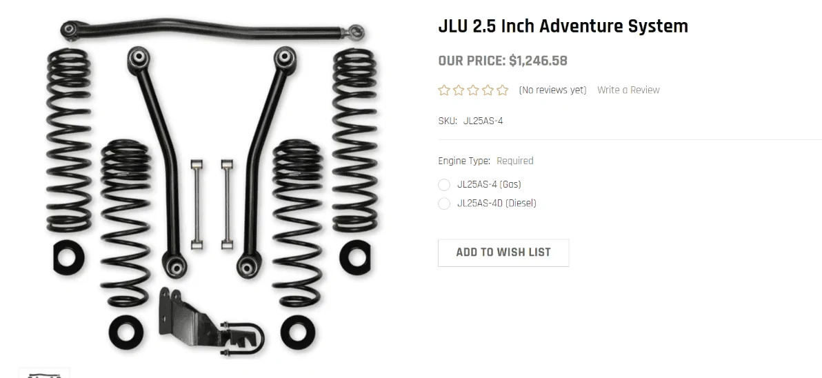

This one, along with fox 2.0 shocks
With that kit you shouldn’t need an alignment. The control arms are fixed( non adjustable) and the front track bar is used to center the axles, the rear relocation bracket is plug and play, so there’s really nothing they need to align so you could save yourself the 88..00.
Interesting. Thanks for the advice! $88 bucks doesn't break the bank but I'm also happy to not spend money that doesn't have to be spent. I'm sure I can find another way to blow $88 bucks on the Jeep lol.
