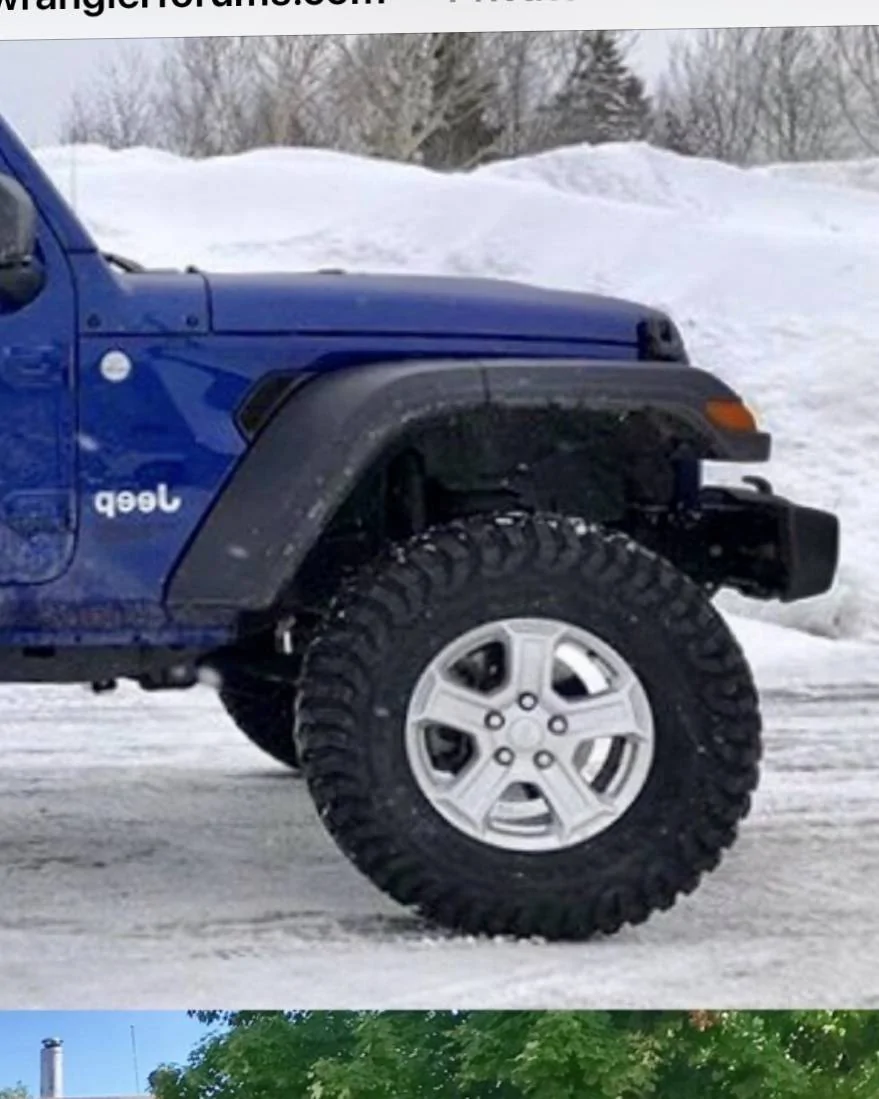

You didn’t make a bad purchase. I agree with these guys about setting caster with ucas, however the best way I found is to use both adjustables. But if you can’t do both, I use lowers. If you’re on stock lowers, and you use uppers to get caster set around 6 then it pulls the wheel back in the wheel well which I hate the look of. Some guys don’t care , some don’t see it, but I do this shit a lot so it’s easy for me to see....... but anyway..... you’re going to be fine if you have to lengthen your lowers more than 24.25....just my opinion......
