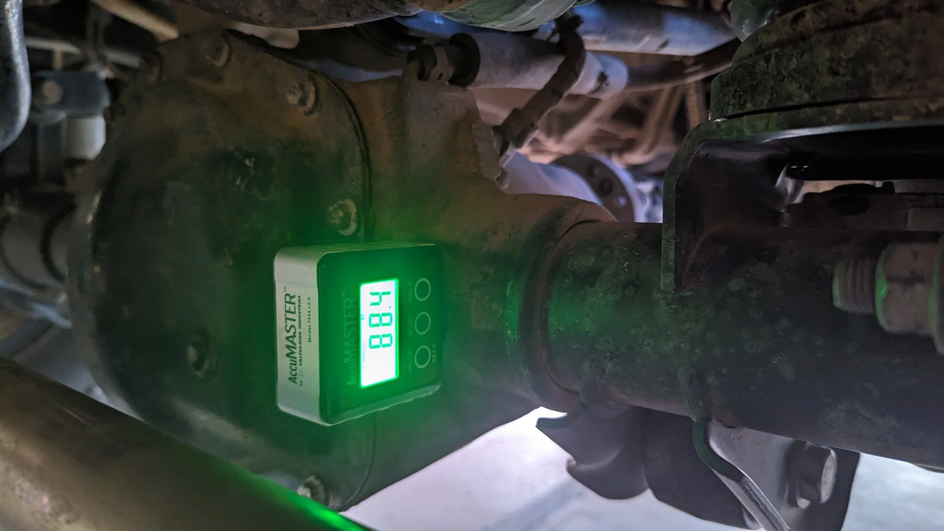

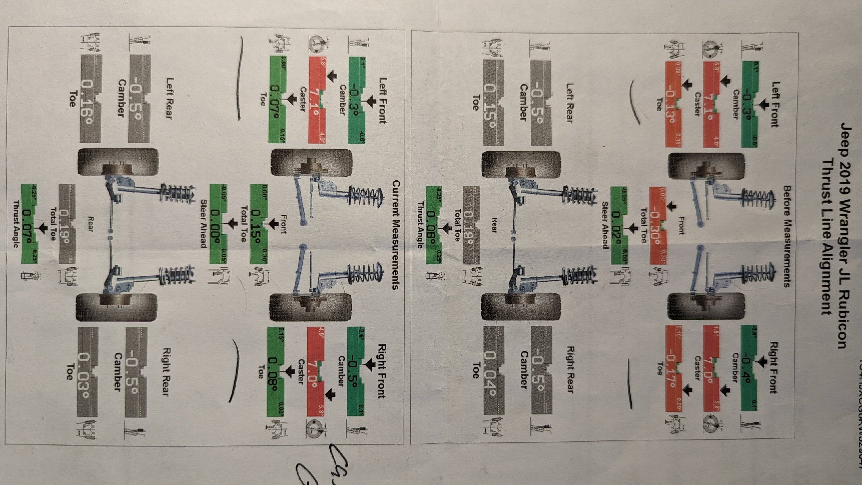

Attached is the alignment after doing my lift. And a picture I took earlier this week of the angle at the front diff, after installing the tie rod, drag link and ball joints.
According to my alignment I am at 7 degrees caster. And that pretty much jives with what the angle finder shows. Though according to my calculations based on the angle finder I am at 7.6 degrees.
Should I try to remove some of the caster to get to more like 6 degrees? Beyond adjusting caster, I don't know what else to look at since everything in the suspension and steering are so new.
If you are at 7.6 on caster you really need to dial it back.
When you air down it increases the length of your wheelbase. Adding taller tires increases the wheelbase and then airing down, no doubt you have 7.6 which is way to much. I would dial in a 6.5 and see what that does for you.

7.6° is too much caster for a factory axle housing. Anything beyond 6° gives you a pinion angle pointing towards the ground. It can be done on a custom or aftermarket axle, but not on factory without having a very awkward driveshaft angle. That said, it shouldn’t be a cause for DW.
I run 6°, and am very pleased with steering feel (stiffer), faster return to center, and no wandering like the JL did since new.

I also suspect the toe could be out of adjustment. So I'll look into going 1/8" toe-in. And I'll dial back that caster to 6-ish.
