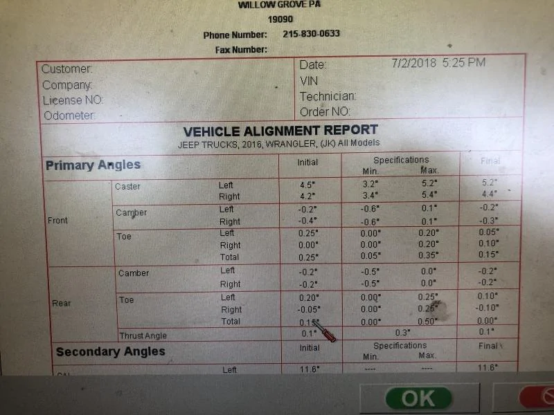

Hi all,
After installing my RC 2.5 suspension lift, with shocks and springs, the Jeep pulled to the right a little. Today I had an alignment done, and it seems to mostly be solved. My question is, does it matter that it says 2016 JK? Are the JL and JK close enough to not matter?
The printer was broken, so all I got was this picture from the machine.
