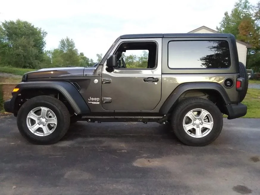

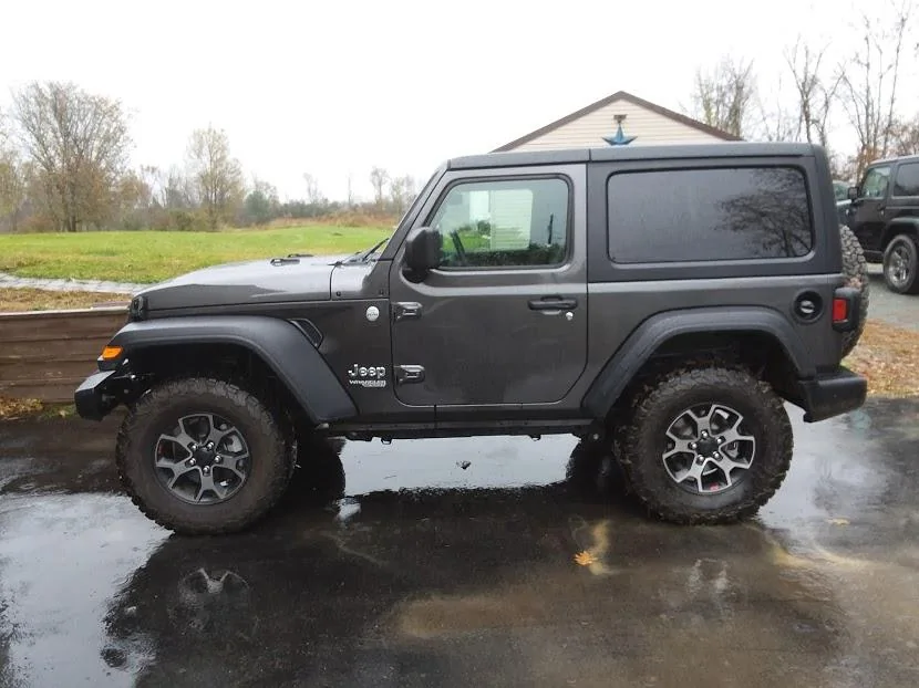

Swapping on the springs and shocks from a Rubicon is a great economical upgrade. If you use parts from a 4dr on a 2dr, the springs are a little stiffer. They come up for sale here on the forums quite a bit and you may even find them locally on FB Marketplace. You can probably find the wheels / tires / suspension for $1,000-$1,500 depending on your location (the suspensions alone usually go for $200-$300). I got about 1-1/2" of lift from the springs and about another 1" for the Rubicon wheel/tire takeoffs. The ride was a bit stiffer than stock, but still quite acceptable.
