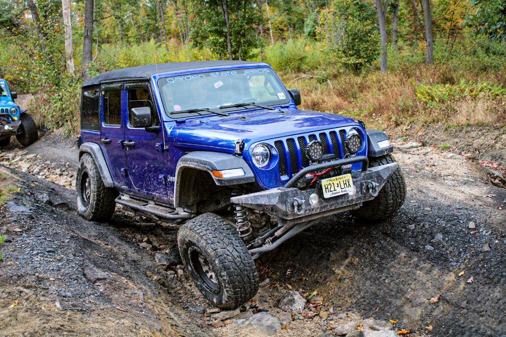

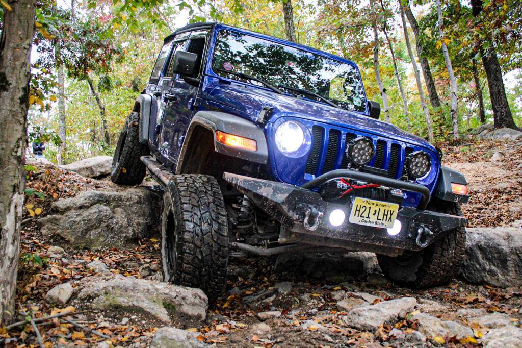

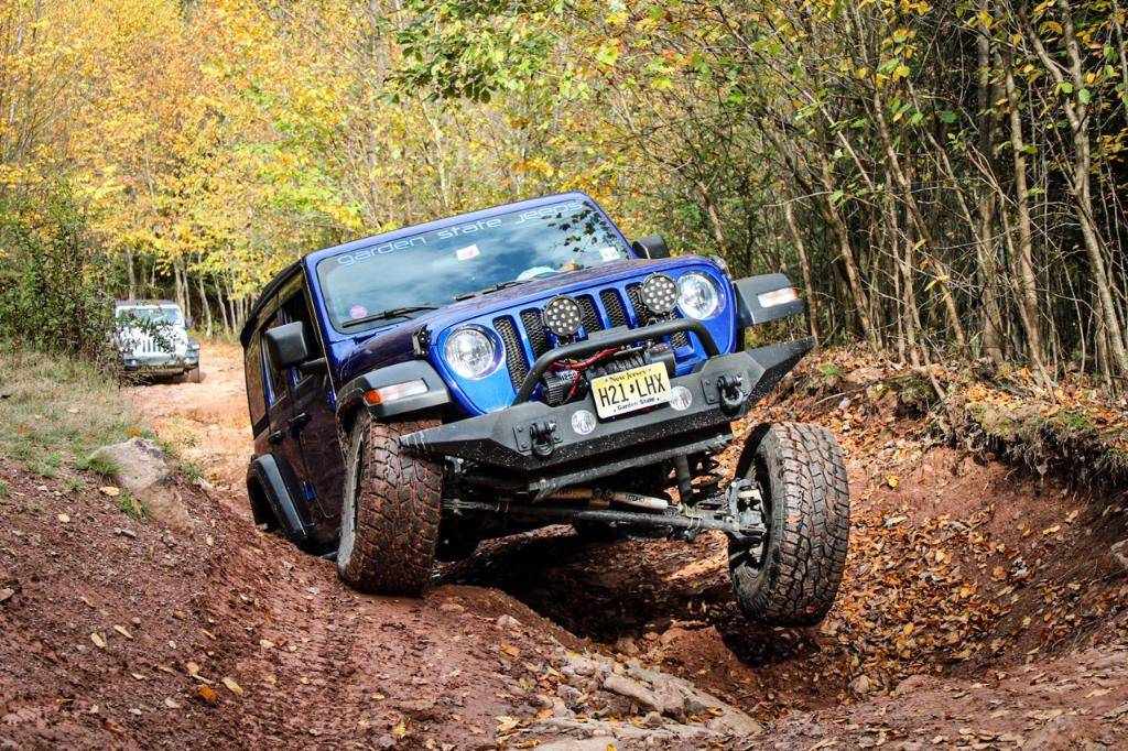

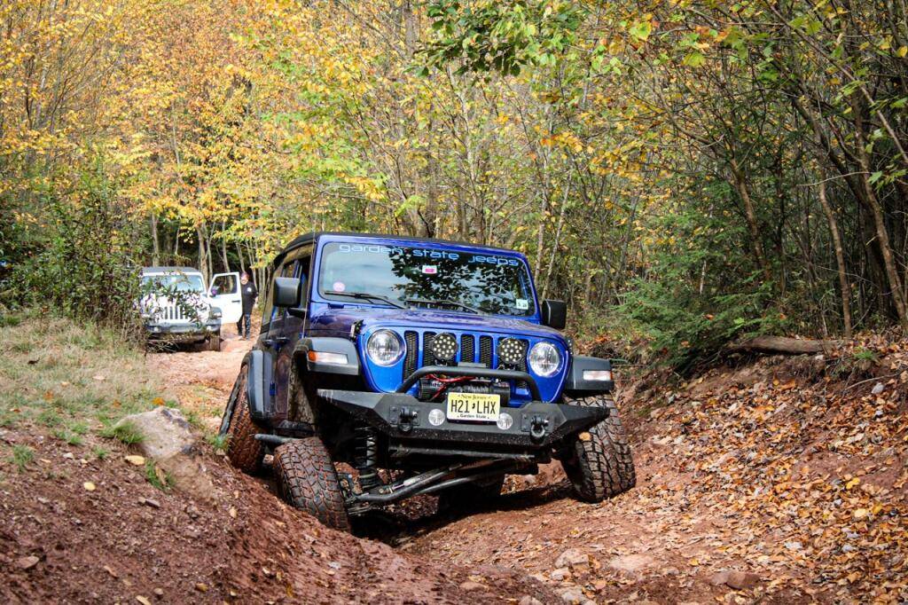

Depending what kind of off roading you plan on you could look into a spacer lift. I run a 2.5” RC budget boost with 35”s on my 19 sport. I’m still running stock gearing but I do have the M220 rear. Only thing I did was bought shocks for a 2.5” lift instead of running shock extensions. I run blue rated trails at Raush creek and AOAA in Pennsylvania and have done 3 BOH trails(trail 11, crawlers ridge and crawl daddy) with no issues on my setup. I don’t plan on running anything bigger than 35”s and the trails I run are about the max I’d
go.
