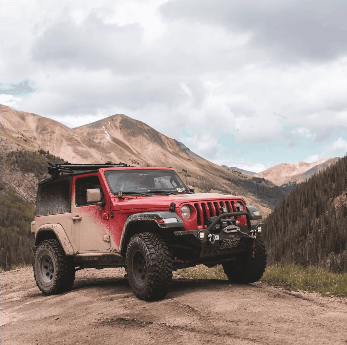

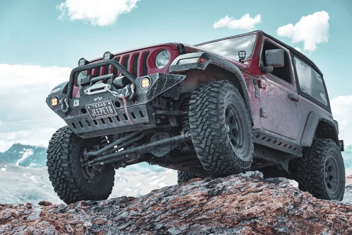

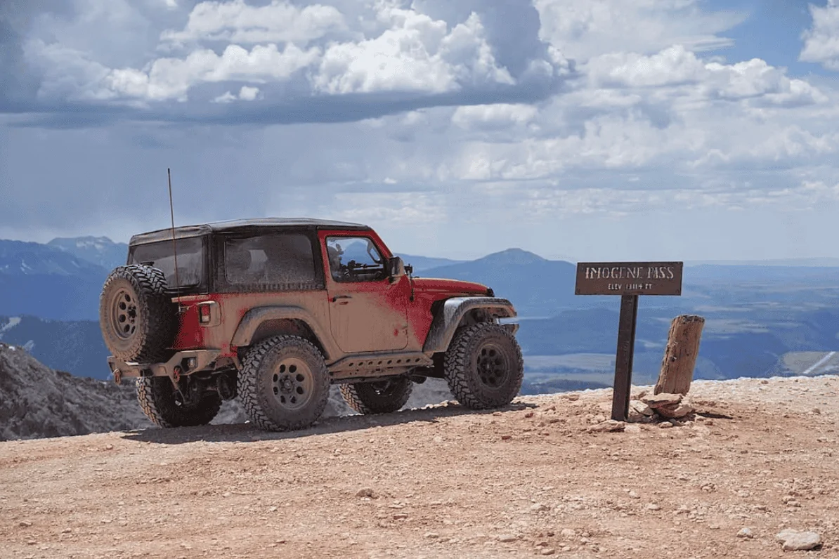

Sparky
Dynatrac Endurosport 2”
Fantastic lift at a fantastic price, fits 35s comes with Fox shocks, engineered by former jeep engineers, rides like factory, and can be installed by you in your driveway with minimal skills and tools. It got me everywhere I wanted to go with Jeepeto II.

Very nice. Do you recommend any vendors?
part number?

Northridge 4x4 is my go-to vendor. They’re a forum sponsor and they’ve been good to me. Use code “JLWRANGLERFORUM” if the item isn’t on sale it’s usually good for a bit off.
just search for “dynatrac endurosport 2” lift JL”
Also, with a 2” lift, will I need a steering stabilizer, any driveshaft modifications?
No further mods needed
