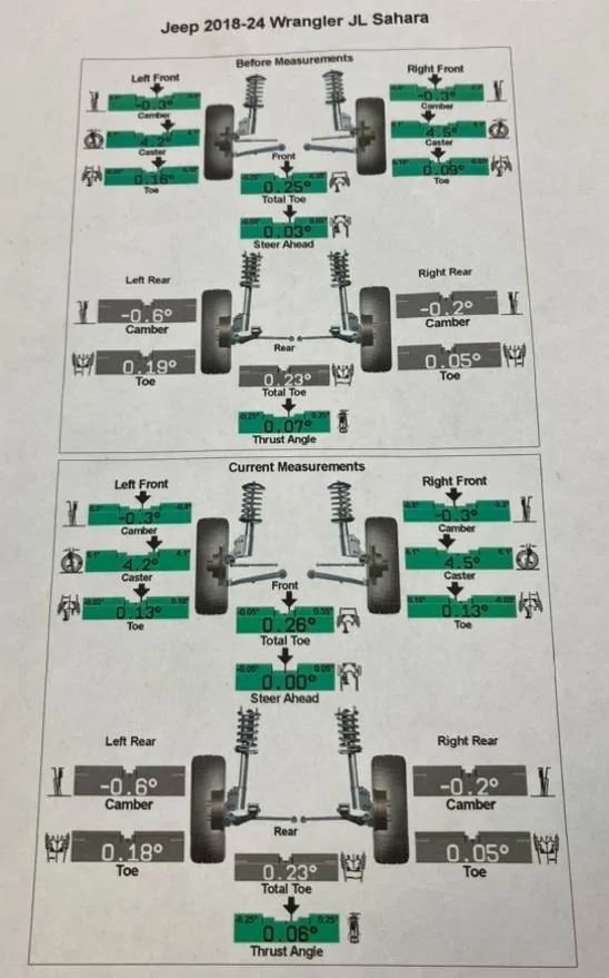

What do you mean by you "can't get it to align"?
DeBen21JL
Dennis
Aug 28, 2024
50
2021 Jeep Wrangler Sahara
they were not able to get it to stop pulling to the right. Were concerned the axle wasn’t aligned properly and the floating at speed was from insufficient caster.
4 degrees is pretty awful for caster. You can do that RC lift if that is what you are set on. You said that it includes adjustable control arms and trackbar, so you should be much better off after setup properly. RC stuff is known for poor quality, so buyer beware there. But other options would cost you more.

Regarding steering and alignment, get them to set your castor to at least 6 degrees. 4 degrees is way too low for Jeeps, especially after a lift. A lot of Jeeps come stock at around 4+ degrees, but this is too low to begin with. It’ll help straighten you out. 👍
