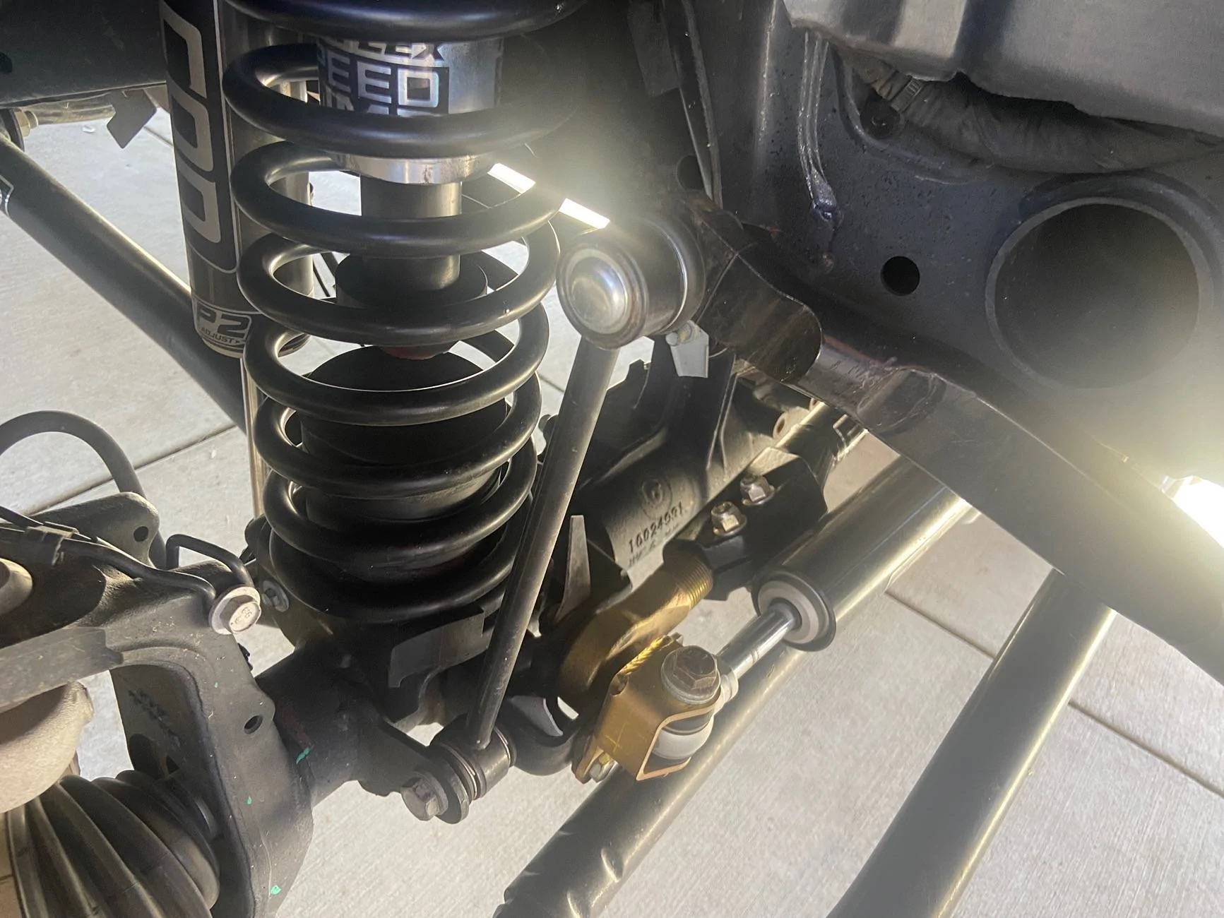

Geometry correction brackets are a pretty good option for your use case.
I wouldn't touch the RC ones since they are loose plate. JKS appears to be the best value option in this case. JKS is a solid manufacturer and is a part of the Fox Shocks family.
If you want to use a rear bracket, looks like Teraflex takes the bag.
I've used the RC track bars and they aren't awful. Personally I'd step up to Steersmarts, but RC is reasonable in this use case.
