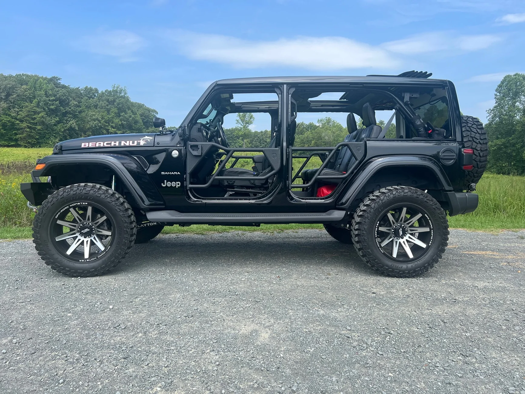

This is a Clayton 2.5” Overland kit, 5100 Bilstein shocks and 35” Cooper SST tires on my Sahara. I now have a Jeep that handles EXCELLENT on and off road. I HIGHLY RECOMMEND this kit. I’m 64 years old and installed it myself in my driveway…took it to my local off road shop and had an alignment done and had them go over the lift, checking for torque values. Definitely in your budget.
Jeep Wrangler JL Suspension Upgrade Advice Needed IMG_9060

I have no idea what happened to my post…🤪
2.5” Clayton Overland Kit, 5100 Bilstein shocks, 35” Cooper SSTs, 20” rims. Excellent handling on and off road.

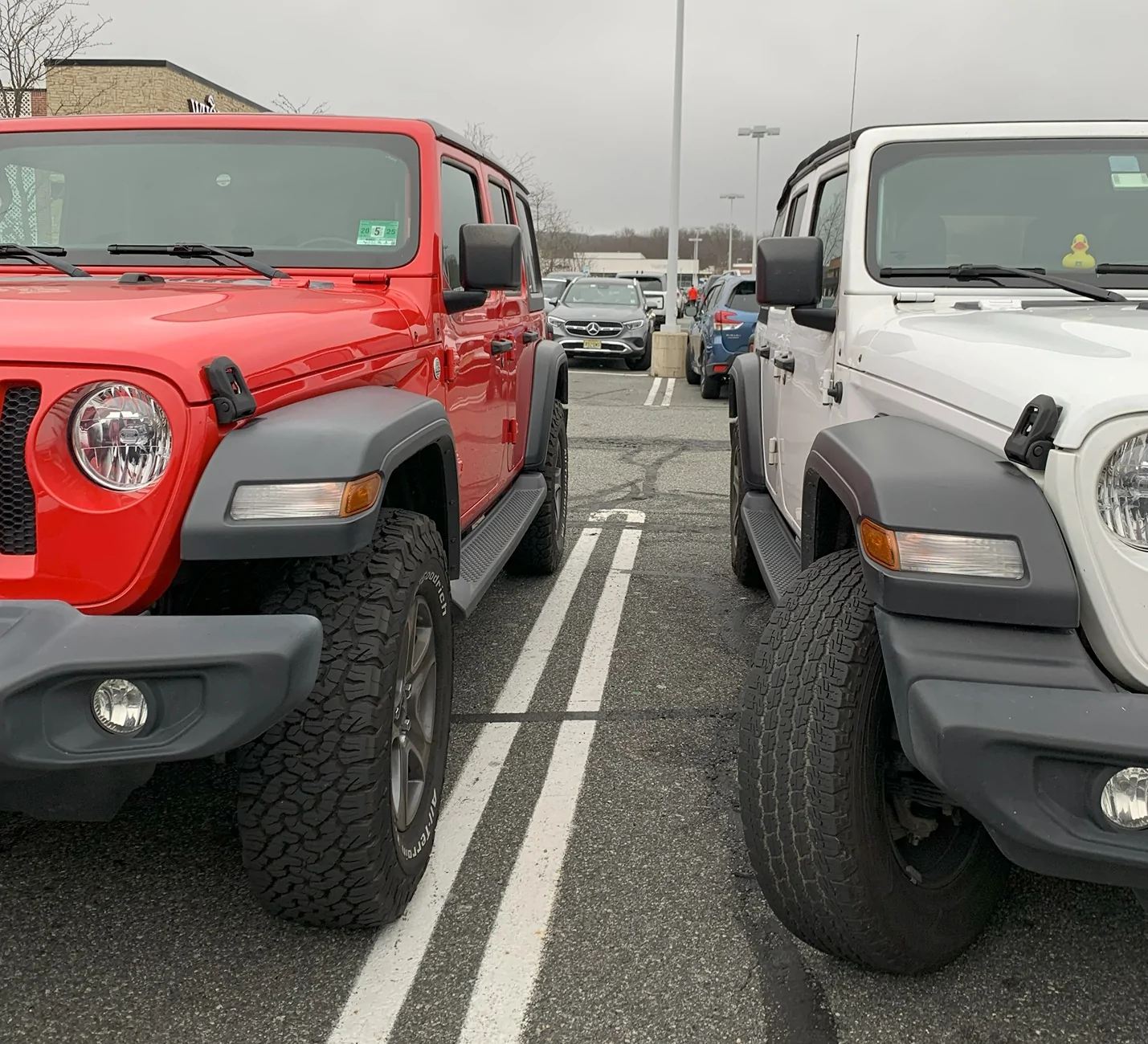

What's the max tire height you're looking to install? If you're planning to go to 33's, then Rubicon take-off springs/shocks will be all you need. Here's my wife's on 285/70 KO2s with Rubicon springs, parked next to a stock Sport. Note the difference in height at the mirrors.
Jeep Wrangler JL Suspension Upgrade Advice Needed IMG_6818
Jeep Wrangler JL Suspension Upgrade Advice Needed NewTires
If you want 35's, then you'll probably want an aftermarket lift; just know the advertised height of lift is based off a Rubicon. In other words, a 2.5" lift will probably net at least 3.5" on a Sport. If you have a garage height limitation, I'd measure some lifted JL's first before pulling the trigger on anything.

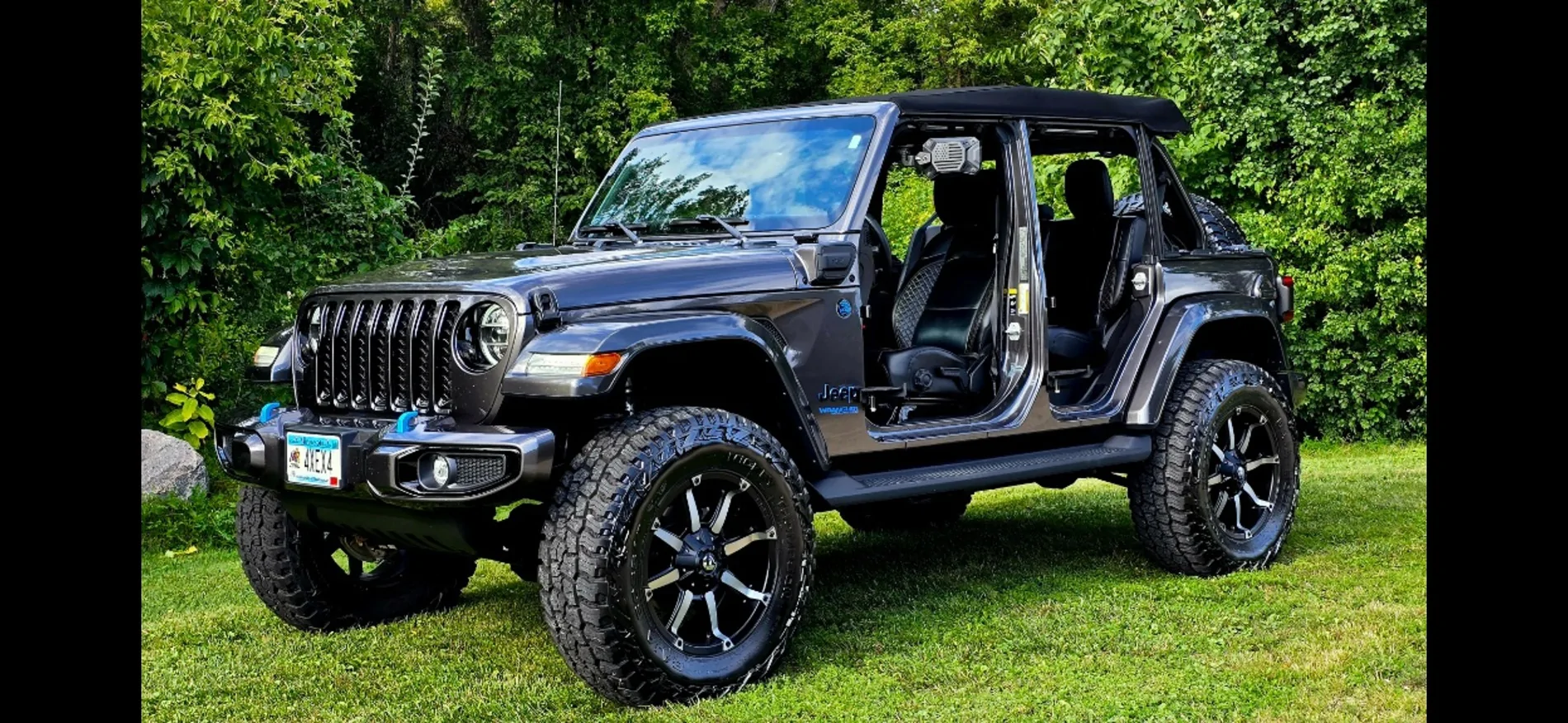

For reference, I’m running a Clayton 3.5" lift with Fox 2.0 shocks, 37" Baja Boss tires, and 20" Fuel wheels on my ’21 Sahara 4xe. My total height is around 76 inches with the soft top — the hard top sits about an inch lower.
I’ll admit I’m partial to Clayton since that’s what I’m running, but I can honestly say the drivability and on-road manners are excellent. I’ve called their support team a few times with random setup questions, and they’ve always been super helpful.
Jeep Wrangler JL Suspension Upgrade Advice Needed Screenshot_20251008_092131_Gallery

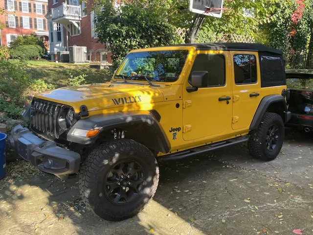

This is my 21 Willys. Clayton 1.5" springs, Fox 2.0 2-3" shocks, Mopar end links. Tires are 33" Falken Rubitrek.
Jeep Wrangler JL Suspension Upgrade Advice Needed IMG_3423
