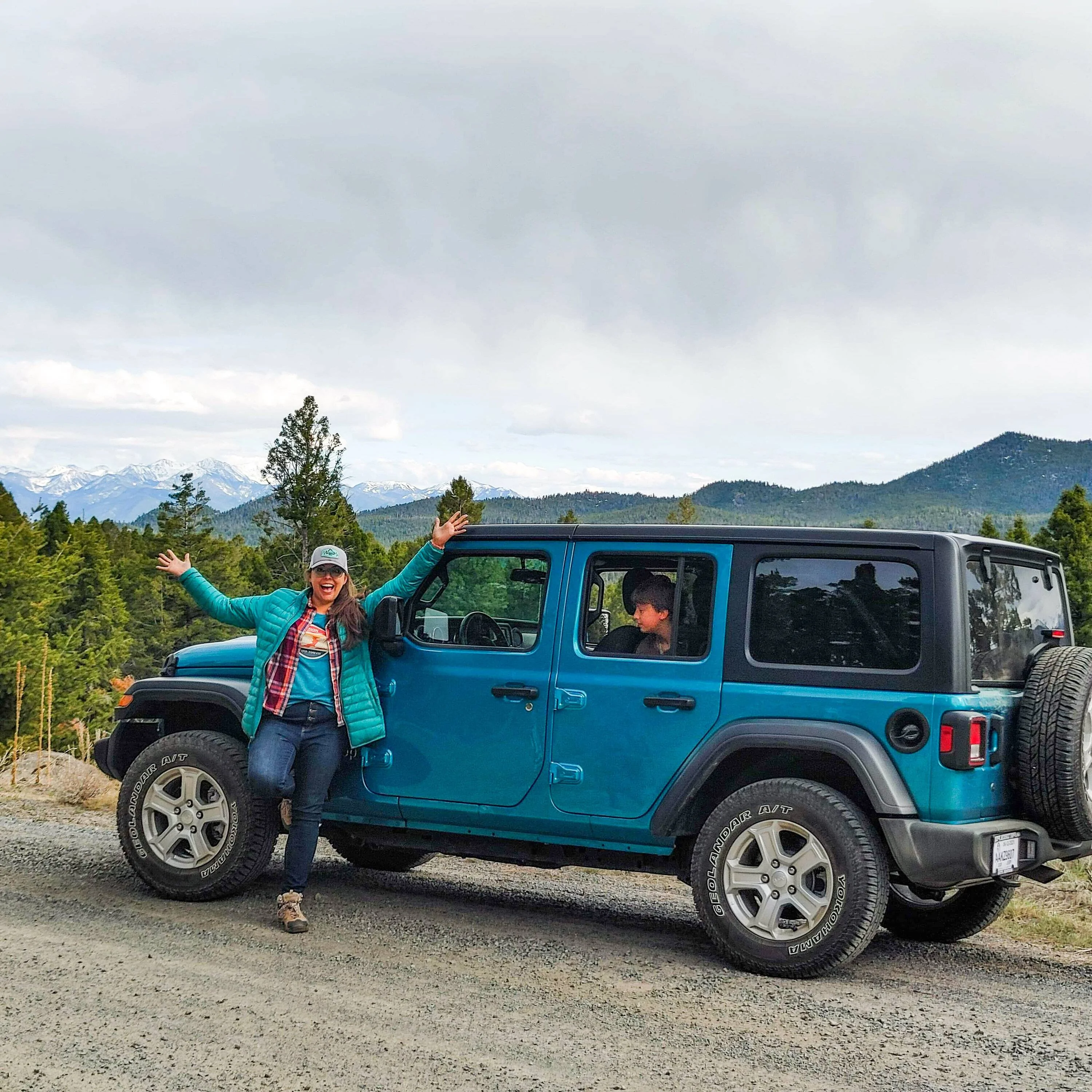

First things first here's my lovely wife and her 2020 JLU 2.0 shortly after purchasing that I believe she's going to name Atigirl (because we drove it up to the Atigun Pass in AK north of the Arctic Circle and then back down to Phoenix right after purchasing). It's the Bikini Pearl color because if you can't tell my wife is obsessed with teal!
