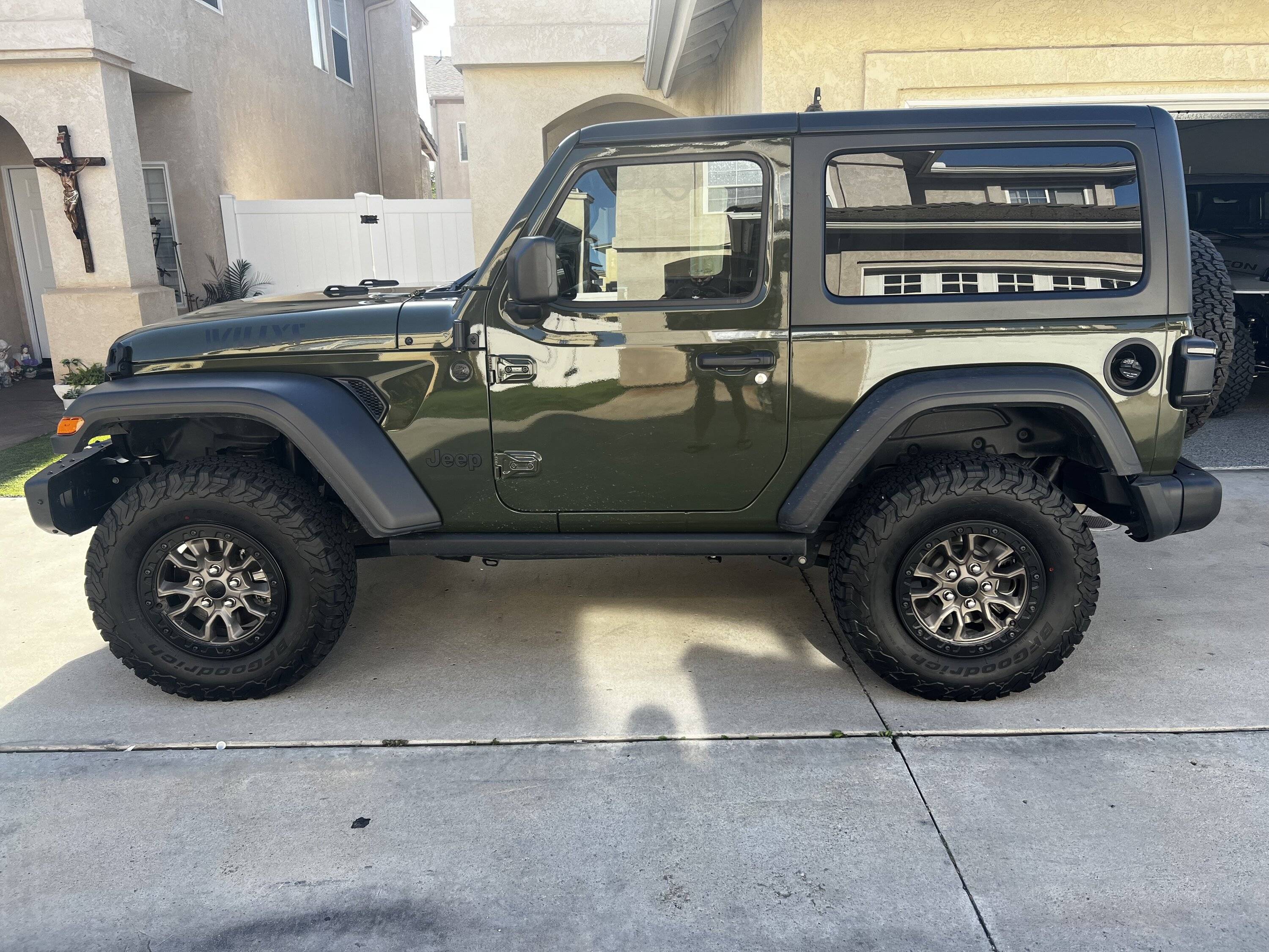

OP, here’s what I did from my stock Willys. I added the shocks and springs off a 4xe that had the steel bumper group and added the front and rear steel bumpers. Overall, there was about 1 1/2 to 2 inches added. Not too much but perfect to me. The front currently sits about .25 inches lower. Once I add the winch, which will be soon, I will measure and figure out which spacer is good to level it out. Seems like we have very similar interests.

That is a fine lookin Willys - I thought a bit about using takeoffs from a heavier factory build, but my experience so far in Canada has been that it's a little tougher of a time to find them than some of my US compatriots have.

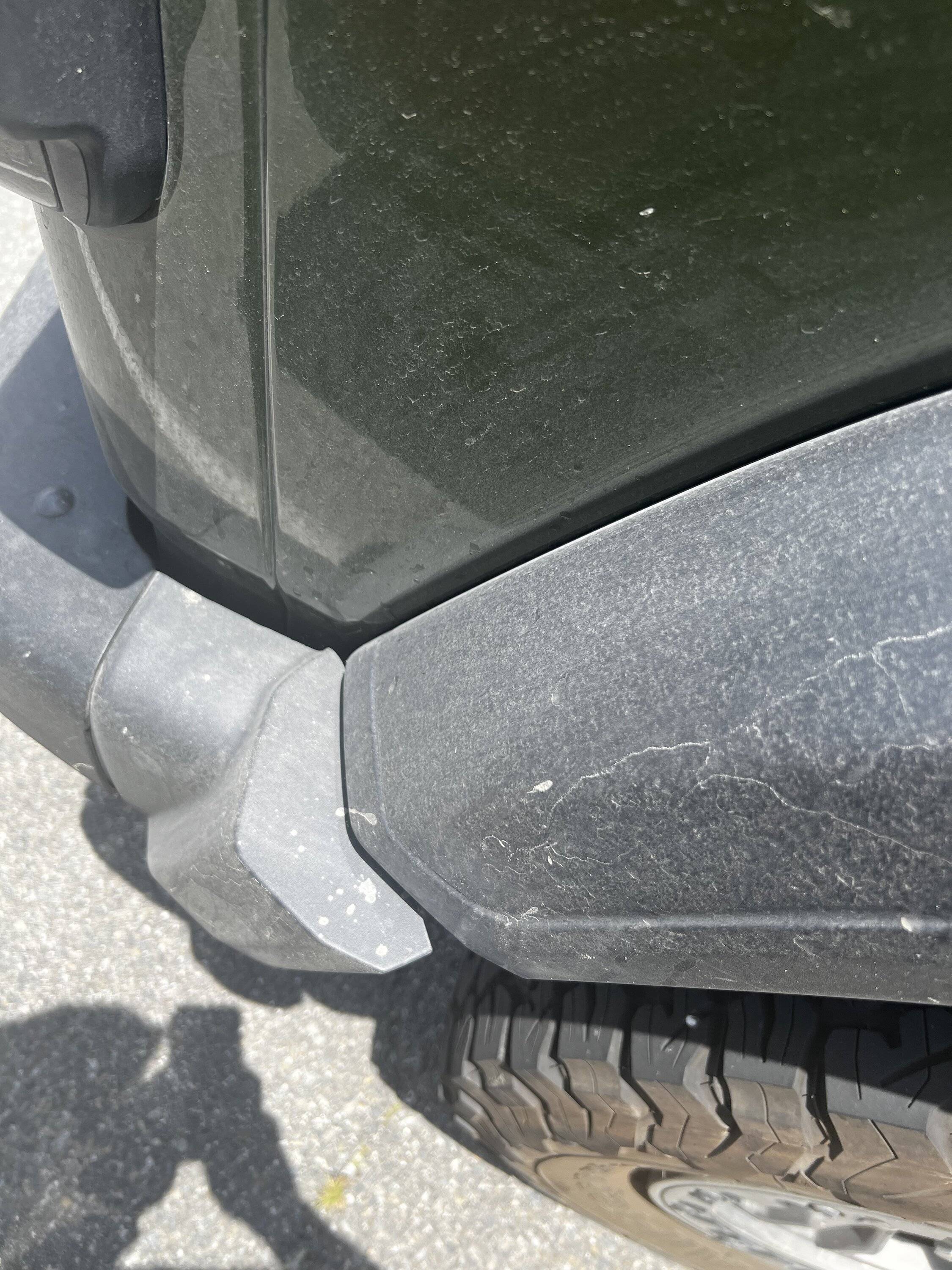

The shop I'm working with said there is a note for the Mopar steel rear bumper that says something about requiring the highline fenders for the fitment to be correct - the steel rear is wider than the plastic perhaps? He hasn't retrofitted a steel rear onto a Willys before so he couldn't say for sure.
What was your experience?

Just walked out and took a pic for you. Don’t mind how dirty she is. I was out in the desert. Fitment is good but not 100% lined up. You can see it in the photo. You really can’t even tell unless you’re at the angle I was for the photo. No trimming at all needed. To install the bumpers, I had to add 4 rivnuts, 2 front 2 rear to have all of the hardware bolted correctly. As for what winch I’m going with, I have no clue.

Thanks a ton for taking the time to snap the pic for me. I see what they mean with it not lining up.. I’ll have to think about it weather or not that would bug me.. hmm

Honestly, I thought it would bug me but it really doesn’t.
