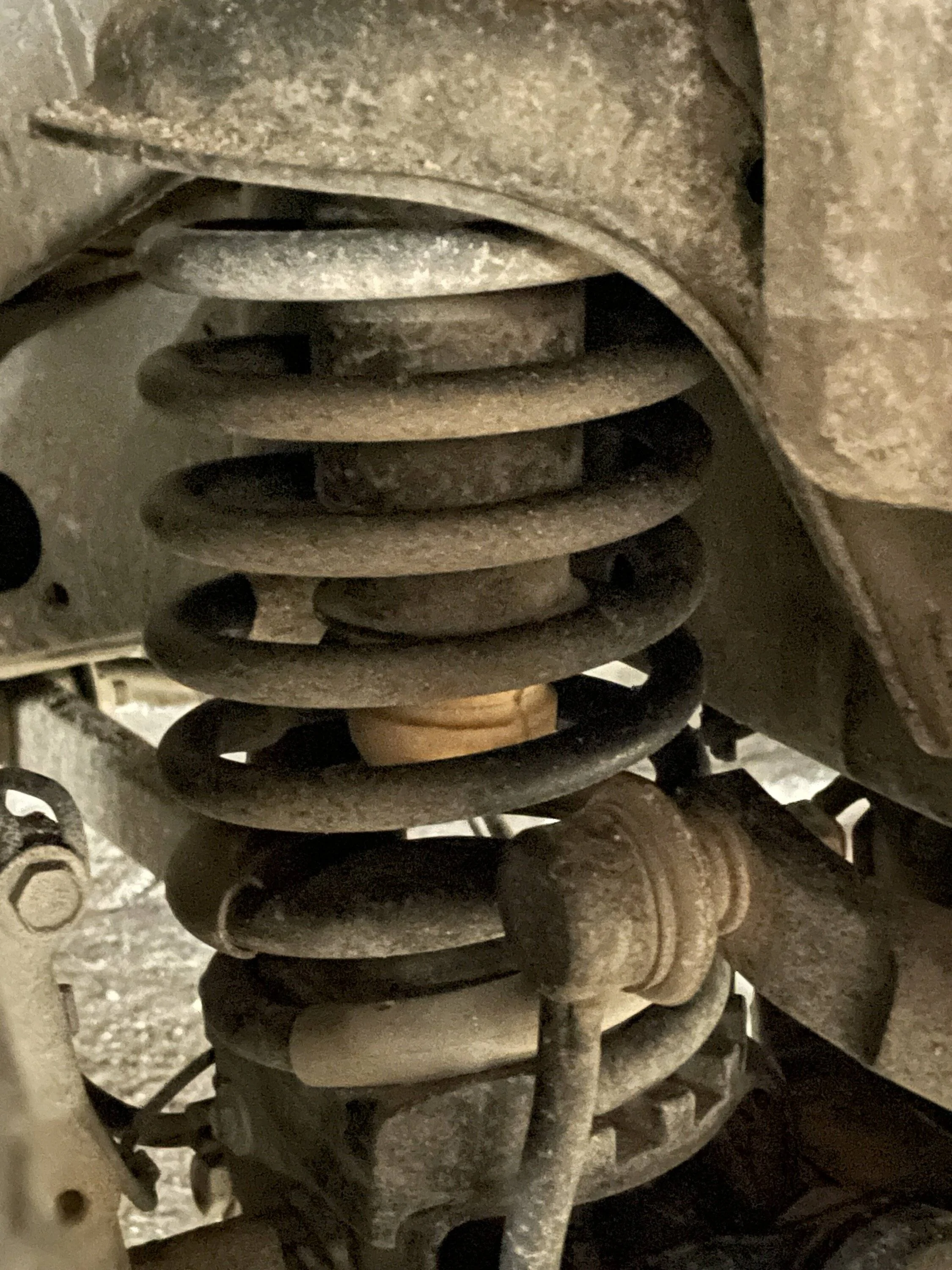

My Jeep is a 2021 JLUR with the 3.6 eTourque, factory steel bumpers, hard top, and tow package. While I always felt my Jeep sat a little low in the front, now that it's at 50k kms, I definitely notice it more. I hit the bump stops more often in parking lots and on rough roads, but I am also starting to think about this because I will be installing a winch in the bumper. No other weight adding mods have been done to the Jeep and the dealer says nothing is wrong (x5, it's getting annoying).
I don't necessarily want a full-blown lift as I still need to fit in some garages and the Jeep can't get too tall for my wife. I considered the Terraflex spacer 1.5" lift or levelling kit, but that doesn't really solve the sagging springs. I am thinking of swapping in springs and shocks from a Xtreme Recon or 392. I have searched the threads and can only find bits and pieces about how much lift each option should achieve.

"JLUXR Springs will give 1.5" over JLUR. 392 and 392 XR springs will give JLUR about 2-2.5" lift."
Does anyone know how each of these three would compare or if this information is accurate? Would the 392 and 392 XR have a nose-high rake due to the lighter engine? I know I may also have to swap out lower control arms.
I do not do any hardcore wheeling, maybe up to what some may call moderate trails. My most demanding use is on camping/hunting trips when the Jeep has some gear, but the trails are mostly poor condition logging/mining roads. I don't find myself needing more articulation necessarily, but more ground clearance would be nice. I will also be fitting 35's soon.
Current space between bump stops is around 1.5"-2"
