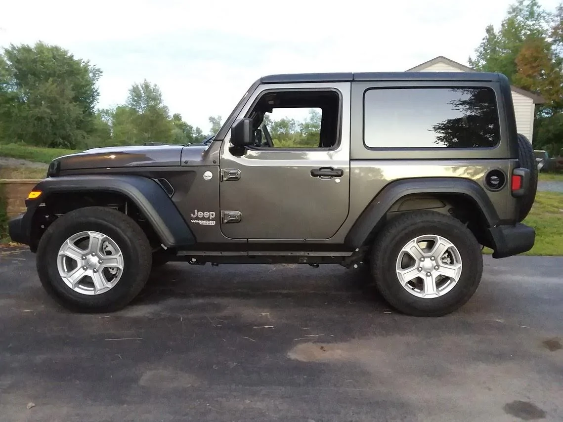

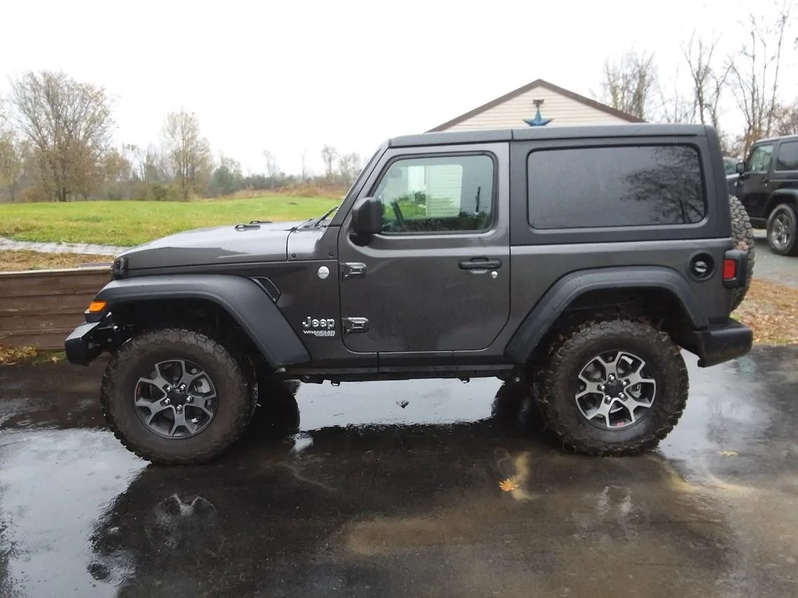

I got about 1-1/2" of lift from the Rubi takeoff springs and another 1 from the tires. I did the mopar lower control arm swap as well which did help with wandering from the reduction in caster due to lifting. Did have to adjust the steering wheel though. I had gotten takeoffs from a 4dr hardtop.
z3D0xjlJ6eB6ShY6vUf3JLjc3FfEhgVIWa2sVYQ9zZQ23JDtOuzwSJhdJrX6kch1cw3ApYVDNdb3XvqeRg=w1139-h854-no.jpg
X8oB20VxaeK6IB3C2nWtzEzfzU50XlS8cfTvuxeEh54caXDM_Fu3_rK323tIo61nVTY3fsTl938bMHgM4A=w1139-h854-no.jpg
