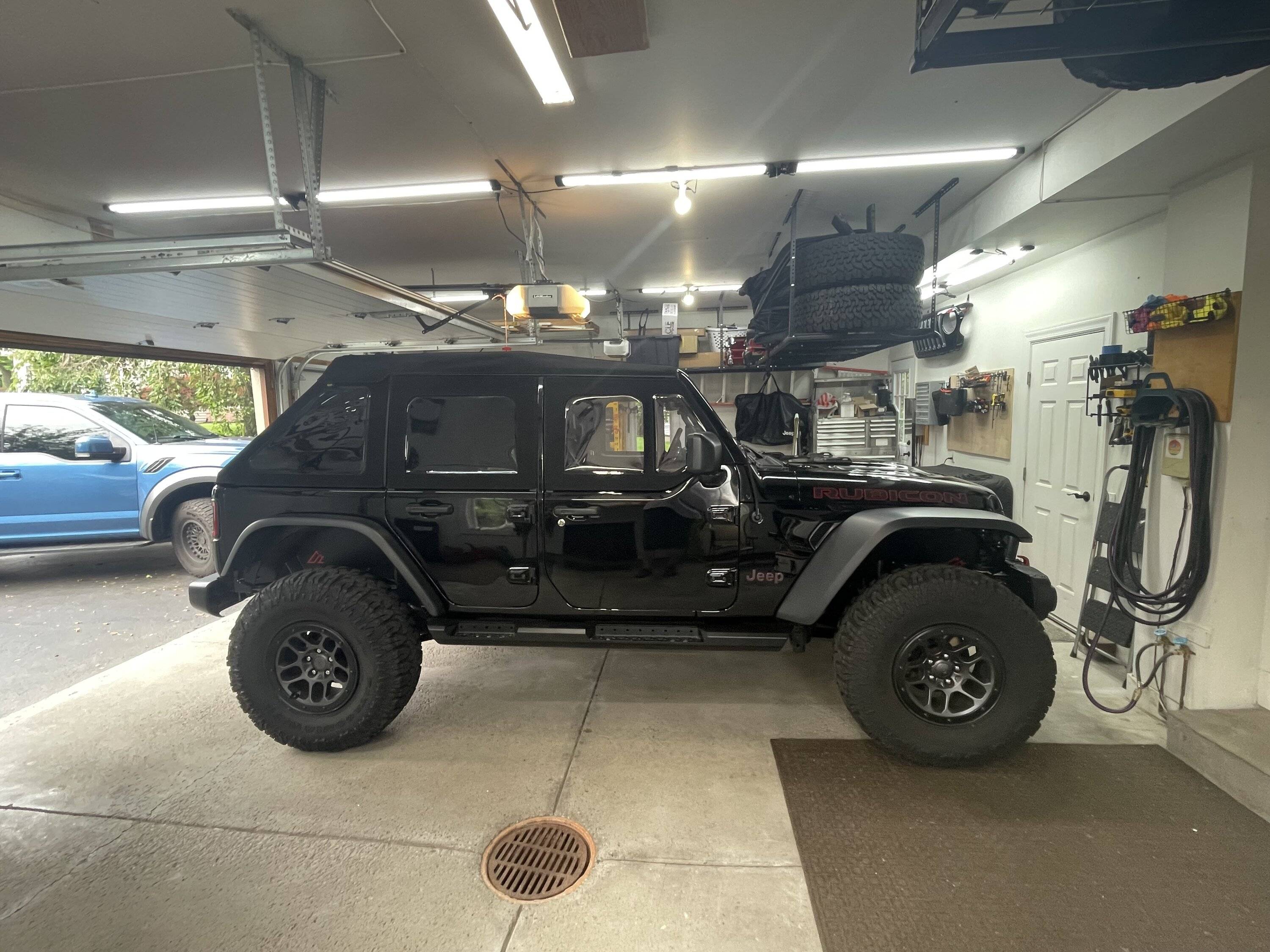

You’re not that far off. My stock 392 XR (no winch) and 2.0T XR (winch + 3/4ā€ front pucks) both have a 1ā€ rake.

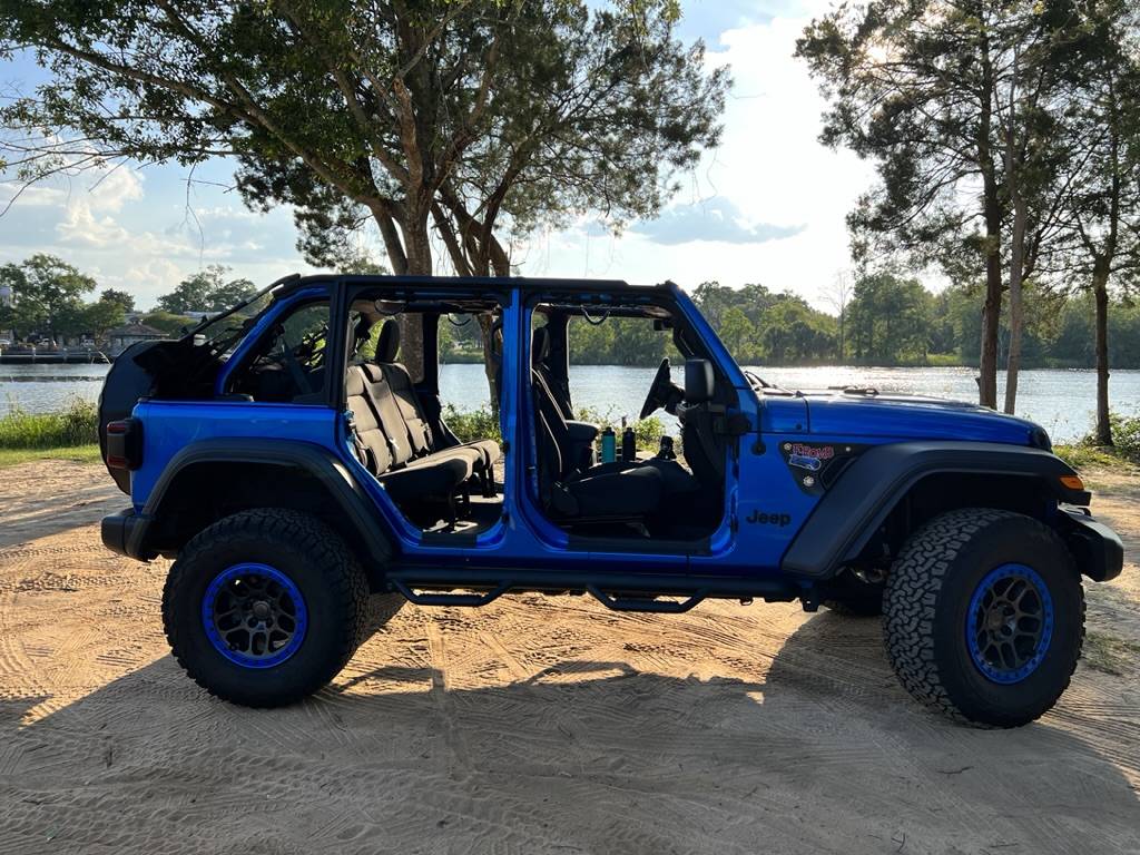

Following cause i have an 18 with the 2.0 also. I thought running a 1/2ā€ spacer was going to be enough. Do you have a winch installed in that steel bumper?
The springs I bought are 189, 190 front and 223 x2 rear springs based on @Jeepeto ā€˜s build thread since his had factory steel bumpers.
Off topic, it’s nice to see that 37s look like they have enough room with xr springs at least.

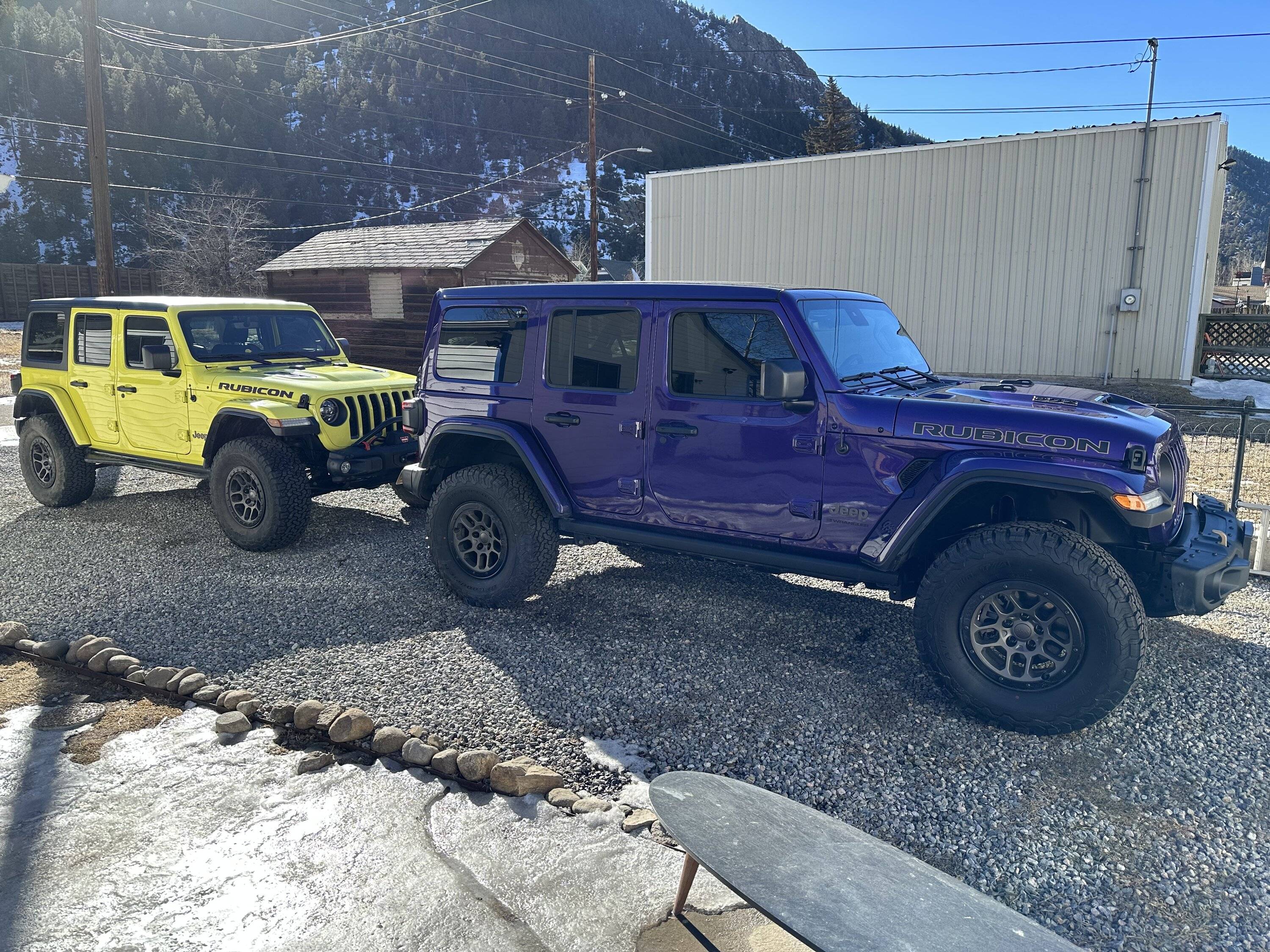

My stock XR has a rank to it. Never went out and measured but its highly noticeable to me. Just didnt feel like dealing with leveling her off.

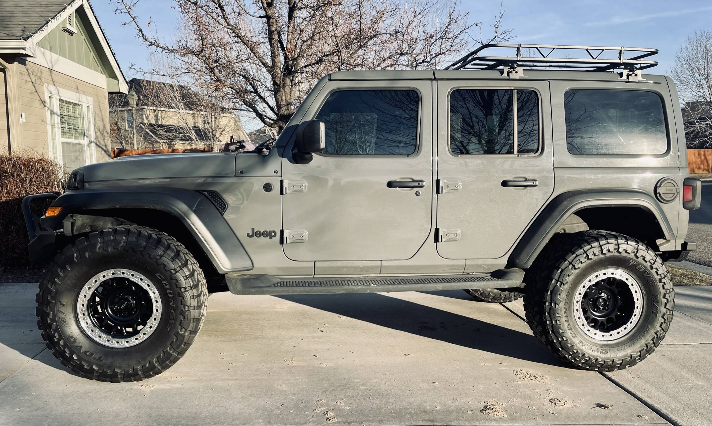

Measured to bottom edge of center of fenders, 43.5ā€ front vs 44.5ā€ rear or 1ā€ of rake. No winch and spare tire delete. I also didn’t have hardtop with rack on. Probably would bring it closer to level. That said, I don’t mind a touch of rake.

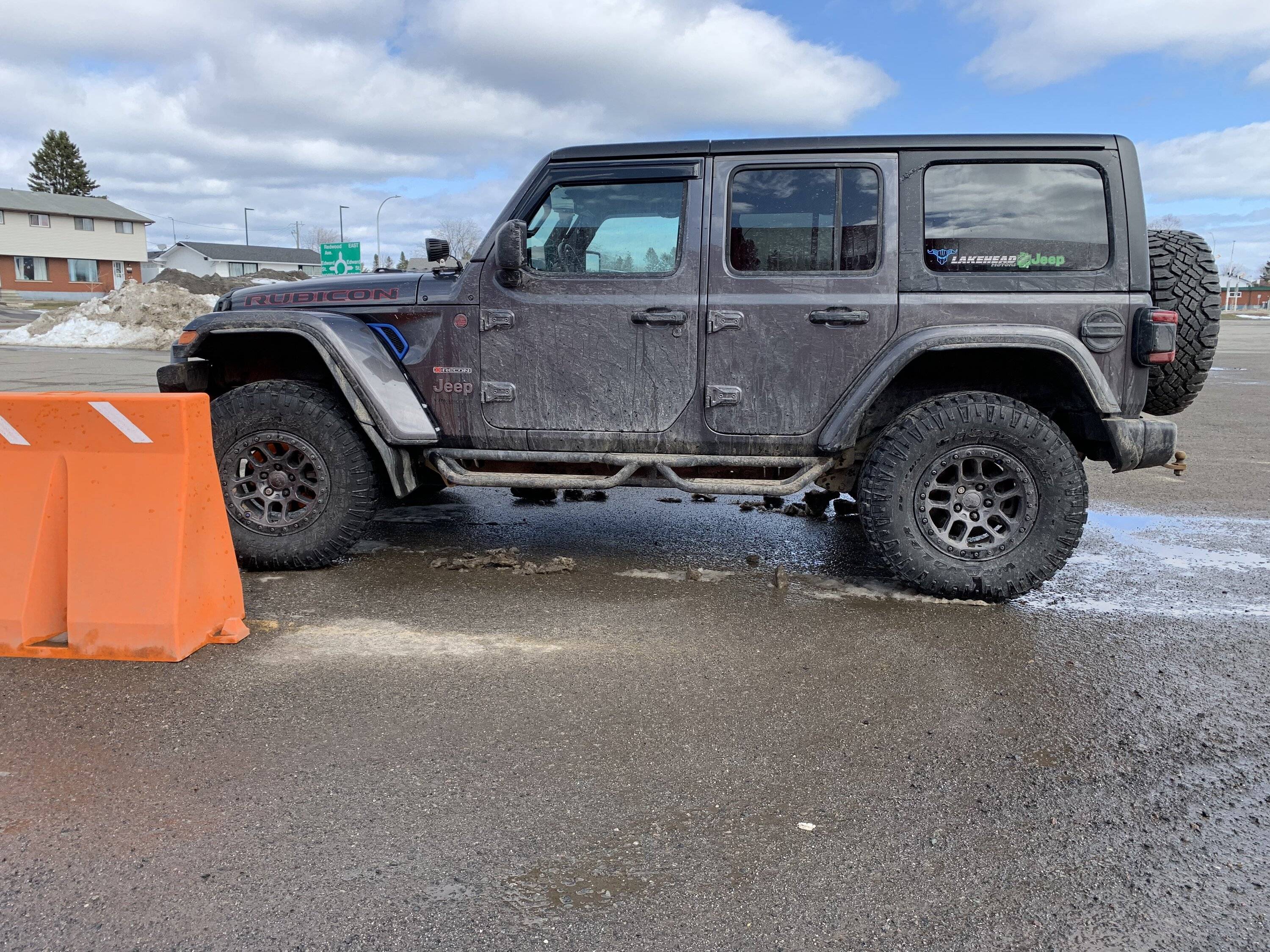

A Steel bumper and winch on plastic bumper front springs and no spare, on tow package, hardtop XR rear springs is gonna give you the most exaggerated rake of all.
Personally I suggest getting better front springs instead of spacers. Those springs are too soft to carry that weight. I run 2.5ā€ RK springs in the rear and 3.5ā€ RK springs up front.
