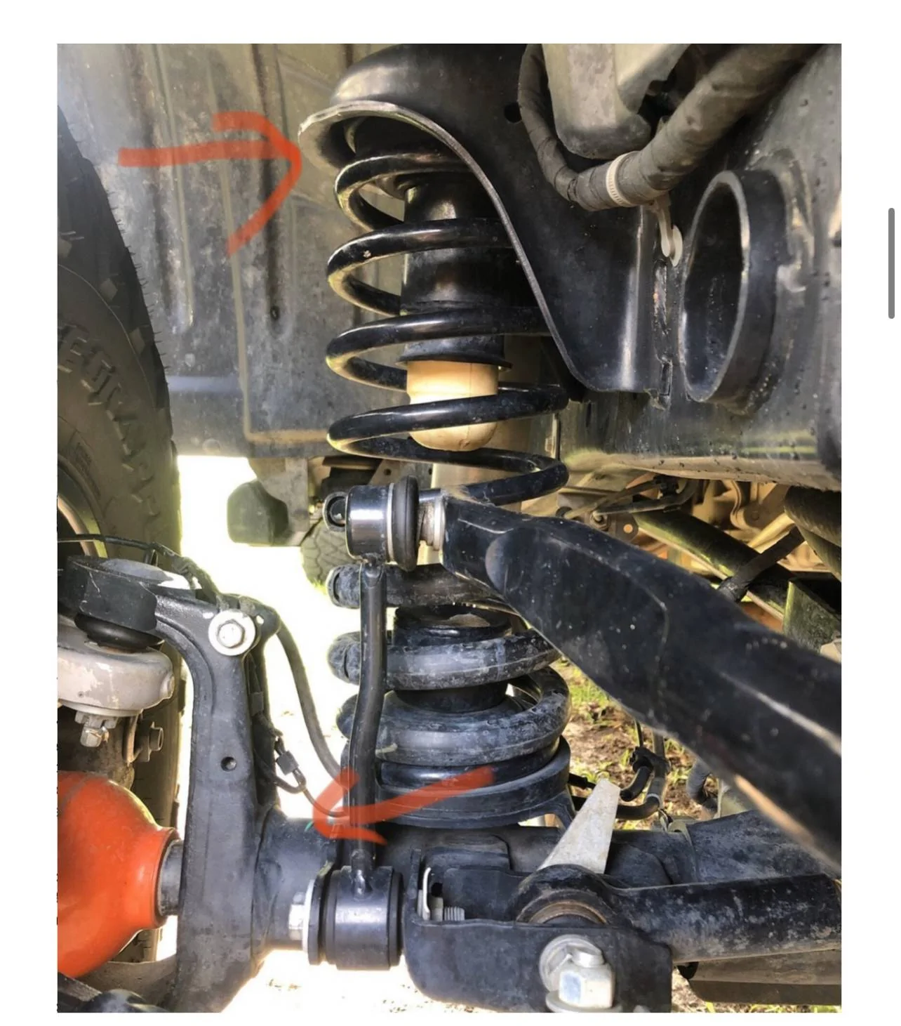

If you are happy with the current height/clearance/ride of the Jeep I also suggest spacers. But I wouldn’t order them until you install the bumpers and winch.
Prior to installing the bumpers and winch take measurements at all 4 corners at the areas indicated below and again after the install. If you only install spacers tall enough to bring you back up to stock height you should’t have any changes to geometry.
The only thing you may want to consider are new shocks to better handle the added weight.

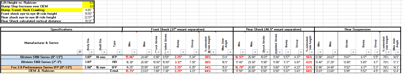

I agree the weight is negligible, and there may be some ride quality improvement to be had (I wouldn't expect jaw dropping improvement, but the right shocks will be noticible). Also, replacing the shocks with the right set will allow you to increase downtravel on your setup.
@AnnDee4444 has been kind enough to do a ton of research and dump it all into an awesome spreadsheet for us, here: https://www.jlwranglerforums.com/fo...gs-suspension-information-chart-matrix.66591/
I recommend measuring your current shock eye to eye length so you can custom tune it exactly. I expect you'll be slightly under the Rubicon height, and you can tailor the spreadsheet by adjusting the "lift height" so that the eye to eye heights match your measurements:

I'd be really tempted to recommend the 2-3" Bilstein 5160s. They are just barely out of spec for your front stock bump, ride awesome, and would make your rig a flex monster at stock height. Looks like the set would be $80 more than the Fox 2.0 IFPs on Northridge right now.
BS 5100 0-1.5 = $396
Fox 2.0 0-1.5 = $720
BS 5160 2-3 = $800
The 5160s are remote reservoirs, so they move the second piston out of the tube, allowing a shorter compressed length.
