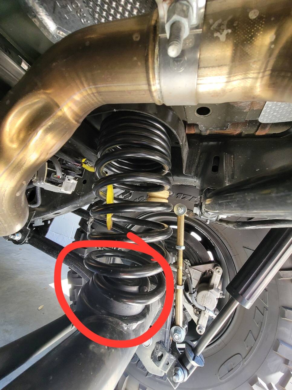

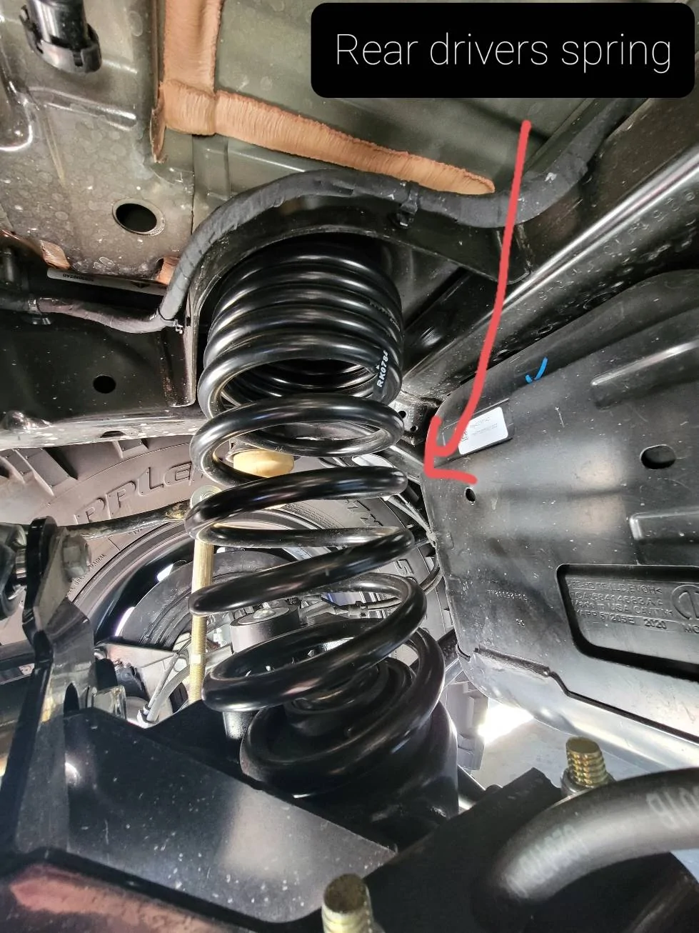

Rear springs do not look properly seated as stated above. Are your rear lower control arms properly adjusted? Not trying to be an a** but did you accidentally install front lower control arms on rear?
I did the front first then I did the rear. Since I pulled each part as I needed

That rear pinion angle is crazy, something is way off on measurements. You are measuring center of hole to center of hole in a straight line, correct? The recommendations in the book are just starting points, fine tuning has to happen and yours needs some fine tuning for sure.
Jeremy is correct on the rear track bar, you have RK06692 which was superseded by RK06692B when the diesels came out. RK06692 DOES NOT FIT DIESELS.
Double check the rear spring correction pads as there are 2 holes on the axle that they could be put into. The thickest part should be towards the rear.
I would expect ride quality to be absolutely terrible with the springs going anywhere but straight.
I did measure center to center. And the coils were seated properly when I finished the lift. Unfortunately, I don't know how much the alignment shops adjusted the rear arms. Can you confirm the rest of these part numbers fit the diesel please.
I did measure center to center. And the coils were seated properly at the time I did the lift. Unfortunately, I don't know how much the alignment shops adjusted the rear arms. Can you confirm the rest of these part numbers fit the diesel please.

If you took it in for an alignment and they changed things I can almost guarantee you that is where your problem is. Alignment shops pretty much always reset things back to the factory specs.
That's what I'm thinking. It didn't look messed up like this when I completed the lift. I wish I would have taken pictures. With the rear wheels on, I don't see the rear coils. I decided to crawl underneath today and saw how bad it looked. After 3 alignment shops, I needed feedback.

I realize you're frustrated, but the issues (other than the wrong track bar) you are having are from installation/alignment shop errors. The rear of your Jeep is not even in the realm of set up properly and that has nothing to do with RK or Northridge. Put on your big boy pants and pull everything off and start over. When I take my rig in for an alignment they have express instructions not to touch anything, but to give me the measurements so that I can make the proper adjustments.
