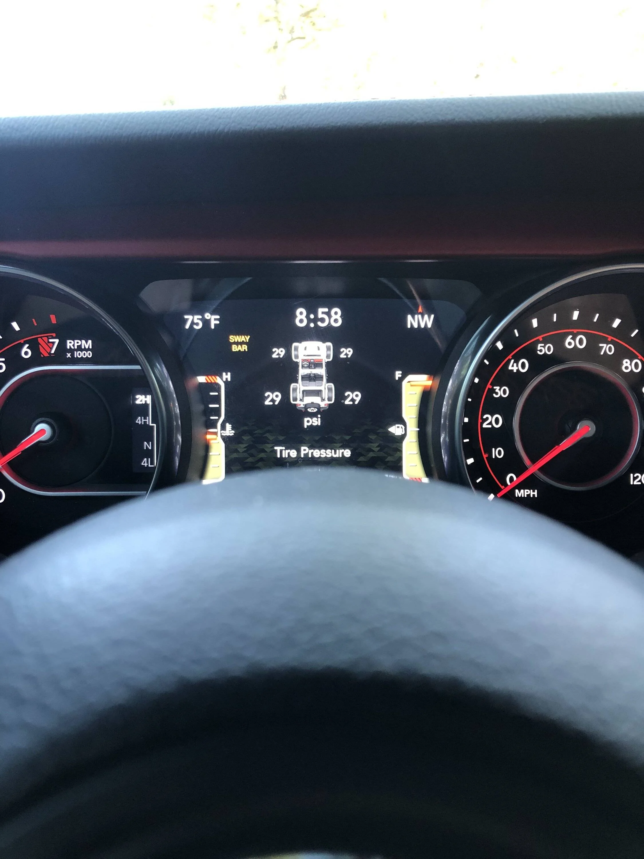

turn it off when get on the trail, turn it back on when I get off the trail, and air up….It doesn’t make sense to me to have it on bugging the crap out of me while aired down, it’s not like I can do anything about it if a tire is going down…I can watch it on the dash, or stick my head out and watch it, either way it’s going down….?
OCD pacified …….?
