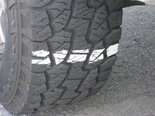

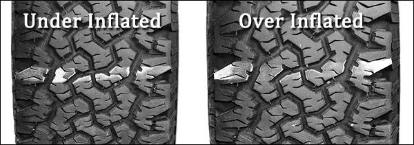

It varies by different tires - do a chalk test

I run 28-30 on 35” KO2’s and don't have issues, I first tested the 10% rule then chalk tested and around 30# is good and I get very even wear.

I up' d it to 36 and it's a much harsher ride. They look to be rounded/over inflated at 37 but I haven't done the chalk test yet.

Yes, great question and my new Willys with 285/70r17 MTs is at the stock 37psi! I can hear the rear tires slowly rubbing the tread off even on very light acceleration, they appear to have rounded tread surface at 37psi, going to try 32psi and see, adjust from there. Probably do the old chalk test too, thinking 30-32psi is probably going to be the sweet spot on the road...lower pressure off road of course.
