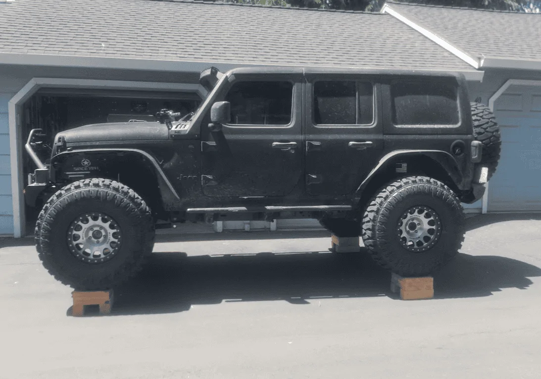

I also do this in case I need to spend some time under the jeep and I don't need to remove the tires.. it gives you plenty of space to roll around under the JL with a creeper

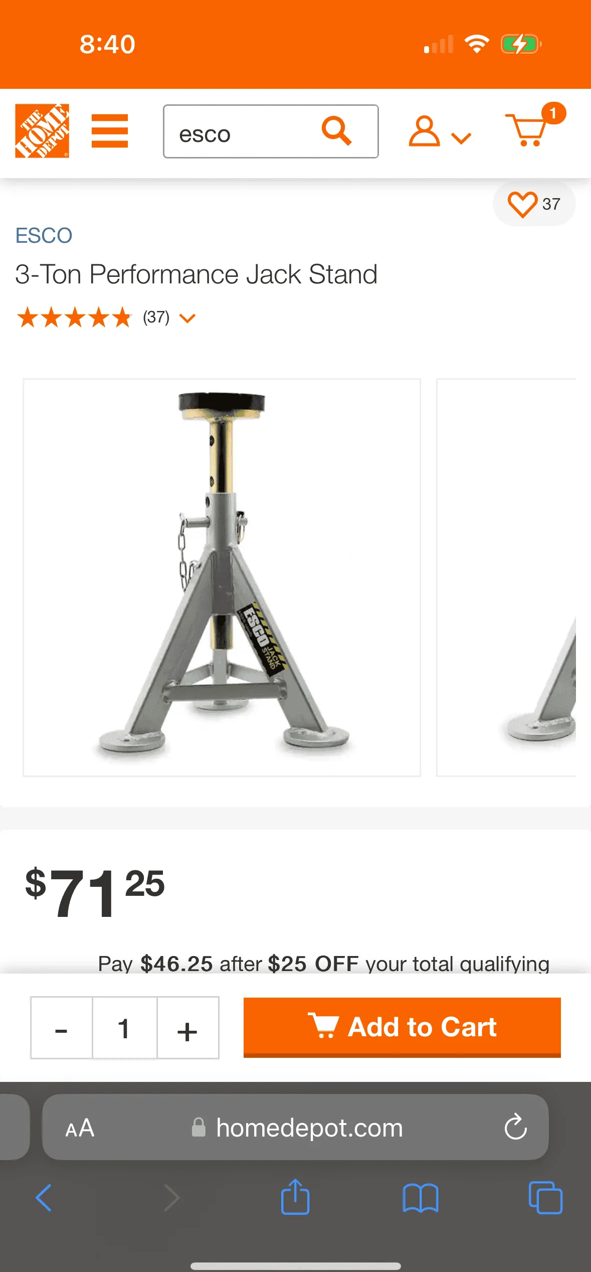

Was putting new springs on the Jeep. Jacked it up with the floor jack, put the stand under it and let the jack down. The stand collapsed. Coulda been bad I guess. Took a look at the stand, and a drift pin had broken so that the teeth weren’t fully engaging. These are going in the trash. I can’t even remember where I bought them. The brand is Larin from 2002 according to the date stamp.
I really like these Esco stands as they are solid and are pretty high.
