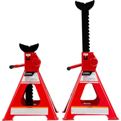

Just to be sure everybody knows, the weight capacity for jackstands is normally advertised by the pair. That means that one jack in a 6 ton jackstand set should be limited to 3 tons.
Jackstands are a pain in the butt. They never seem to be the right height, they are heavy, they need to be 100% reliable. I need Jackstands for my 2014 Honda car, my 2020 Jeep, and my 2001 38 foot diesel motorhome. Needless to say, one size does not fit all.

In 2020, Harbor Freight recalled 1.7 million of their 3-ton, 6-ton, and 12-ton Pittsburgh-brand jack stands due to concern that, if the load on the jack shifted, the “pawl” could disengage and cause the load to drop. Eleven people reportedly received non-life-threatening injuries. Some of replacement stands were later recalled. Safety-consciousness generated by the publicity caused a revival of interest in tubular pin-locking stands, as well as incorporation of locking pins into ratcheting stands.

When I'm actually under a vehicle working on stuff I'll cram some old tires under the vehicle, but I think I need to shop for better stands. I have one tall 6 ton set and a shorter 3 ton. I like using the 6 tons if I can since they're quite a bit taller. Always nervous seeing jack stands maxed out at the highest setting just kinda teetering on that last notch :(
I WILL be getting a set of those pin stands for sure.

For those interested, this was a good watch.
In the movie, you could really see the "roll pin" mentioned in the OP's report of failure.
Notice that all jacks far exceeded the weight rating. The tip over test was something new to me. I didn't know why until I saw the test, but I like jack stands that have little feet at the corners.

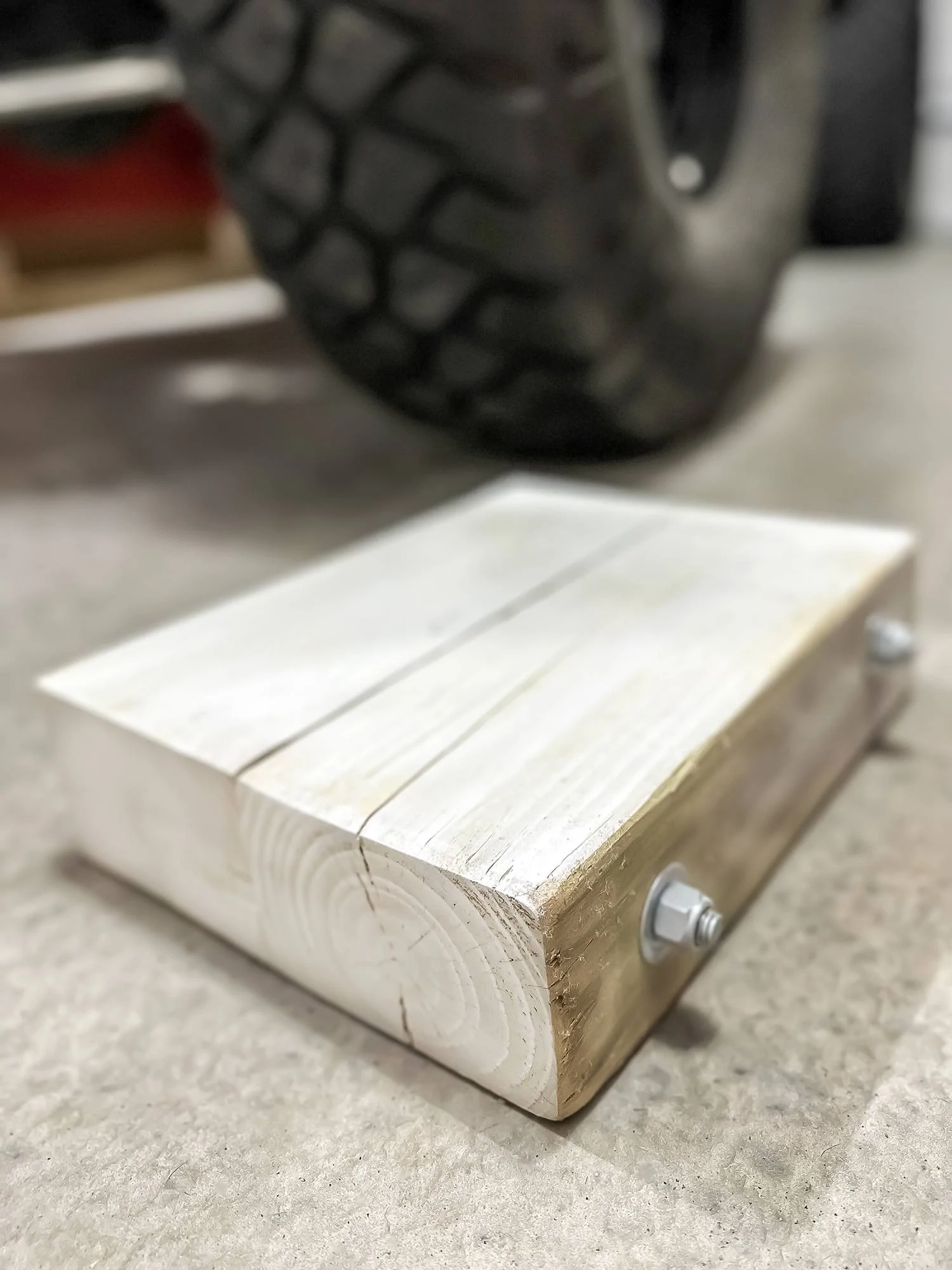

I use Hein-Werner 12 tons because I need the 29" of height. But, I'll be rethinking my stand setup now that @fat_head dodged that bullet. Glad you're okay, man!
I always put my stands on cribbing so I don't have to go up beyond three teeth - just to make sure the stands stay solid. I use 4x6s bolted together to make 4x12s and they are 14" long. So, they are 4x14x12 platforms. I got the idea from some leftover hi-lift bases I had. It's the same cribbing I use for my hi-lifts in the soft sugar sand here in Florida.
