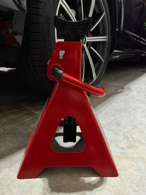

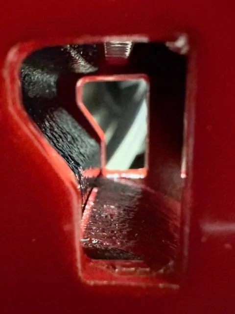

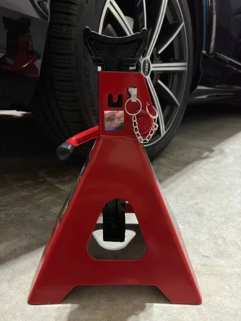

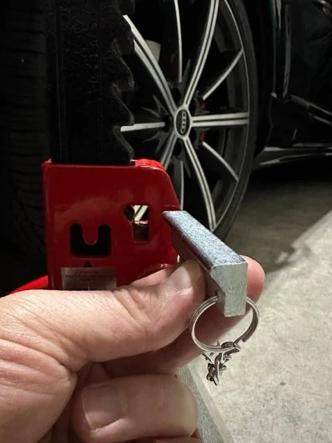

Timely topic for me. I just bought stands on Saturday from Amazon. I mulled over the right ones for months, and am now not convinced I chose correctly.
Big Red 6 Ton’s on Amazon
I like that the pin is shaped in such a way to suggest it’s providing double protection. It certainly would prevent the locking handle from moving. However if you look at the closeup, you can tell that the pin won’t fully engage the entire depth of the teeth on the ratchet arm. So it seems a bit superficial.
The post on Amazon says it’s ANSI rated, but neither the manual nor the actual stands mention the same.
Just say NO to ratchet stands. It's an unnecessary complexity to a product that needs to be "bowling ball reliable".

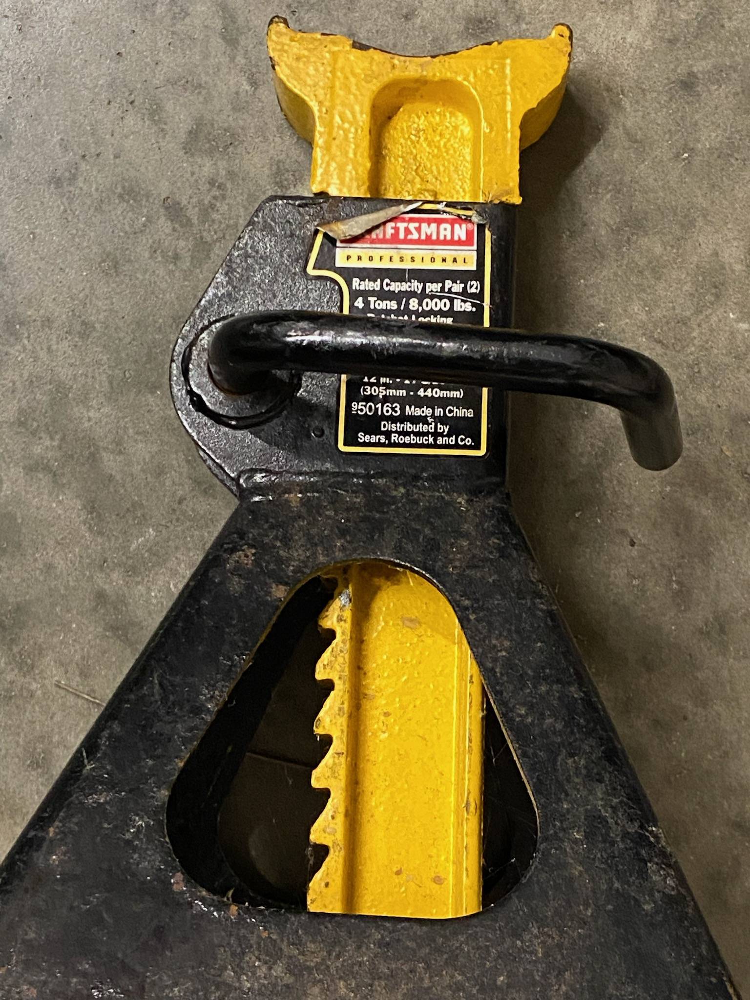

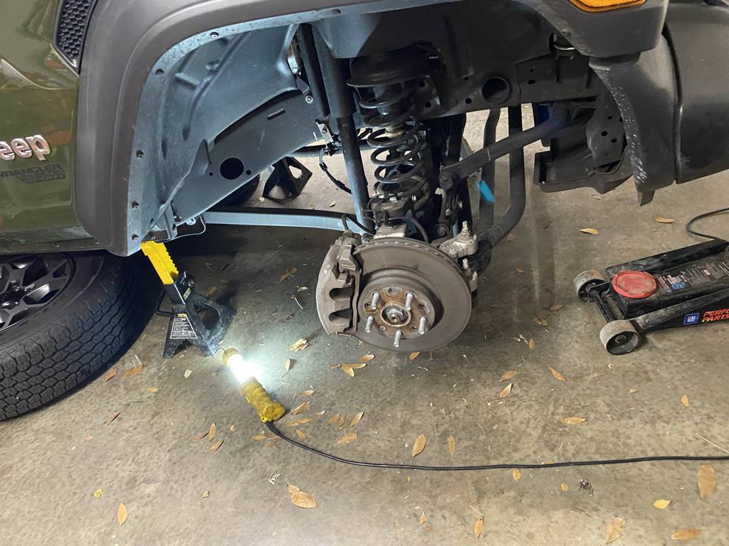

Was putting new springs on the Jeep. Jacked it up with the floor jack, put the stand under it and let the jack down. The stand collapsed.

No. The jack i used was a floor jack from Harbor Freight. The jack stands I used I bought 20+ years ago from Pep Boys most likely. Or autozone.

I got a set of these back when Sears was a thing. I had my 2014 Tundra on them for weeks while figuring out the rear axle assembly and a wheel bearing, installing the lift on my Jeep, and countless other repairs. I never am nervous getting under a vehicle supported by them, but I typically also stack some tires and 4x4s in-case I have to roll out from underneath them quick.

Was putting new springs on the Jeep. Jacked it up with the floor jack, put the stand under it and let the jack down. The stand collapsed. Coulda been bad I guess. Took a look at the stand, and a drift pin had broken so that the teeth weren’t fully engaging. These are going in the trash. I can’t even remember where I bought them. The brand is Larin from 2002 according to the date stamp.
