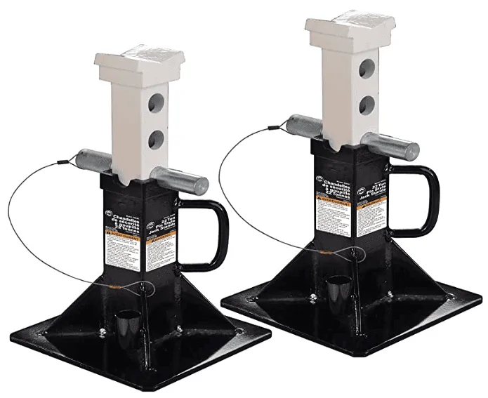

Currently I have some Big Red 2 ton jack stands but they're really inadequate. I've been eyeballing the sunex jack stands. They will be overkill at 22 ton rating, but they are not going to fail. They rely on a large pin for height adjustment and have a flat base. Used them in the trucking industry to hold up semi trucks and trailers. Very reliable and very stable jack stands.
https://www.amazon.com/Sunex-1522-22-Ton-Jack-Stands/dp/B0093NBS9W/ref=mp_s_a_1_14?crid=1OMU8L1V9VNH&keywords=20+ton+jack+stands&qid=1676357695&refinements=p_36:1253497011&rnid=386419011&s=automotive&sprefix=20,aps,102&sr=1-14
++1

I've used them a couple times with the lifted jeep on 37s and my truck as well. Very much confidence inspiring, and the height range has been perfect under the axle tubes. I haven't jacked and supported under the frame with these, so I don't know if they're tall enough for the lifted JLUR in that use.
https://www.amazon.com/Sunex-1522-2...19011&s=automotive&sprefix=20,aps,102&sr=1-14
Go big, or go home.
