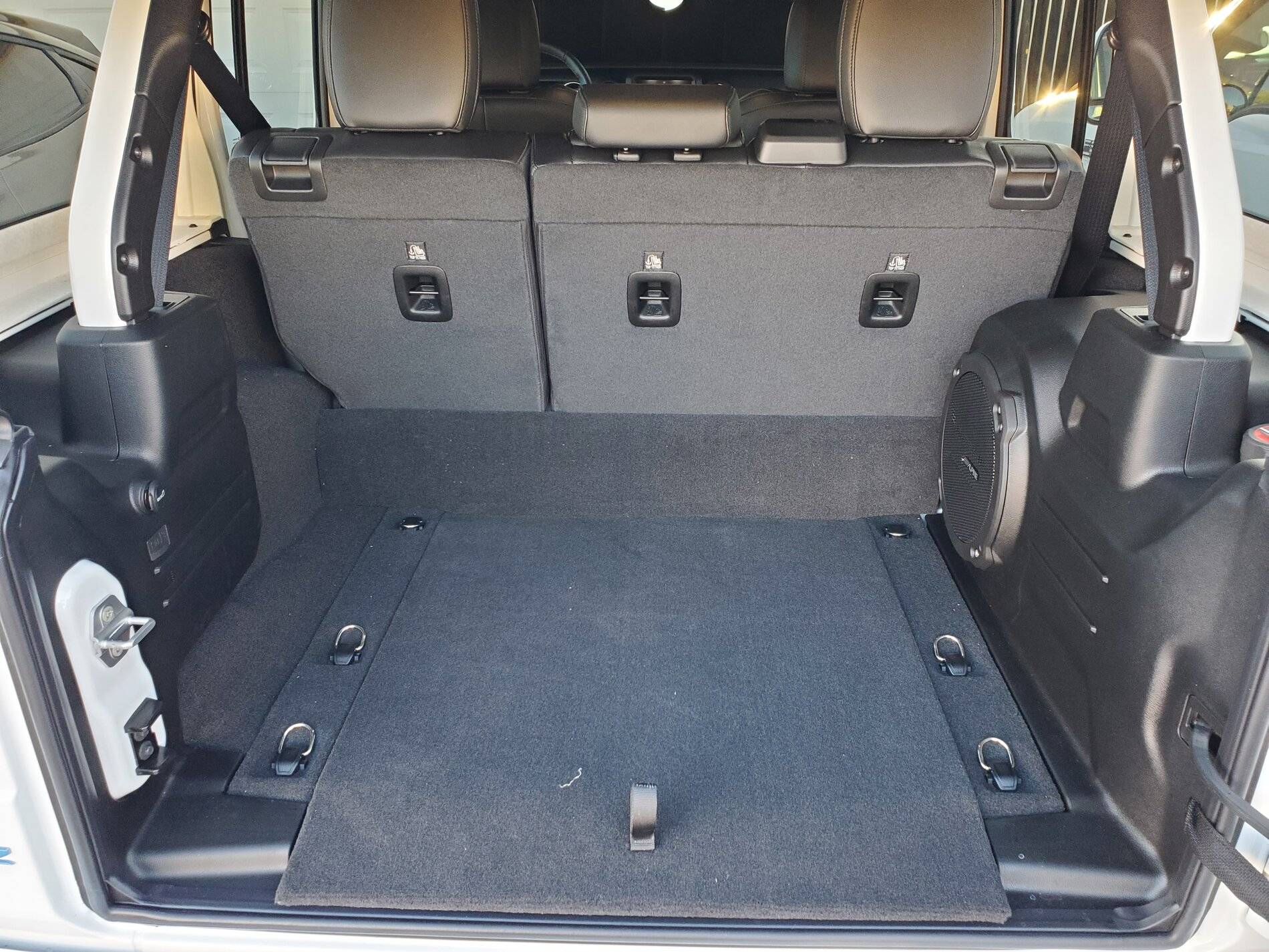

not a great pic this is with my slipstream installed right where that lip is. Again it lifts right out just cut the mat at the lip or a inch beyond. Personally I carry a Harbor Freight Packing blanket at all times, I do not need a matt tat is far more versitile for me.
So that lip only covers the mounting points for the rear seats then huh. Probably helps provide a small shield for the battery too

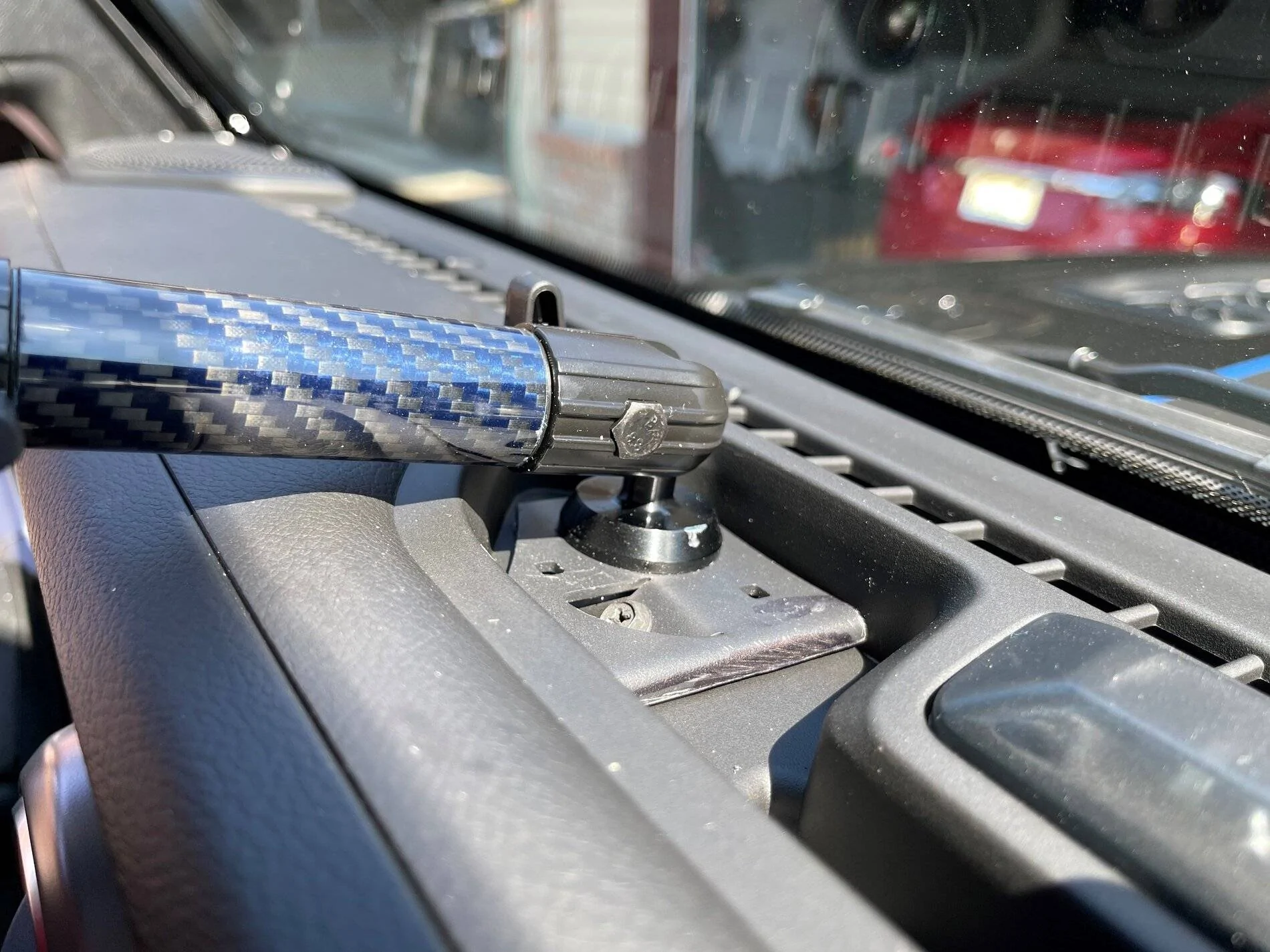

Installed the BulletPoint Phone holder (just a 67 Designs knock off) this fits the JL but not the 4xe without modification.
BulletPoint Phone Holder AMAZON
JL tray has a different shape and it is deeper, So there is a L shape leg that aims down, just cut 3/8" from bottom.
Jeep Wrangler JL 4xe mods -- what works/doesn't work from regular JL's? phone 1
Then it Screws right in perfect fit
Jeep Wrangler JL 4xe mods -- what works/doesn't work from regular JL's? Phone 1a
Jeep Wrangler JL 4xe mods -- what works/doesn't work from regular JL's? phone 2
This thing is Rock Solid
Jeep Wrangler JL 4xe mods -- what works/doesn't work from regular JL's? Phone 4
Jeep Wrangler JL 4xe mods -- what works/doesn't work from regular JL's? Phine 5

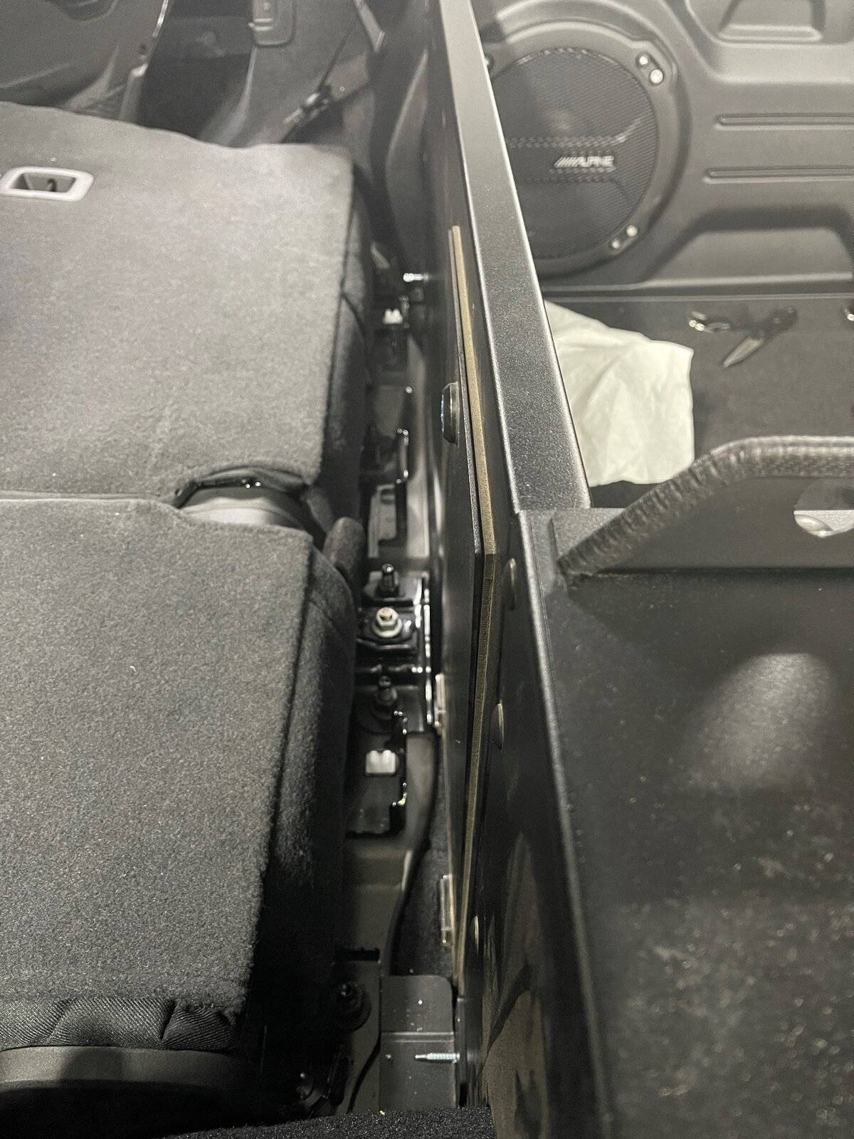

Here is a photo of the rear compartment area. That partition behind the seats measure about 6" high. Much higher than I realized. Do all the PHEV Wranglers come with that sub-woofer speaker enclosure? I am going to design and build a storage box 6" high so when the seats are folded then I will have a big flat surface for sleeping bags, cargo etc.
If some of the 4xes don't have that speaker then I can make two designs and share the drawings here. My basic plan is to get some 1/8" aluminum and break form it into a large upside down tray. it will need some structural bracing or angle shapes for strength. Then I will cover it with some low pile carpet or felt to match the cargo area. Hopefully my side panel bag will stow in that space.
Let the modding begin!
Yes on the 4xe all have the Sub, however at some point the Alpine with sub will likely become and option and not part of the 4xe Package, Speculation only though
Yep, part of the Alpine audio which is standard on all 3 4xe trims.
