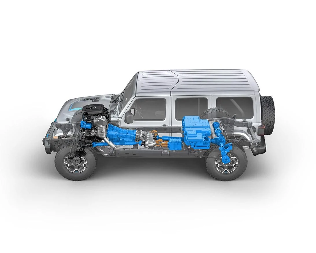

What about just using a current 3.6 engine lift kit (heavier than the 2.0) and just add a 1/2” or 1” spacers in the front?
Based on this image below on the layout of the extra payload, I'm thinking it's the rear that will need the extra spring rate/lift - the front is probably going to sit around the same as the 2.0L with eTorque, that large electric motor and that battery pack that are in the rear will be where most of the extra weight is at.
