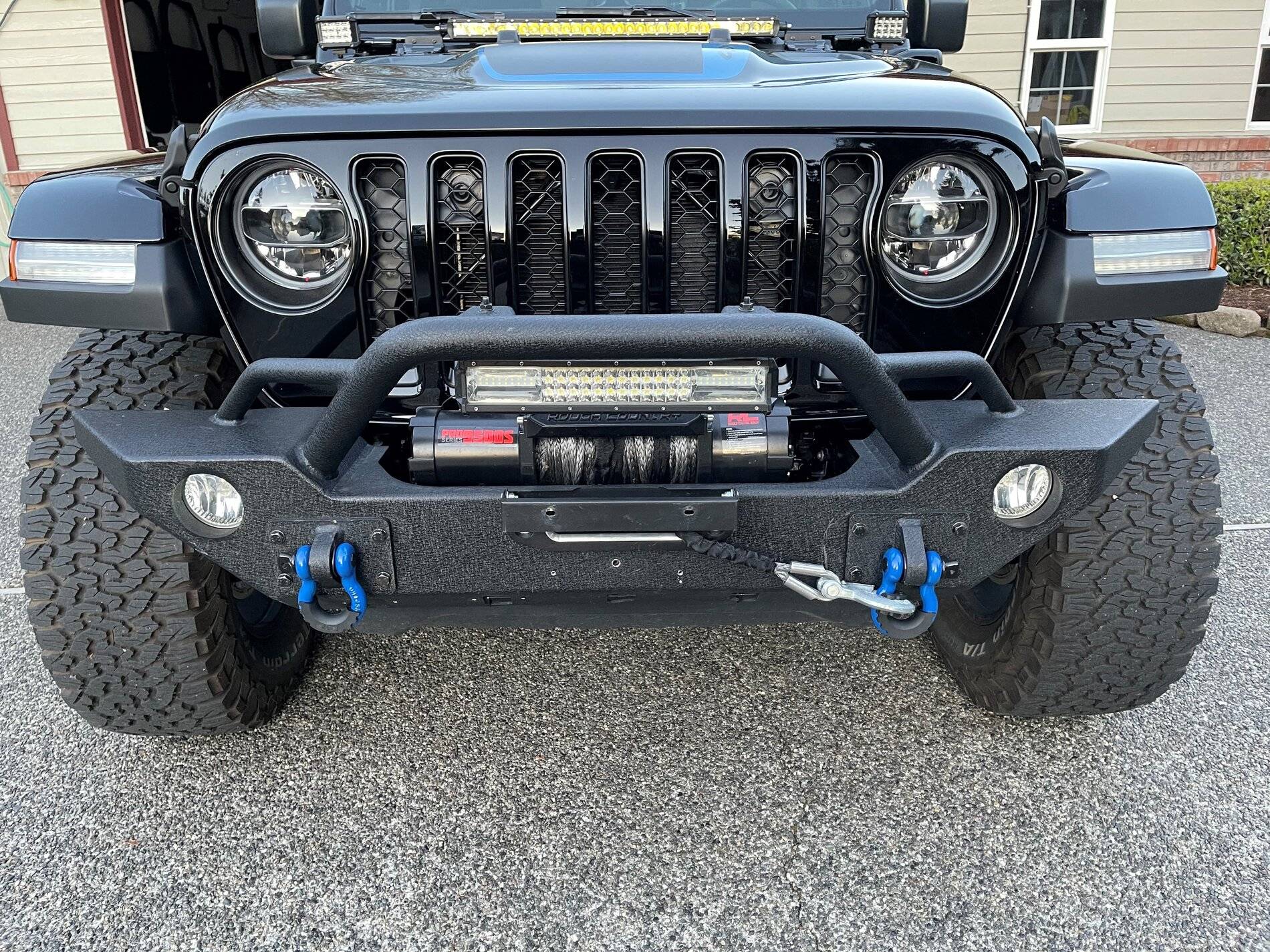

Spent the weekend on a few mods on the 4xe.
  • Teraflex 1.5" lift
  • XD Assault 18x9 wheels with 35 KO2's
  • RokBlokz XL Mud Flaps
  • Go Rhino Dominator D-6 Slider Removable Drop Steps
  • Diabolical Slipstream Security Enclosure
  • Barricade 3/4 Alloy Series Bumper
  • RC 10,000lb Winch
  • 17"LED Bar (bumper)
  • 40" LED bar (hood)
  • Dual 5" Cubes (window Cowl)
  • Rancho Adjustable front/rear Track bars
  • Teraflex adjustable front Lower control arms
  • RC Spare tire Relocation Bracket
  • Painted grill inserts Black
  • Rock Slide Engineering Rocker Armor
  • Full body 3M Paint Protection Film (PPF) wrap
  • Thule Pro 2 XTR Bike Rack
  • Bullet Point Phone Mount

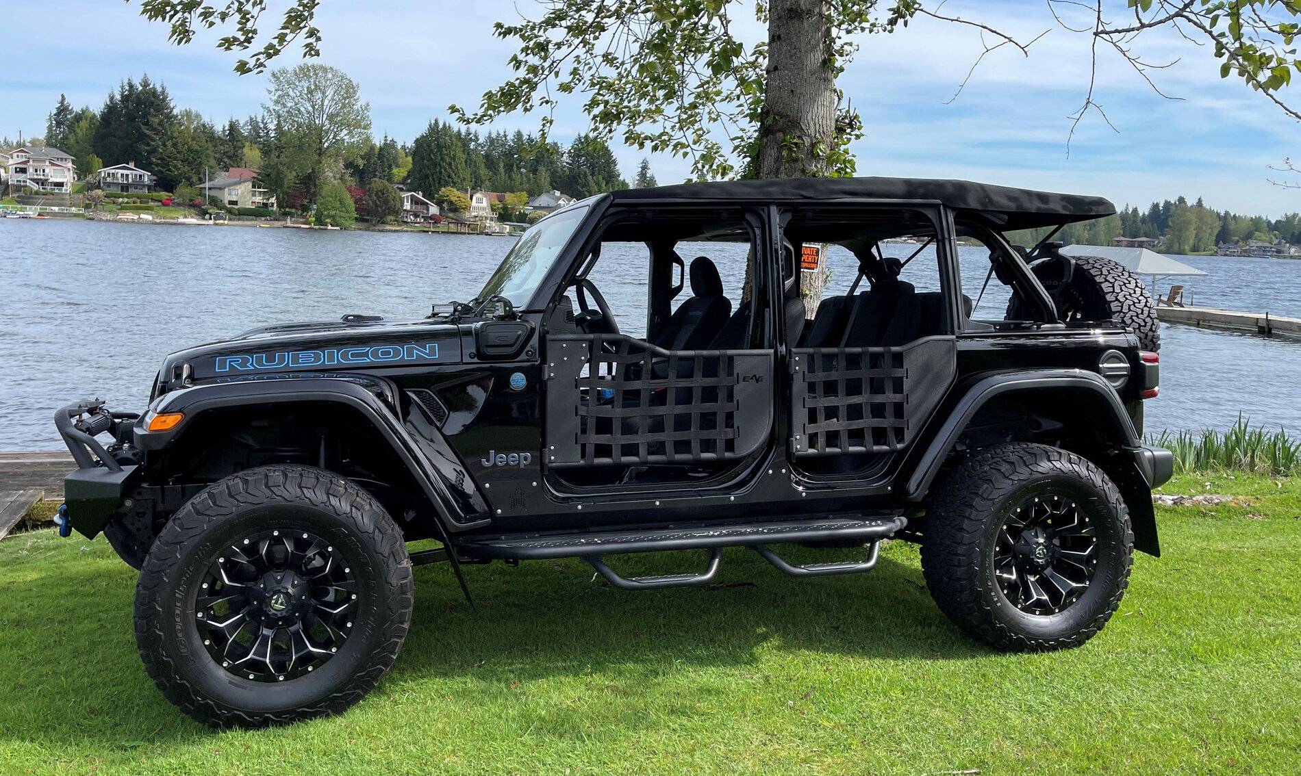

So far most of the above have not requires much modification to make fit the 4xe, However the Slipstream require alteration of the two floor mounting brackets. The Window Cowl LED Cube brackets also requires cutting and some minor reshaping as the charge port will not allow most if not all of the current brackets to work. Also not the Teraflex Lift is a 1.5" ST1 kit (2" front and 1.5" rear). As you can see any higher would not look right with 35's, in fact I and considering changing my rear to only 1" to eliminate the front rake, however I still have a steel rear bumper coming which like drop the rear a fraction. Yo should also note that a aftermarket bumper and winch will cause the front to sag about 1/2" so you should account for that when you lift. That gap between the tires and the fender flair is exactly 9" on all 4.

Barricade 3/4 Alloy (Aluminum) Series Bumper

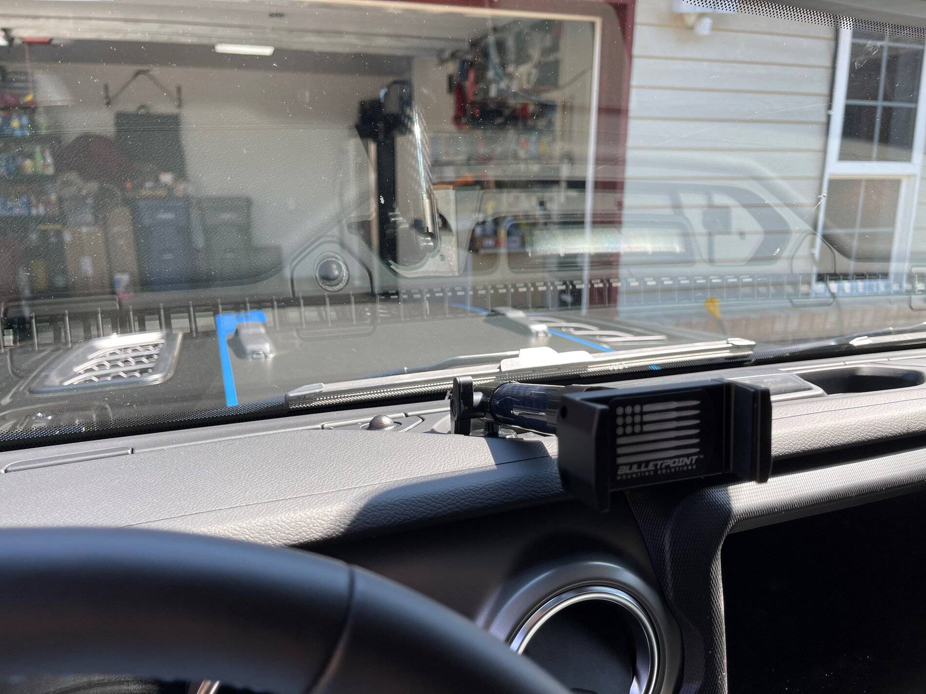

Bulletpoint Phone Mount
Jeep Wrangler JL Lightsout 4xe Build phone 6

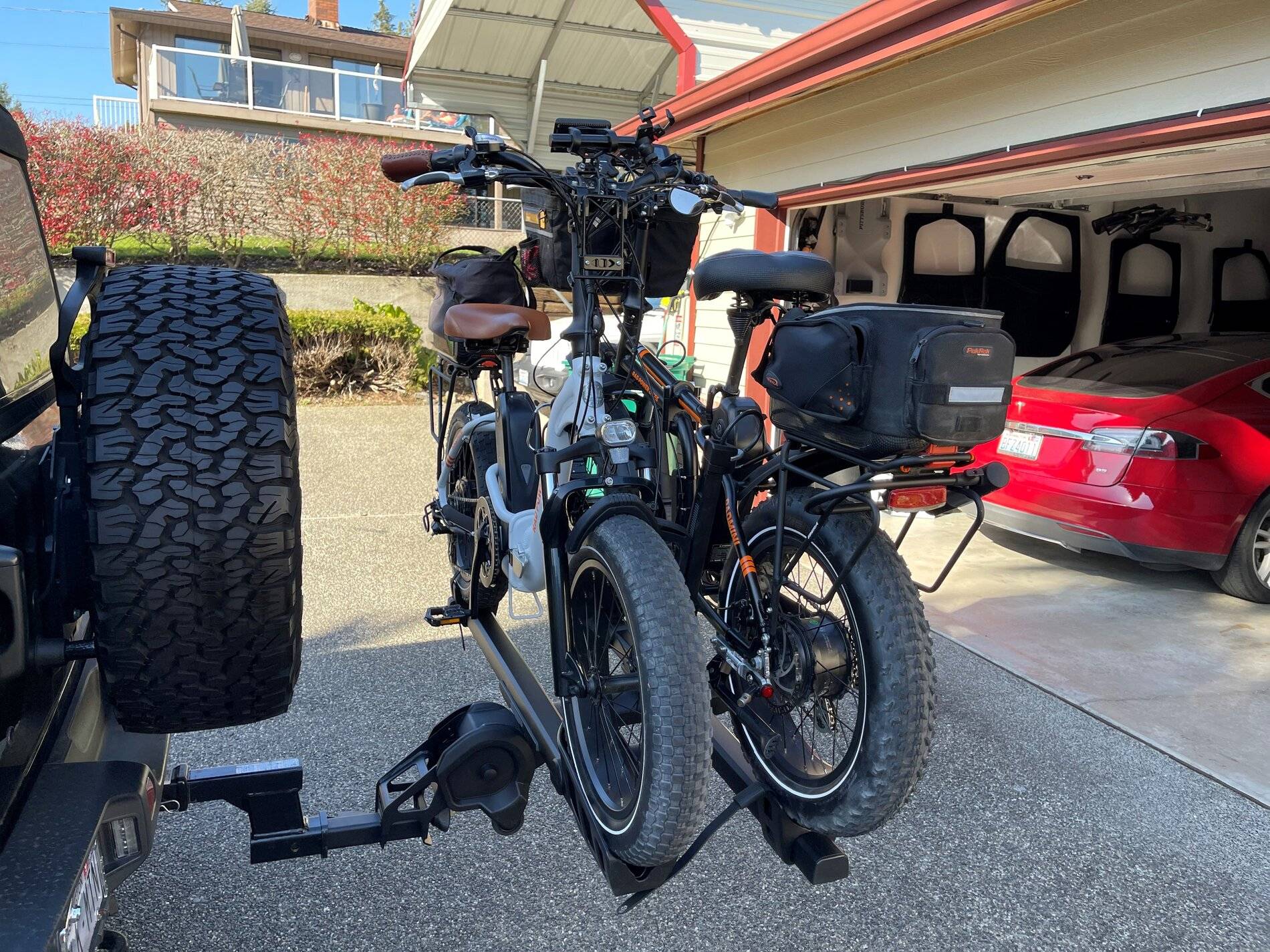

Thule Pro-2 XTR Bike Rack
Jeep Wrangler JL Lightsout 4xe Build side w-bikes
EAG Doors
Jeep Wrangler JL Lightsout 4xe Build EAG doors Top u

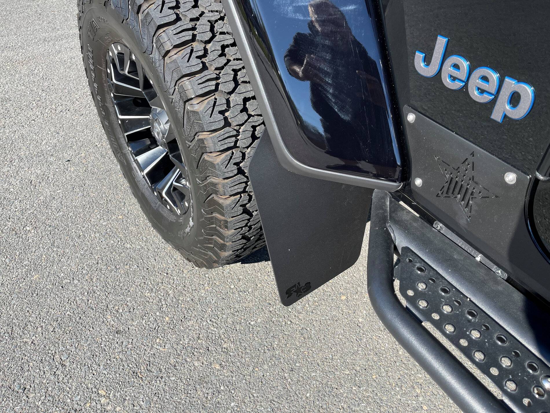

RokBlokz Mud Flaps
Jeep Wrangler JL Lightsout 4xe Build IMG_3098
Jeep Wrangler JL Lightsout 4xe Build IMG_3099
Rough Country 30 LED Bar & Auxbeam 4" Side Shooter LED Cubes
Jeep Wrangler JL Lightsout 4xe Build LED Hood
Jeep Wrangler JL Lightsout 4xe Build cube close

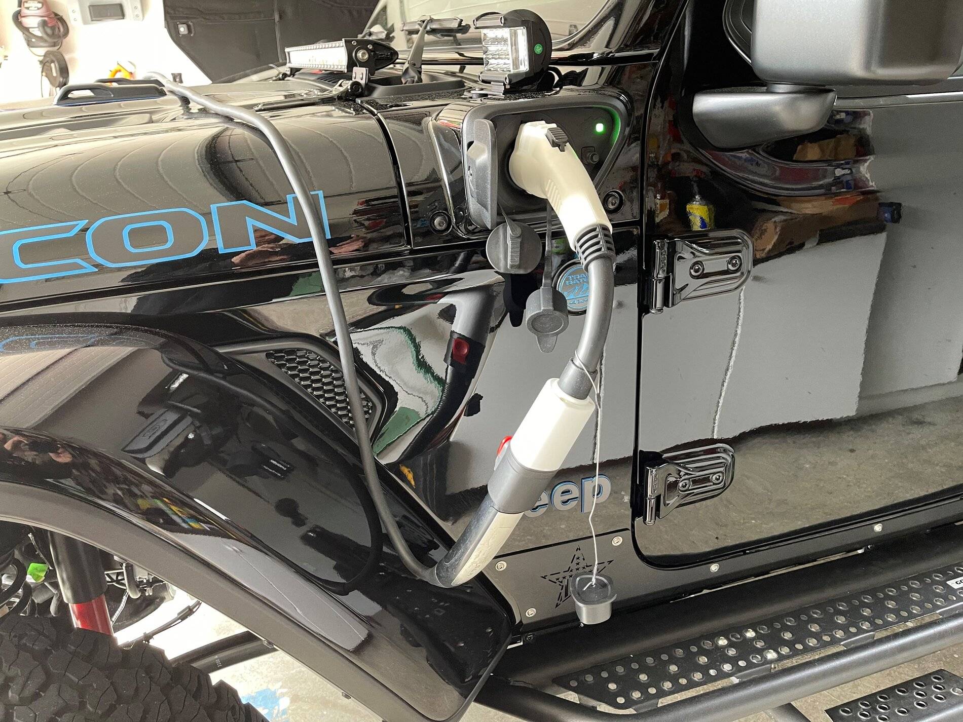

Lectron Tesla to J1772 Charging adapter
Jeep Wrangler JL Lightsout 4xe Build charge 2
Jeep Wrangler JL Lightsout 4xe Build LED Bumper

I see you have a Tesla as well. Do you use an adaptor with a Tesla charger or do you have a different level II charger?
I bought the Lectron Tesla adapter on amazon, they have one on warehouse deals for $119

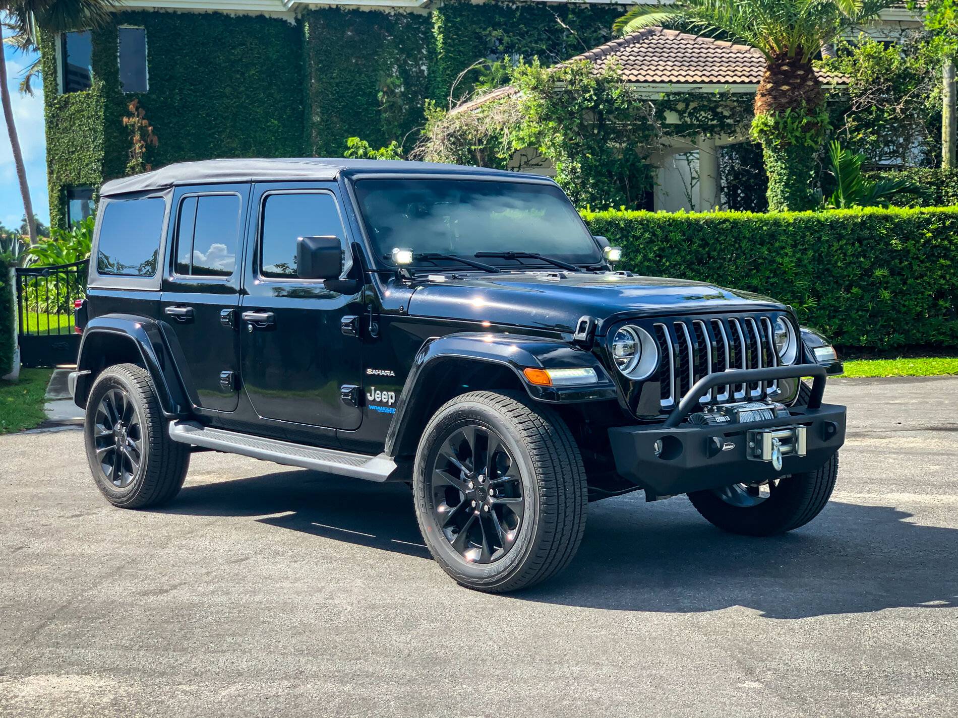

Installed my Quadratec QRC stubby Bumper and badlands 12k winch. As well as my A pillar pods and 4" led cubes. Waiting for my leveling kit and Nitto Terra Grapplers in 295/60/20. The QRC bumper looks good but was over 6 hour install due to not so perfect fitment and the most ass backward fog light installation design I have ever seen. Your build looks awesome. Going for a very OEM+ build on mine, keeping the stock wheels. I took it on some trails stock already and even on the crappy street tires it was very capable.
Jeep Wrangler JL Lightsout 4xe Build IMG_5629-2
