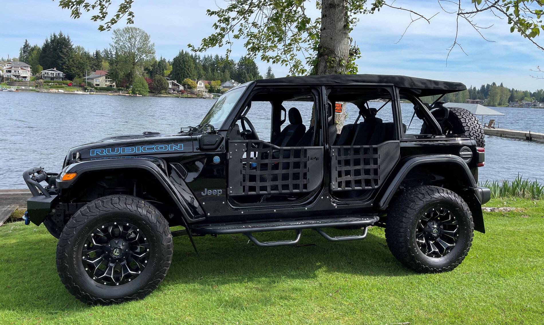

4xe Rubicon stock with 35's will rub at full flex a Sahara will definitely rub well before flex. I would do not less that the Mopar 2" lift for a Sahara which give 3 ". Here is My 4xe Rubicon with 35's and Teraflex 1.5" spacer lift

Perfect height imo for 35's.

Agreed any higher would be too high and make the tires look small . I can even fit 37's on this lift. I damn near pulled the trigger on the Mopar 2" that would have been too high for 35's. I will just add shocks to this. I already did upgraded LCA's and Tackbars and steering stablizer this will serve me just fine.

Should have been clearer - spacer lift on the Rubicon 4xe. So yes - exactly what you did but with stock wheels and 35s!
Looks awesome!
So no rub? I'll have a LOD front and rear bumper and winch so figured it would need the spacer lift at least. Did you do the bump stops or the other things that Teraflex recommends?

I called and talked to Teraflex they said no need for bumpstop risers or shock extensions. Just the spacers. If I was to do it again I might keep the 2" front but do 1" rear (instead of the 1.5") and winch drops the front 1" total rake. I will be toing a utility trailer so that 1/2" rake does work in my favor though.
