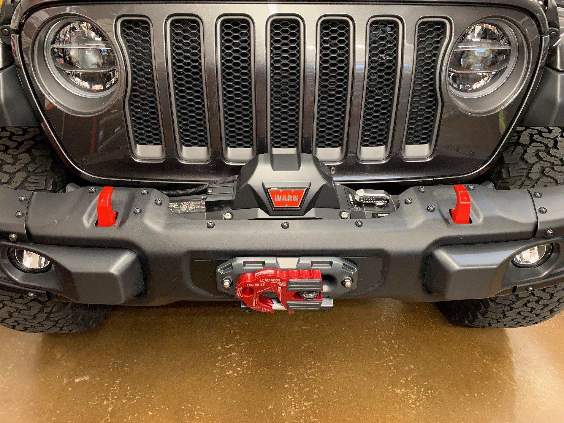

Mine has negative straight to battery, positive to solenoid and solenoid to battery with short one foot run. Solenoid triped by aux switch.
There is a hole already there where bracket was installed, I just put in nutsert and bolted bracket to space it out over factory wiring.
Sidewinder just installed, haven't tried yet.

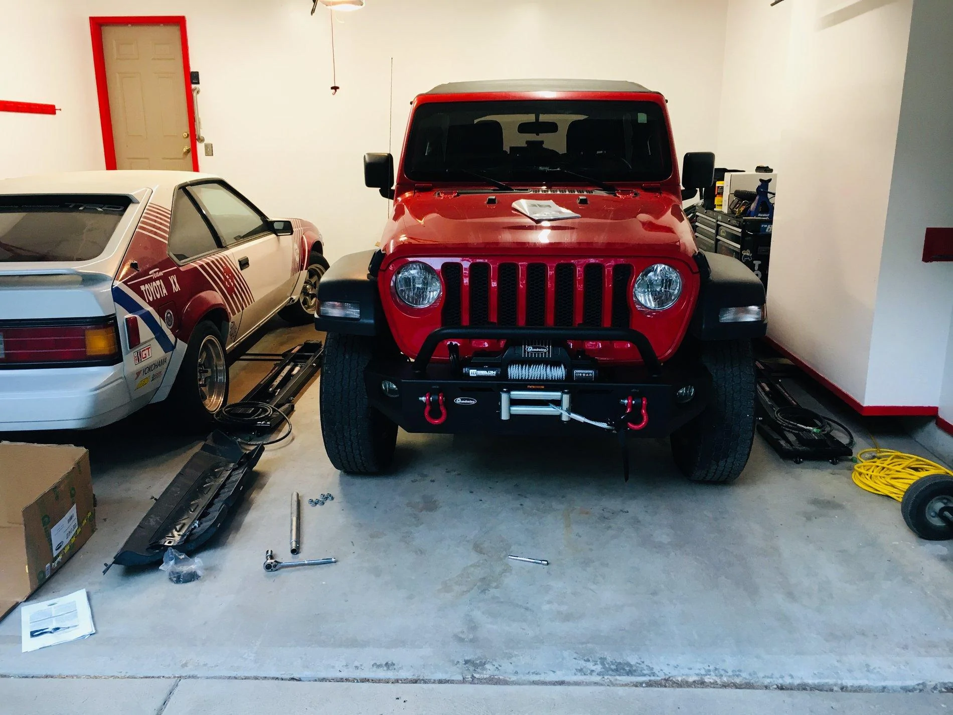

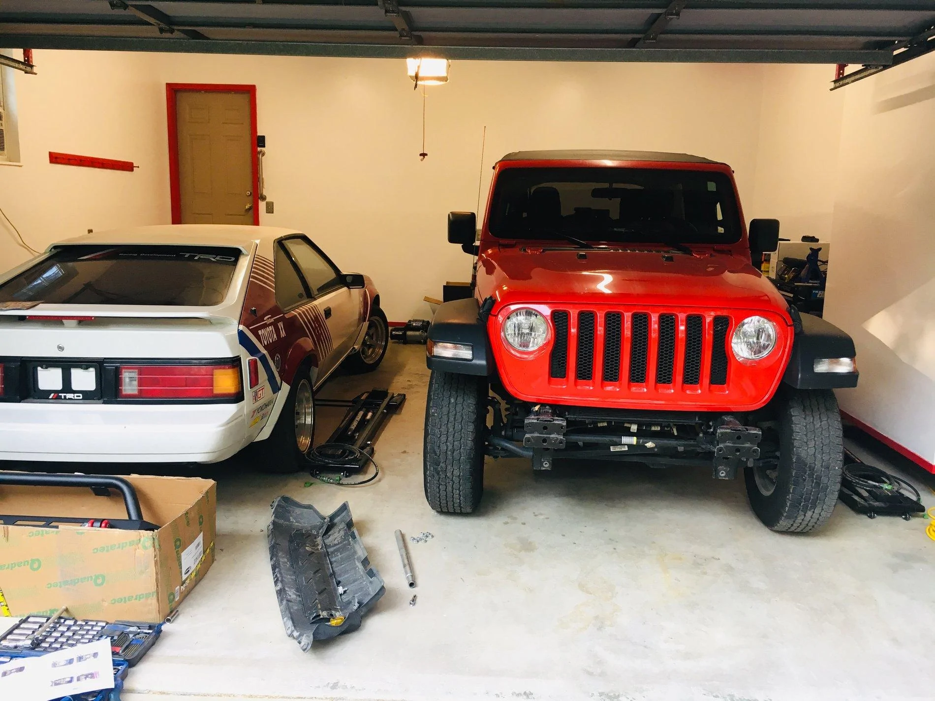

All great advice here. I ended up ordering the Warn solenoid wiring kit to pair with my Q Series winch thanks to a post on here.
I spent an afternoon taking off the factory plastic bumper and putting on a Quadratec stubby bumper.... geez I didn’t realize how... flimsy the plastic bumper was until I took it off!
I bolted the winch onto the bumper and then had someone help me lift the 200+ pound assembly onto the front and bolt it into place. Feels much more substantial.
Haven’t done the wiring yet, but more pics to follow. After getting it wired, I’m taking a day to practice recovering myself out of muddy/ steep terrain. Of course there will be pics and vids posted when that happens!

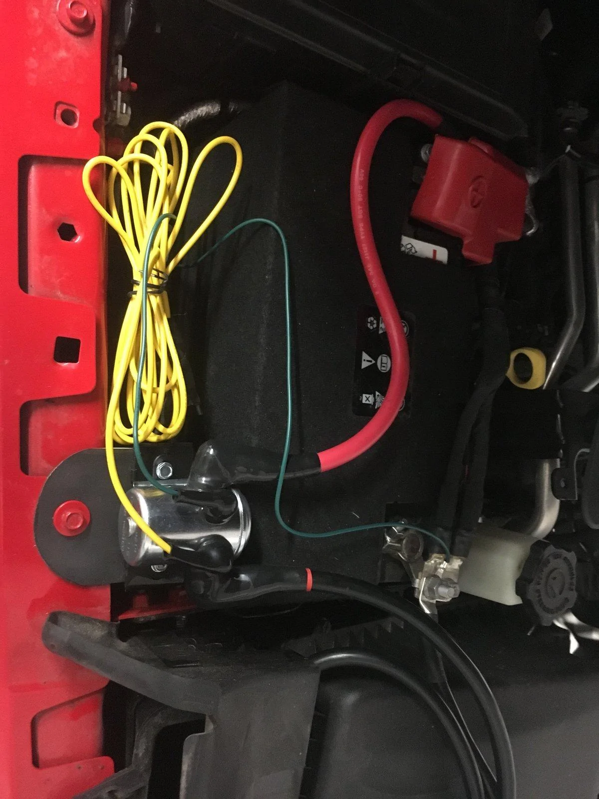

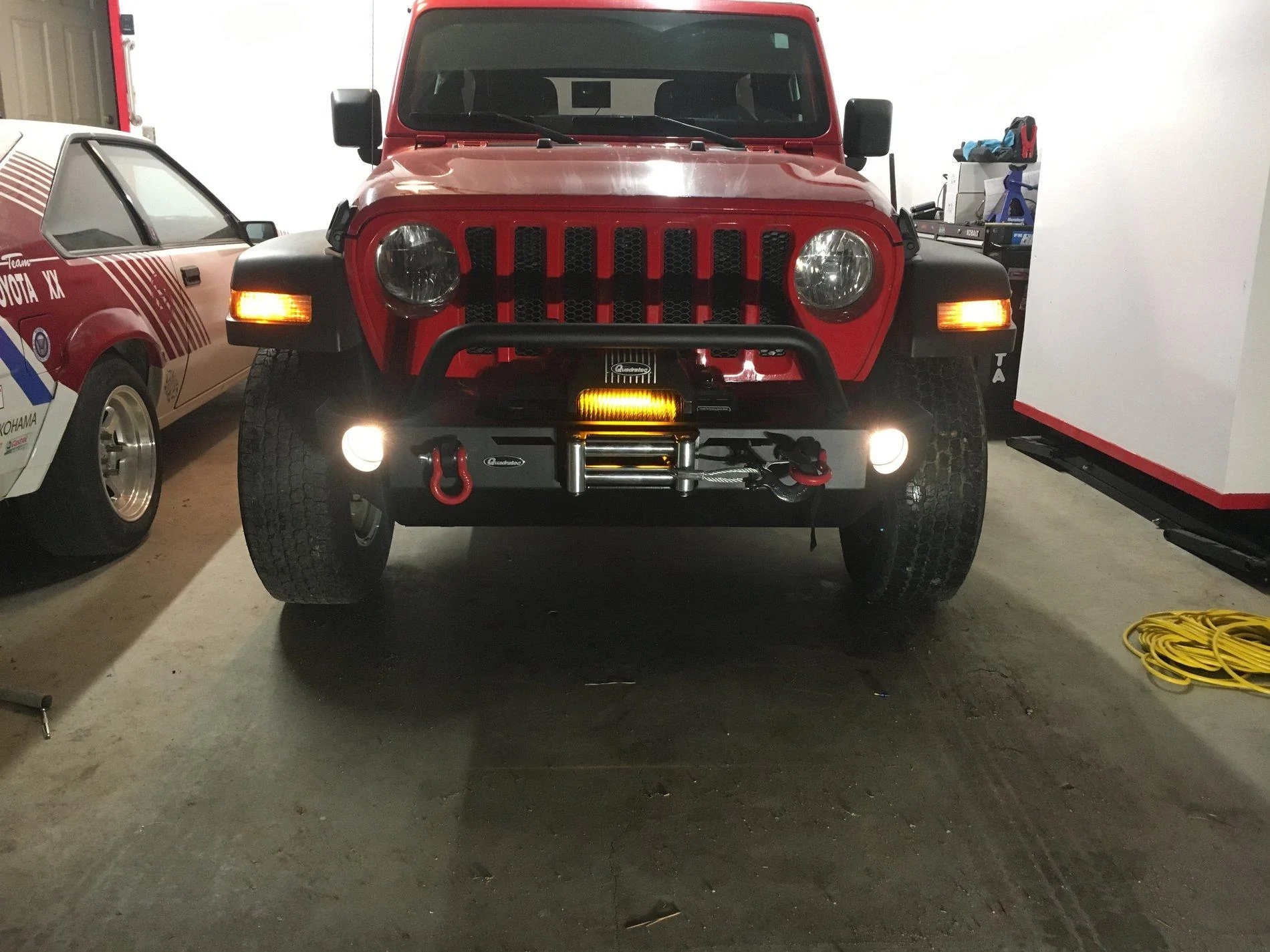

So finally got all things together and finished my install of a Q series Stealth winch. All in all it probably took me about 5~6 hours. Most of that time was spent looking through these forums for the DOs and DO NOT DOs for installing a winch and a power interrupt kit.
I opted to go for a power interrupt kit wired to Aux 1. I did this purely for overkill/ safety so that nobody can use the winch unless the circuit to it is completed by turning on Aux 1. Also I like the idea of a kill switch as I do plan on being off road, and don’t want a big electrical headache if someone rolls into me/ I hit a rock or tree and pinch those cables in the front bumper, creating a short and unleashing hard-to-find electrical demons into this new Jeep :movember:
Also, as a reference, here’s how I wired the solenoid (follow instructions in the kit for which wire connects to where):
Connect positive (+) cable from winch to one large post on the solenoid, it can be either right or left. On the other large post, connect the red heavy gauge wire and then connect the other end to the positive (+) terminal of the main battery.
Connect the green wire to one of the smaller posts (CHECK INSTRUCTIONS FOR WHICH POST, DONT CONNECT IT TO THE WRONG ONE AND SHORT OUT YOUR AUX SWITCHES), and connect the other end to the negative (-) battery terminal on the main battery. Also, connect the negative (-) cable from the winch to the negative (-) main battery terminal.
Lastly, wire in the yellow wire to the remaining small post (AGAIN, MAKE SURE YOU FOLLOW DIRECTIONS ON WHICH SMALL POST TO ATTACH TO) and connect the other end to the coordinating aux switch wire under the hood.
Like others have said, hardest part was finding a way to mount it. I made a small bracket to mount mine on out of scrap steel. I’ll paint it soon, but just wanted to have it finished for now.
Tested mine out tonight, works great! Has a solid, satisfying click when you press Aux 1 and hear the power go to the winch. Time for a celebratory beer :beer::muscle:
