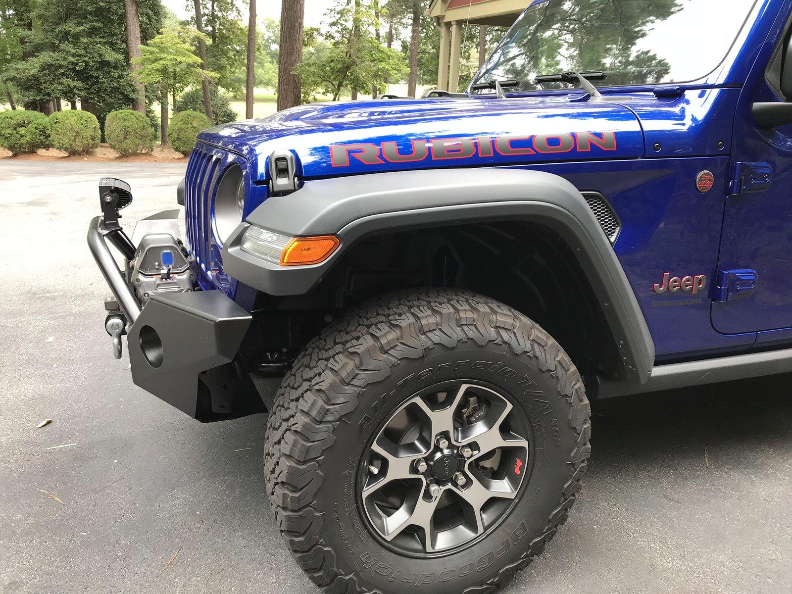

The bumper is a Rock Hard aluminum full width bumper. Made out of 1/4 inch aluminum, very strong, but only weighs about 35 pounds. It is one piece including bumper, winch plate, and skid plate.

Side view of the bumper
