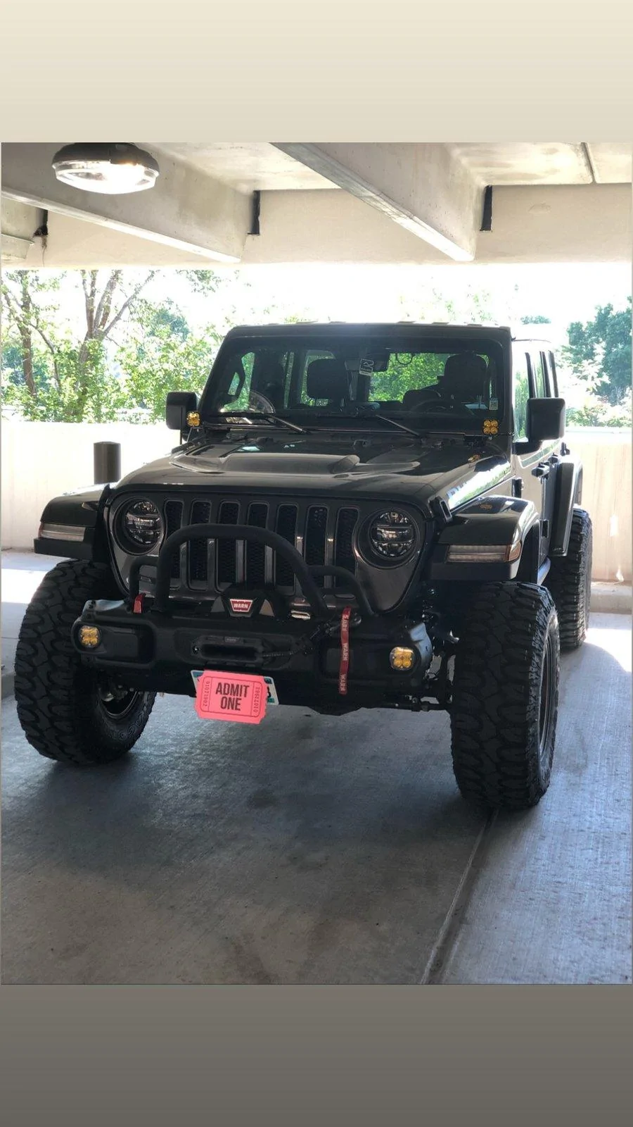

The bumper looks good! I've been eyeballing that one myself. How do you like the fit and finish of it? Also could you post a few more pics of it. I've been trying to find real life pics vs the advertisement ones. Thanks, sorry to hijack your thread.

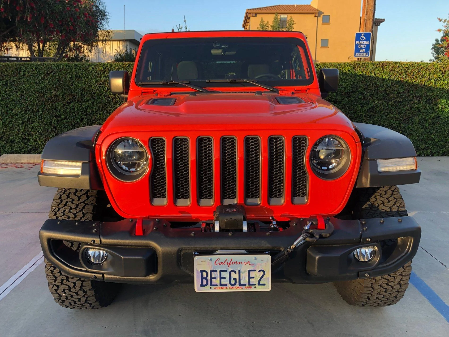

I went with Warn 8K just need to swap out the wire rope for synthetic line. Used Maximus winch plate. Wired directly to battery.

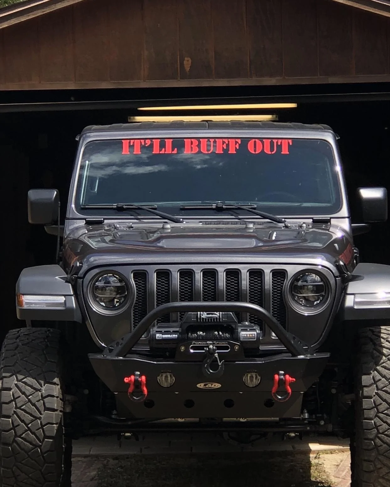

Mine has negative straight to battery, positive to solenoid and solenoid to battery with short one foot run. Solenoid triped by aux switch.
There is a hole already there where bracket was installed, I just put in nutsert and bolted bracket to space it out over factory wiring.
Sidewinder just installed, haven't tried yet.
