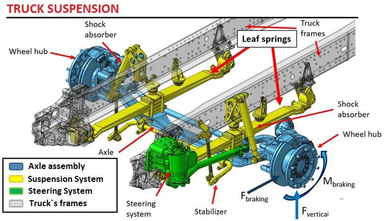

But what is it about their design that makes the damper unnecessary?
I'm not an expert, but I don't think large trucks have a steering damper.
Jeep Wrangler JL Death Wobble - Help! (Solved) truck-suspension-construction
Wolfslash16
Jun 24, 2016
98
99
SLC Utah
'17 JKU Firecracker Recon.
Interesting observation. While I am not an engineer, I believe the main factor on the heavy duty application is that most of them are "behind the knuckle" steering, VS the Jeep and most truck "in front of the knuckle" design. It has to do with how the tires steer in relation to the steering geometry "steer center" and a few other things I don't fully understand. Maybe someone more qualified could chime in if they know what I am on going on about haha.
