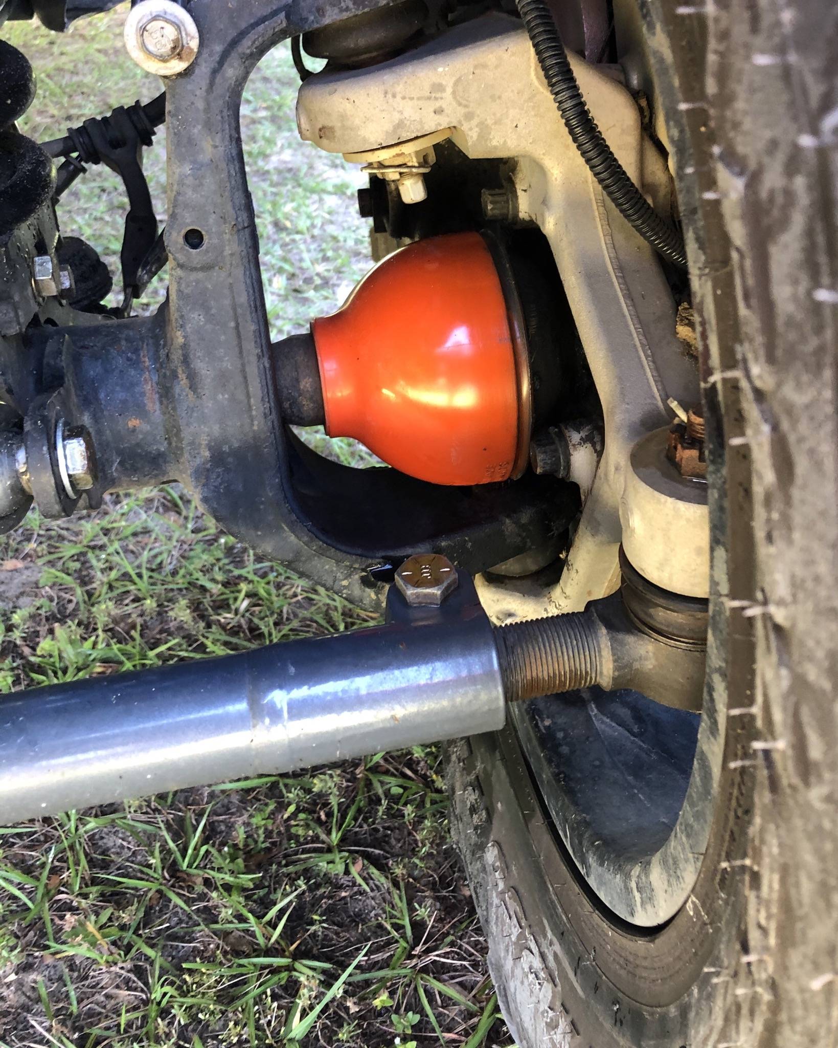

It might be the angle of your pic but your drag link and track bar doesn’t look parallel, this will cause bump steer. This and running without a steering stabilizer could be contributing…… you said you switched axles, is the new axle wider? Your tie rod looks like it’s over extended and the slits in the adjuster sleeve need to be lined with slit in bar as well….

I know you said caster is within spec, but jeep spec is extremely low in my opinion. Do you happen to have the alignment sheet? I'd up caster to at least 6⁰ personally. Hard to tell in the photo but it looks like the drivers side of the tie rod is way more extended than the passengers side, not that I think that would cause death wobble but if there isn't enough thread engagement on that side it could be flexing there? I've yet to get a JL dialed in enough to run without a stabilizer but it should be possible.

Are you missing a jam nut on the driver side tie rod? Never seen one like that. What keeps that rod end tight?

Where is the nut for your tierod end?
There isn’t one on driver’s side, unless they’ve changed. I ran this tie rod for couple years…it worked great but on Rubi axles it got adjusted to the limit of its spec….takes a minute to get it right…..
I see it now, though the castle nut in your photo looks a little short for that cotter pin to stop it from backing off, from what I see in the photo.
Nah, it was rock solid…. I’ve since gone to aluminum, but I can’t say anything bad about that synergy tie rod, served me well…..
