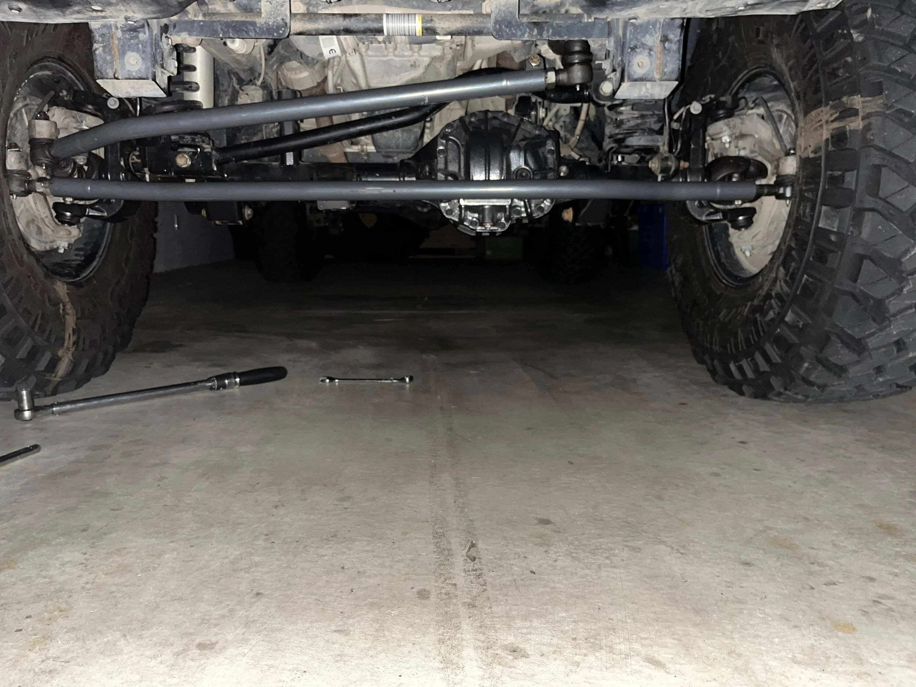

Here is a photo of the front end.

Since you had the wobble in the old axle and you've changed most things, I'd take a closer look at whatever is left and alignment. Since you've had DW for some time, I'd check the wheel hubs and the mounting points on the aluminum knuckles for deformation/wear. BTW, for the frame side track bar mount I meant the actual frame mount. I see yours is a 2018 and they were known to fail at the welds. You can also check your steering box mounting bolts to be tight (those were also update with higher torque numbers and stronger bolts. You really need someone to play with the wheel while you check everything
