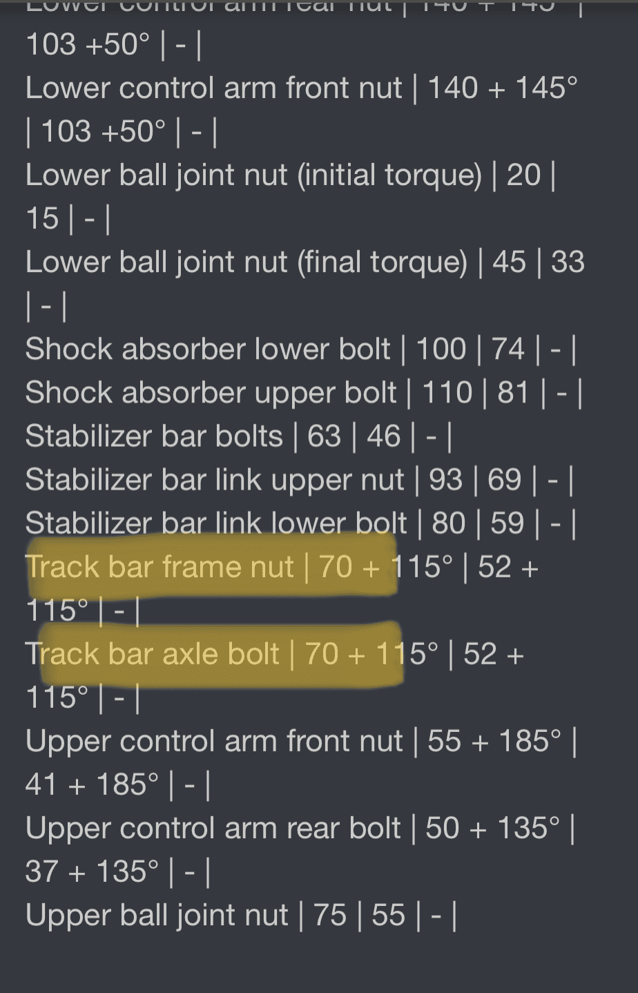

Wasn’t the TB torque supposed to be at 180#?

Metalcloak and OEM both state 110# for bolts on frame and axle. Unless you're talking about the lock nut? Which was tightened down well above that. My torque wrench only goes up to 150# and I tightened the lock nut down at least that much.

110 seemed low but I see it in the mopar lift instructions.
Found this on here.
it does seem like it’s related to something you’ve changed recently. Frustrating for sure.

I think i was thinking the control arm mounts.
