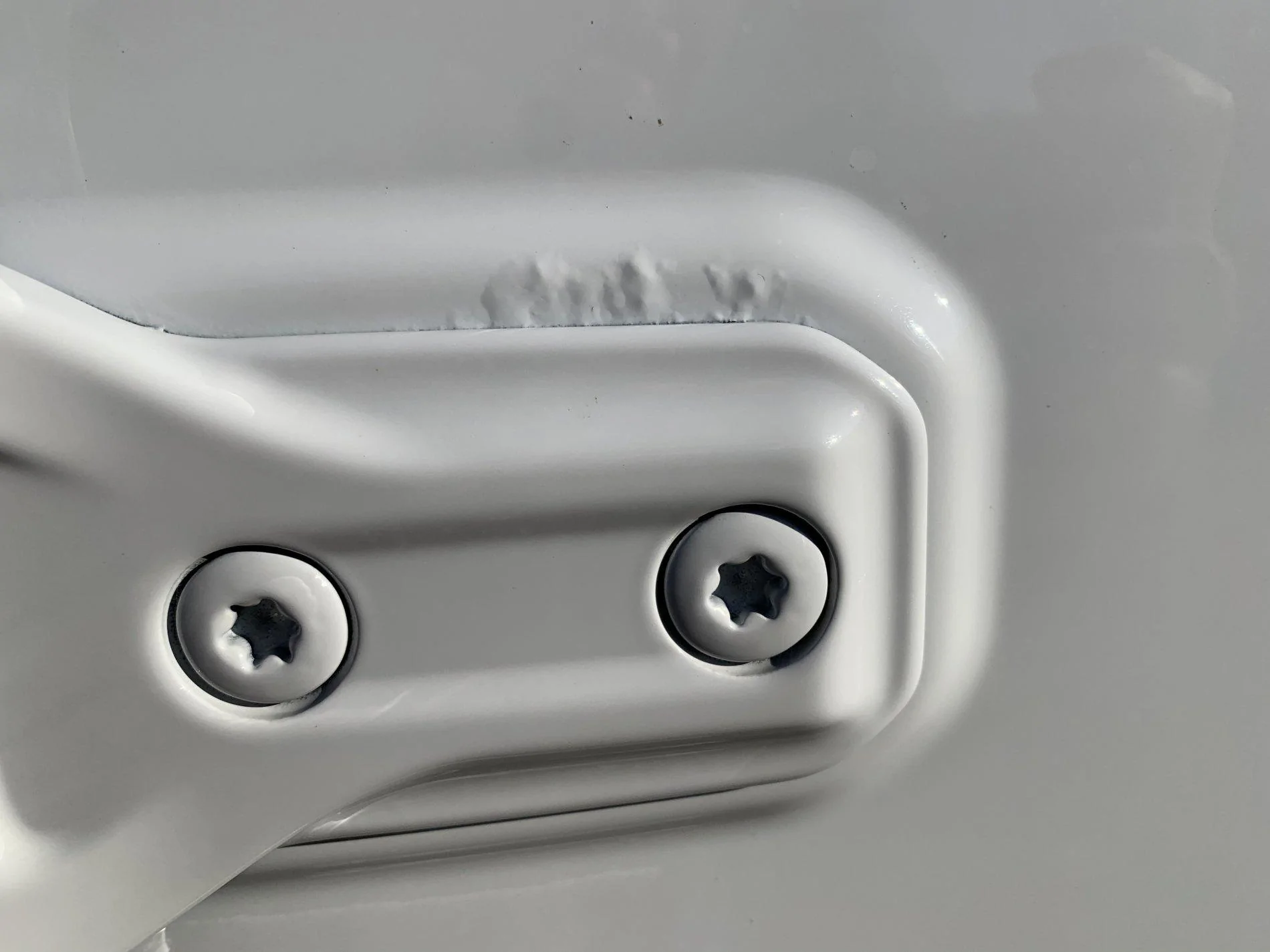

Just drove by the lot and saw mine got back from paint. I asked them to order new bolts and paint the doors after they were mounted and primered so the hinges didn’t look like garbage. You can tell they listened :(

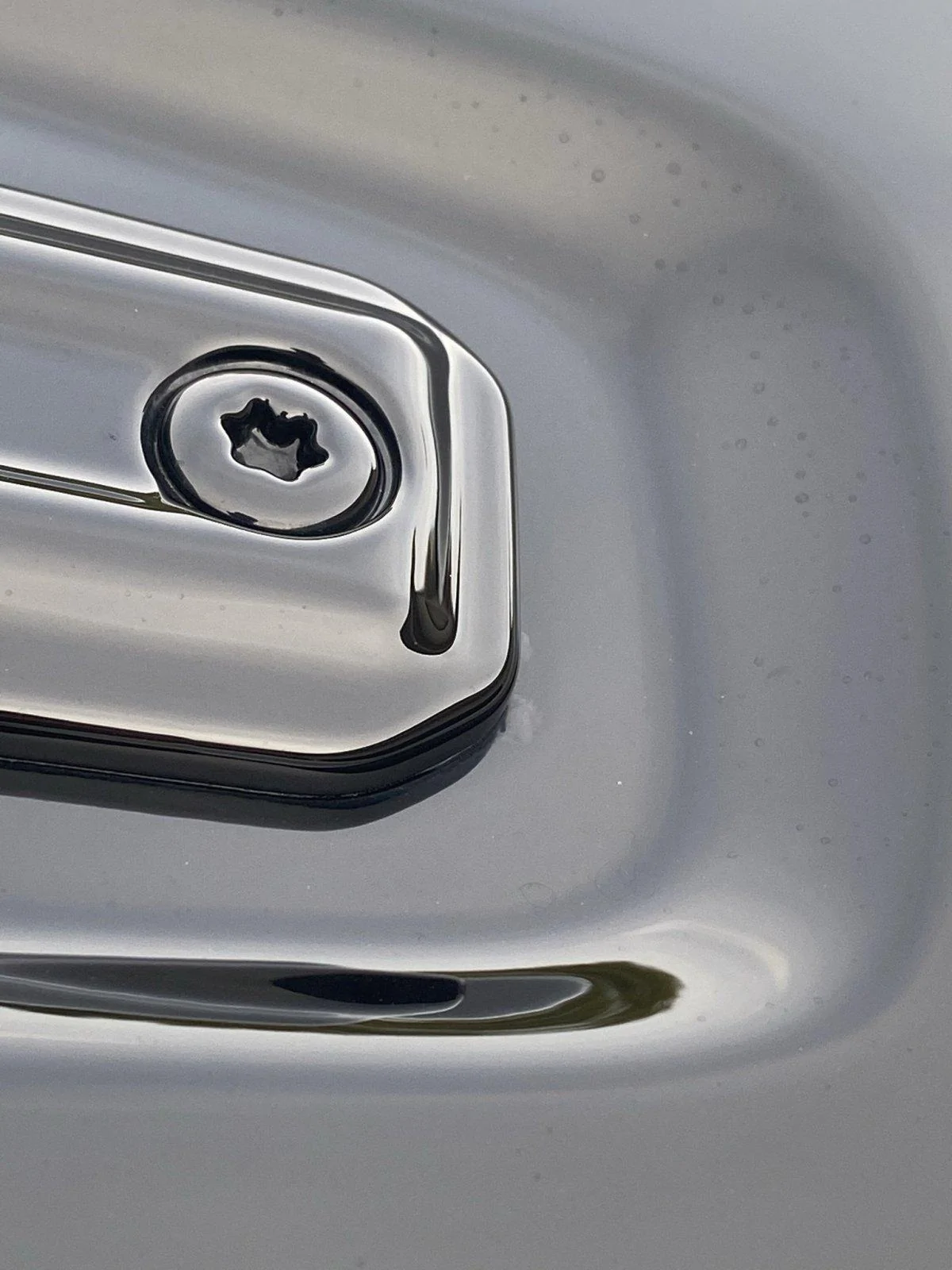

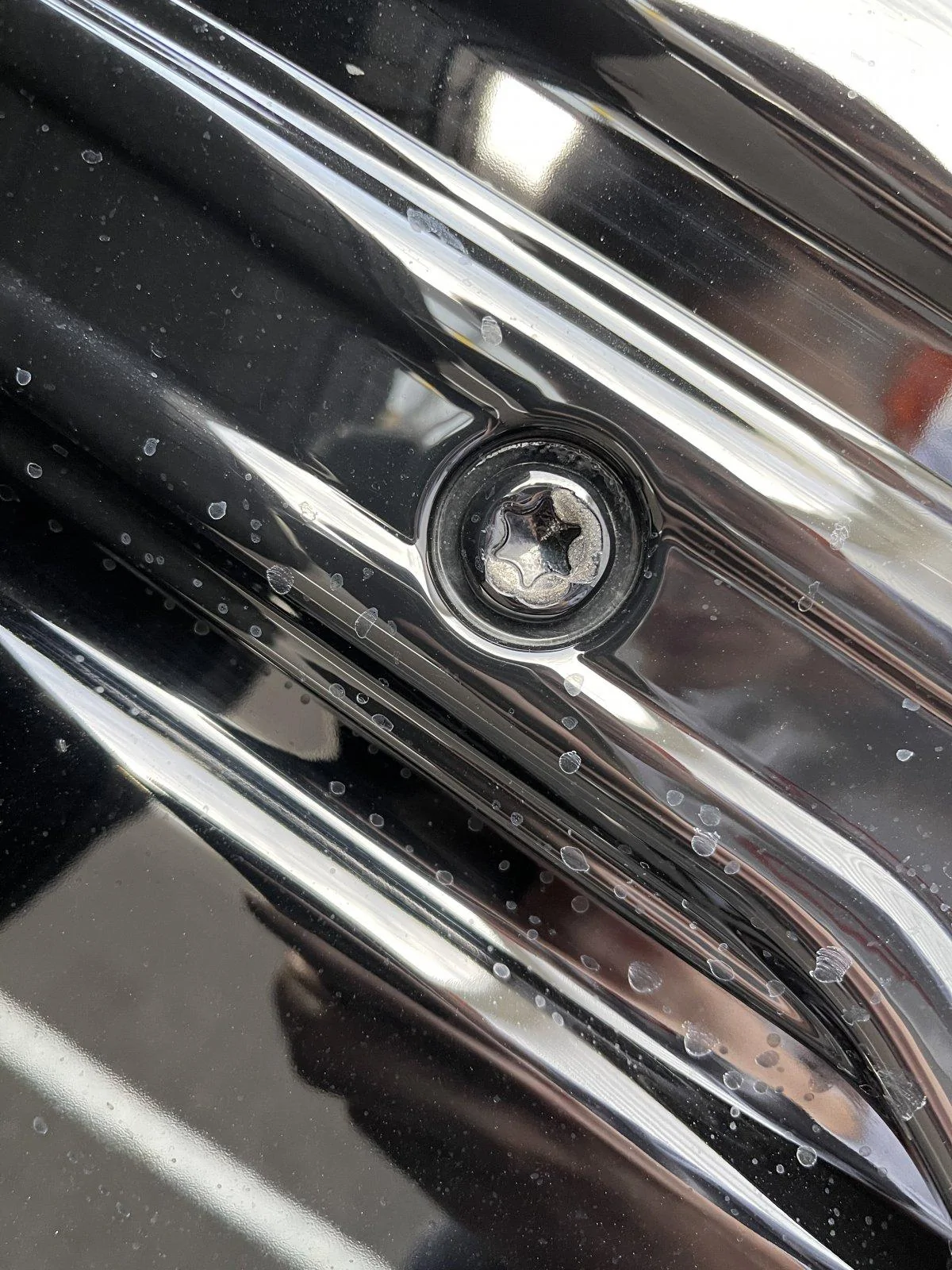

Body shop I went to actually made the car look 10x worse

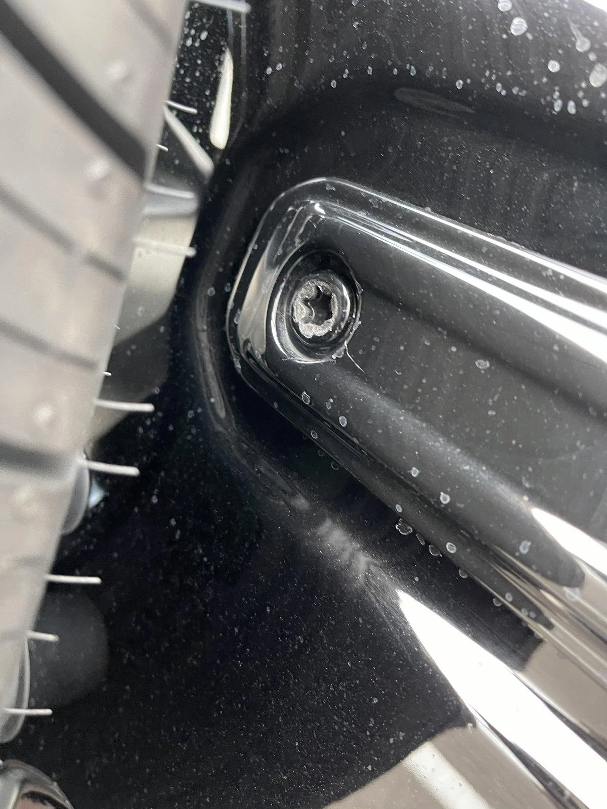

Does anyone know what the warranty is on this? I just purchased my first Jeep 2 weeks ago. 2018 Jeep Wrangler Unlimited Rubicon with 46,000 miles and noticed that all the hinges have this issue. I’m hoping that this is still covered.
I think corrosion is covered for 5yrs/Unlimited miles for the external body panels.

I think it's 5yrs/Unlimited miles for the external body panels.
Yep, 5 years unlimited miles per attached, section 2.2, C, second bullet point.
