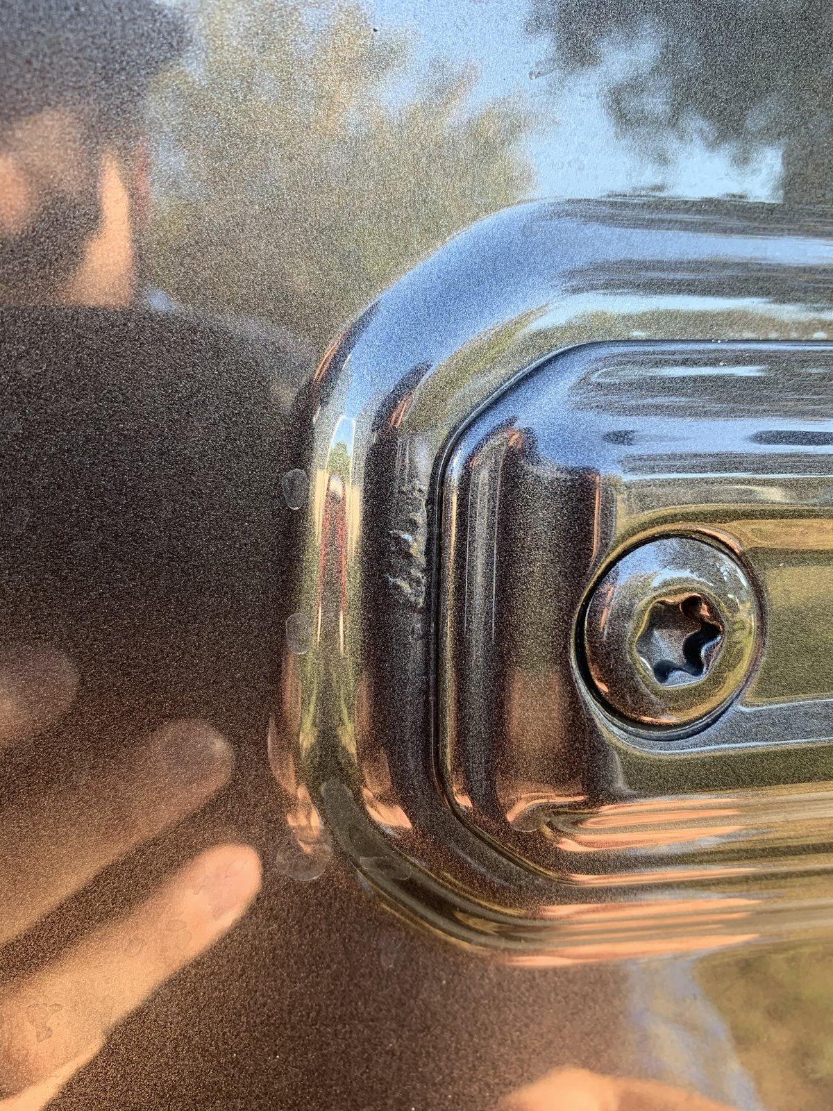

Here’s mine. I wonder how does the dealer preps the aluminium prior painting, to ensure that it doesn’t reoccur???
I wonder if installing Derlin hinge bushings would break the conductivity thus reducing the corrosion/ oxidation???
