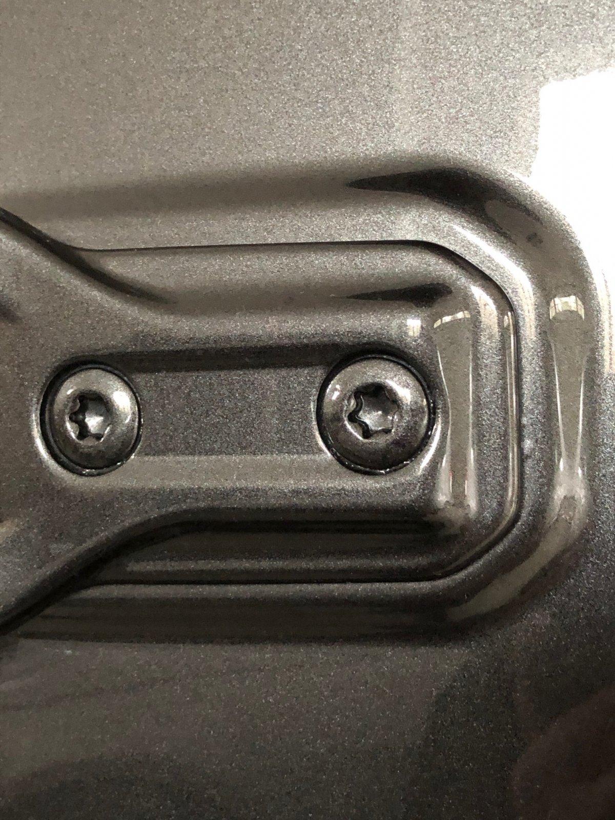

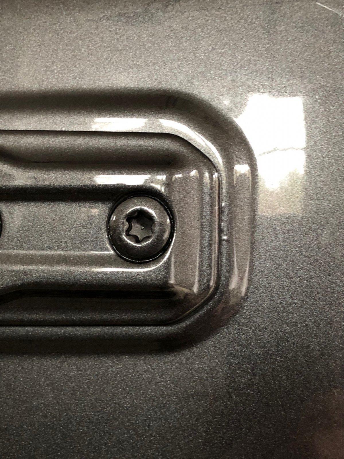

Sadly I must now add my rig to this list. Granite Chrystal JLUR w/ 10/18 mfg date, 22K miles, wheeled regularly this year in New England woods, driven daily, garaged every night, power washed (not soap washed) after wheeling and snow/rain just to keep my eyes on issues like this.
I hope I caught it early as only two door hinges are showing signs of bubbling. And even though it's still under warranty, I have little to no interest in having my dealer repaint the doors as this does not solve the problem. Instead, I am planning to remove the hinges on each door [and possible the hood] to clean up the affected door/hinge and apply some form of film/coating sandwich between the dissimilar metals.
Need to research galvanic corrosion a bit further. Bummer.

It's the contamination under the paint that's causing the blistering . FCAU has a cleaning preparation process issue. It's not only Jeep it's on their cars and trucks also. FCAU has a TSB out on the affected vehicles . So my point is taking your hinges off and cleaning the surface is not going to stop the problem.
Got it. Door skins and hinges are aluminum. Bolts are steel, connected to door inner steel structure. Guess we get to live with this for life of rig
