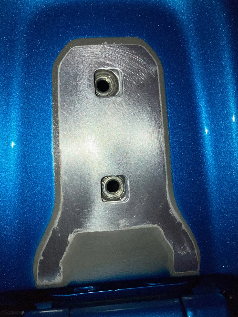

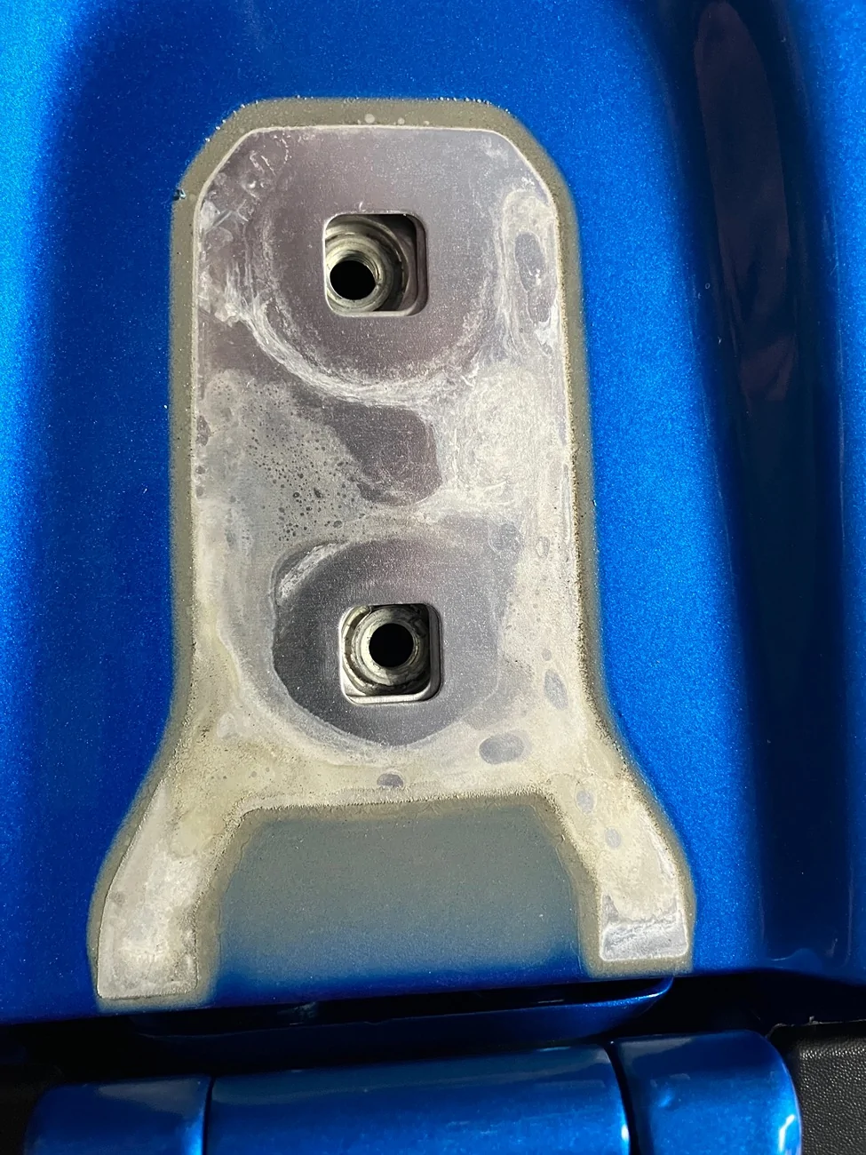

I agree with your statement concerning the bolts being steel, but stand by my assessment that the cause of corrosion is not galvanic, but simple aluminum oxidation. But we can disagree on that point, since there is likely no way to determine the actual culprit. I will say that when I removed and replaced my hinges there was no evidence of galvanic corrosion at the steel aluminum interfaces, and no evidence of corrosion on the steel bolts. While there was plenty of aluminum oxidation creeping into the seams. However, I will admit to applying a generous amount of marine grade antioxidant grease to the bolts during reassembly
