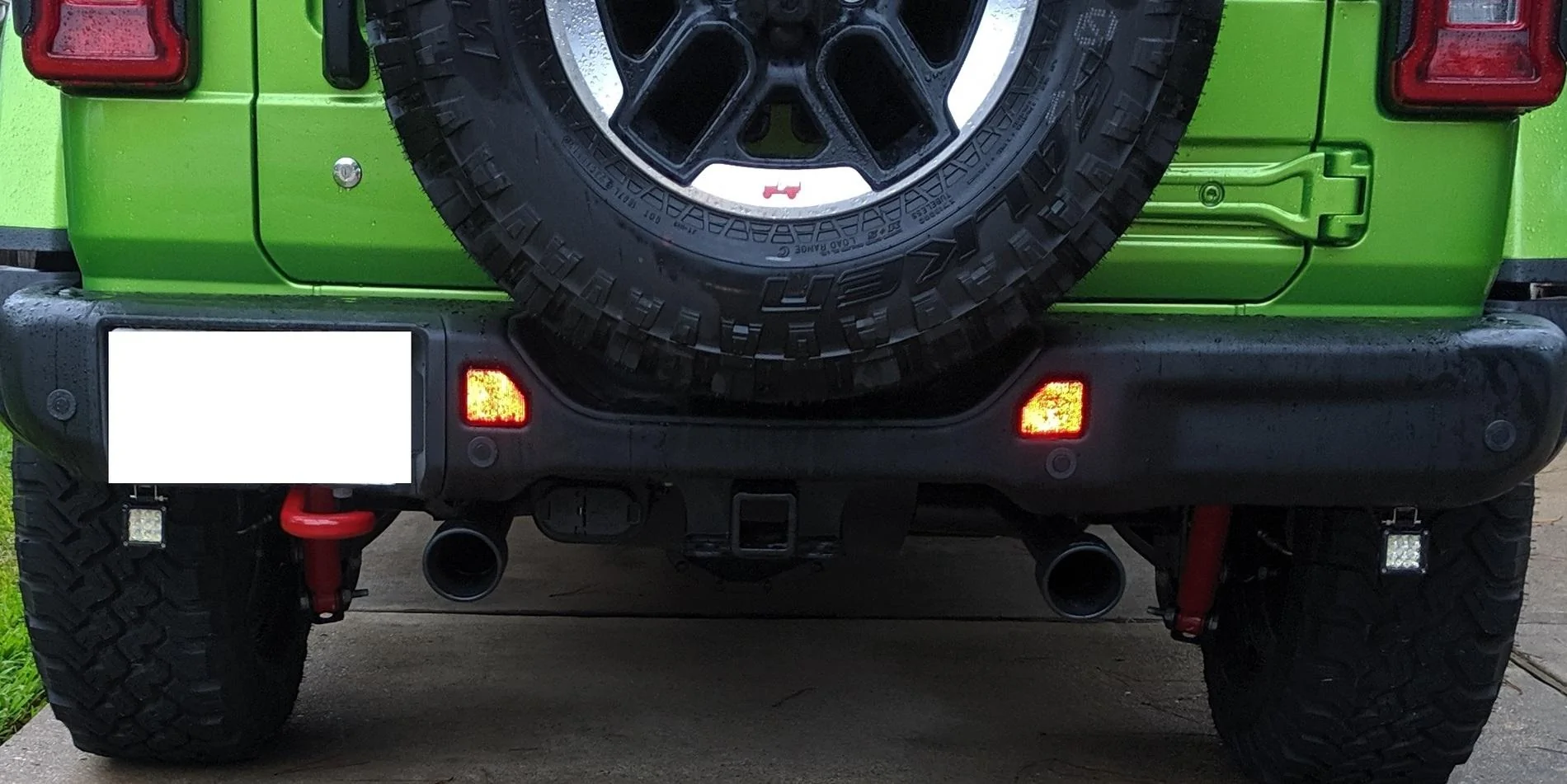

The bumper-reflector back up lights are a very elegant solution. You installing them into the plastic bumpers?
#Rhinebeck01...Curious, what don't you like about the Oracle reflector lights?
I am installing them in the steel bumpers. I haven’t had a chance to install them yet so I don’t have any feedback yet on the product.
