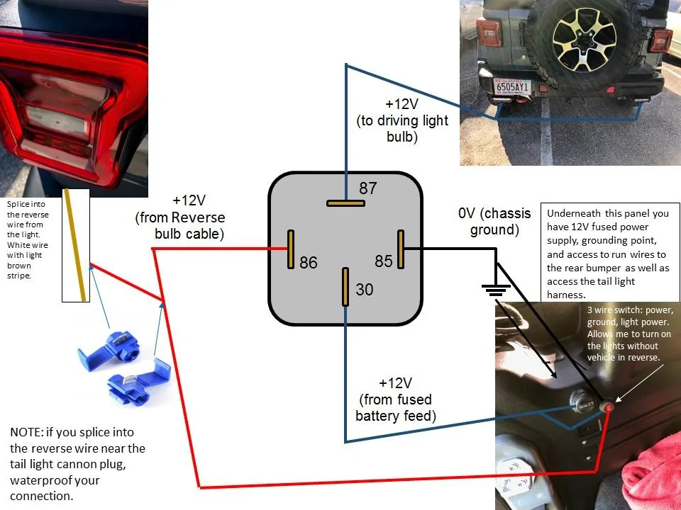

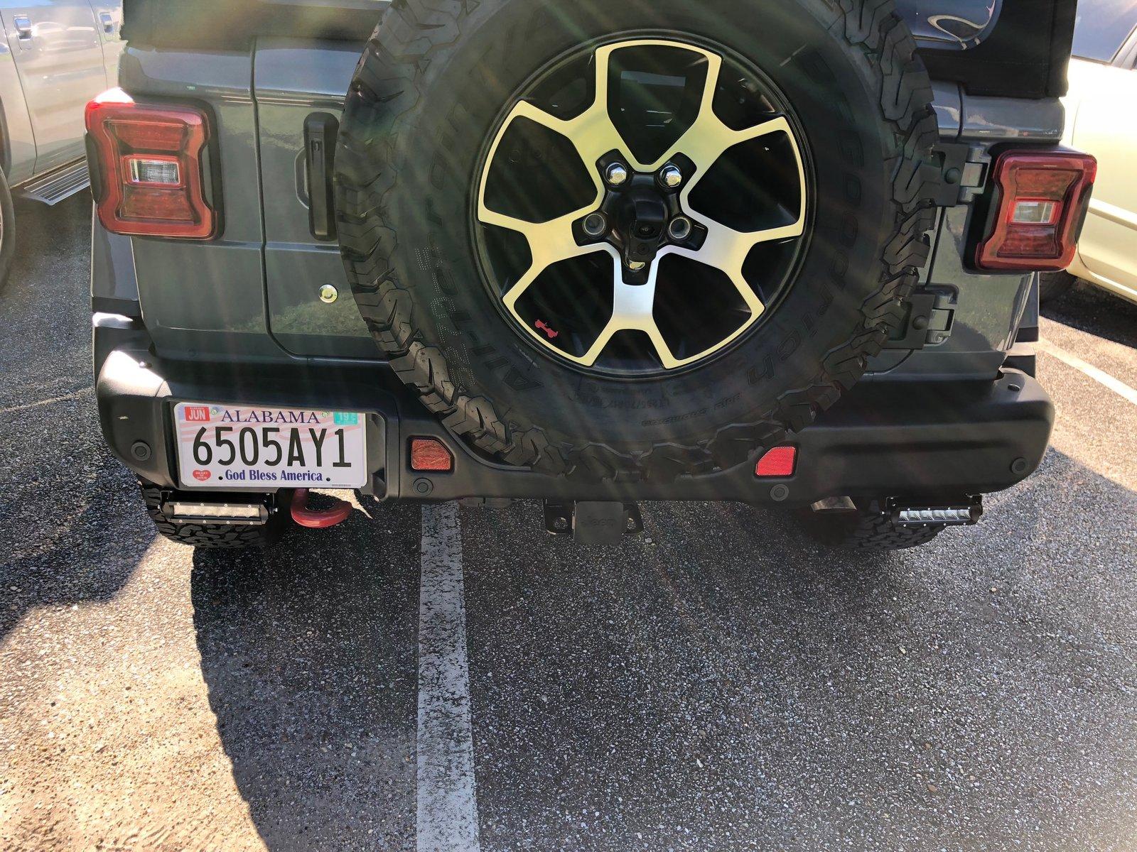

OK, so I went a simple and inexpensive way to increase my reverse lighting. I can take better pictures of the lights themselves, but this is to help with the wiring more than anything. There's lots of ways to do this, this was easy and cheap for me and works perfectly. The wiring kit I purchased was from Amazon for $9.99, it's the MICTUNING MIC-B1002 LED Light Bar Wiring Harness and $29.99 for the LED Light Bar, Northpole Light 2x 7" 30W CREE Single Row Flood. Hope this helps some of you.

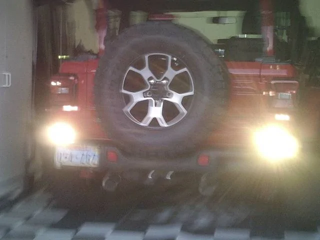

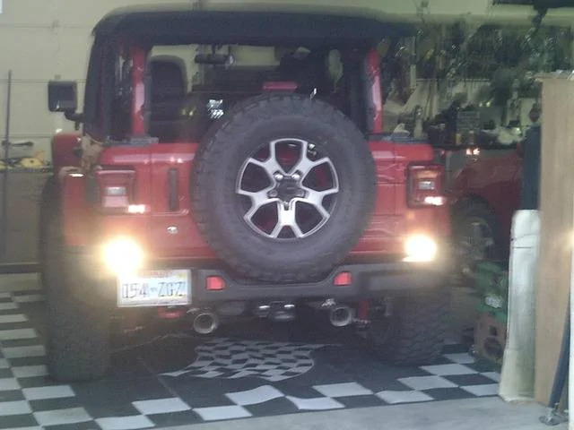

@JIMBOX do you have a picture of the screen while on reverse showing the lighting? I’m asking because I did a similar set up and if I look on the mirrors I have great lighting. If I stand behind the Jeep, great lighting but on the screen it shows really bright spots (more like spot lights) that blind the rest of the screen. I’ll try to take a picture later. But I’m not happy with the view on the screen. It’s like the wide angle lens of the camera distorts the light. Just want to know if it’s the kind of lamp or the camera.
Here is photo of my install and screen shots on my 8.4 screen. See attached file.
