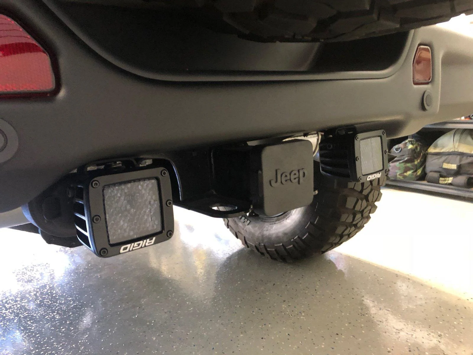

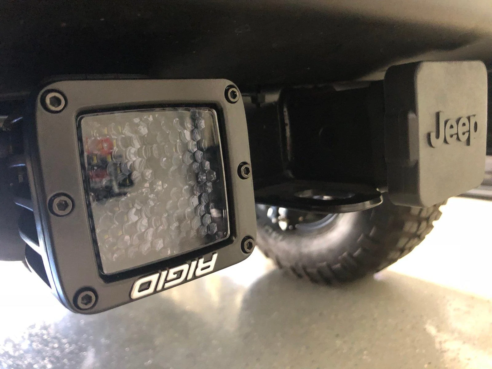

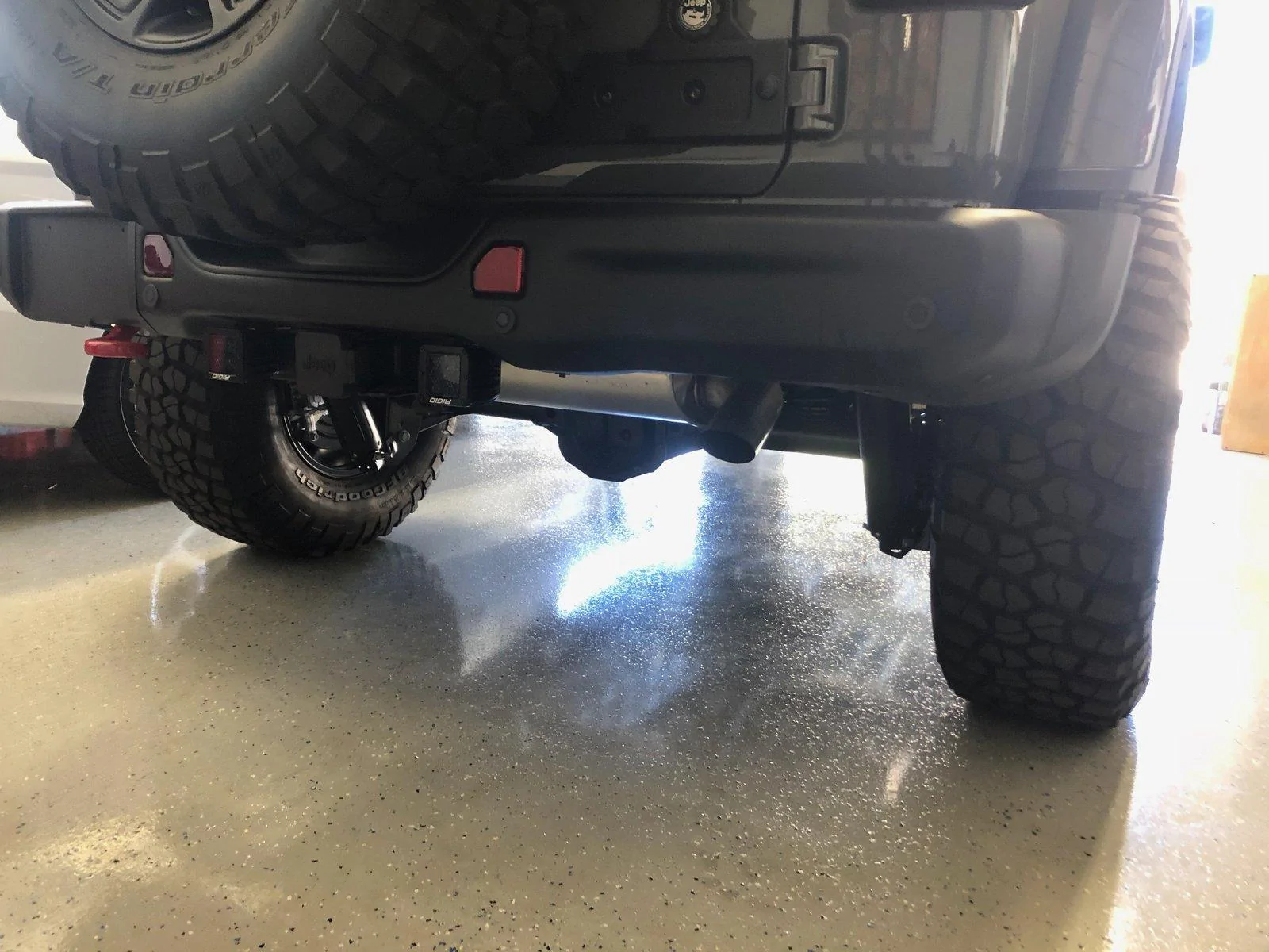

Just added on Rigid Diffused Spot midnight cubes on the bottom of the bumper as a reverse light, I don't tow much so not worried about blocking the connectors. Wired them straight into the tow hitch wiring tucked up in the bumper (orange/white and black wires), works perfectly when shifting into reverse they come on.
Didn't want to modify the bumper at all for now. There seem to be some other mounting points under the bumper that might move them outward which would also free up the tow connectors. For now, pretty happy with how these turned out.

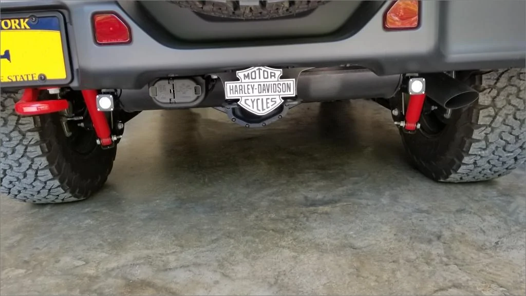

Not liking the way you put that LED in front of the 4/7 pin connector box.... Lights look decent but no way would I have mounted like you did. Paint that shiney can hanging down in the back... 8-)
You could have gone with the Rigid b/u light kit, as I did and not had that issue. I did no drilling. I used two existing fasteners under the bumper. I wired mine in like you did but also have wired to Aux 3 so I can turn on anytime also.
The Rigids I have put out more light then I know what to so with.. 8-)

Yeah like I had mentioned I have no use for the connector. I don’t tow. If I use the hitch it’s more for a bike rack etc. I saw your mounting points they just sit a bit lower and i wanted these tucked up as high as possible. There’s a couple more bolts further back in that might work I might give them a shot.
Went with the duallys over the reverse kit because I want the midnight blacked out lights because I like the look and i want them to match the rest of my lights on the JL which are all midnight edition. I think they’re pretty similar on output the duallys are just a bit more but both are obviously more than enough for reverse lights as you said.
