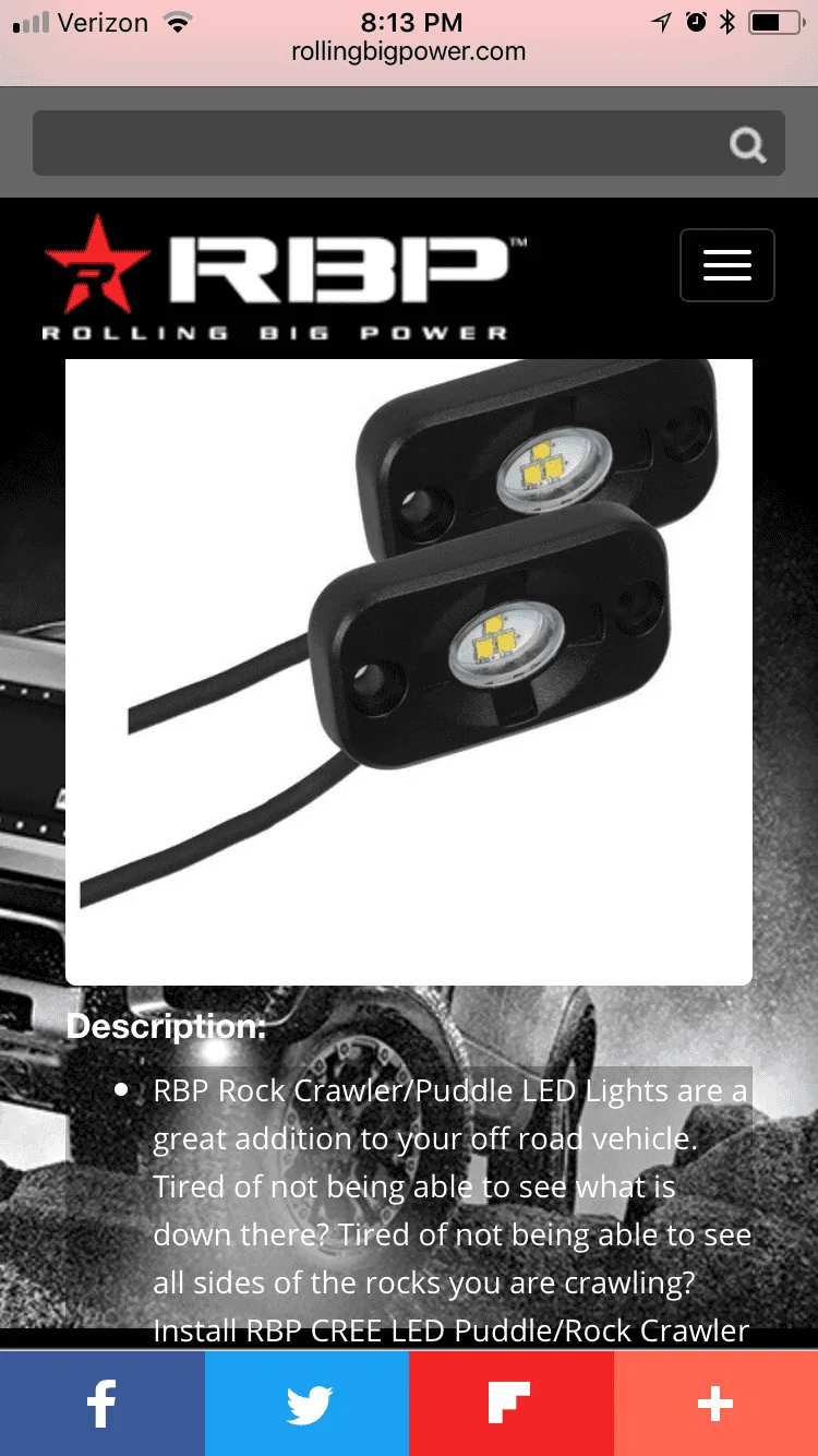

Saw these today at auto zone and was thinking that you could maybe do the same thing and I think it was $49 for both of them. I’m with everyone else there needs to be something
