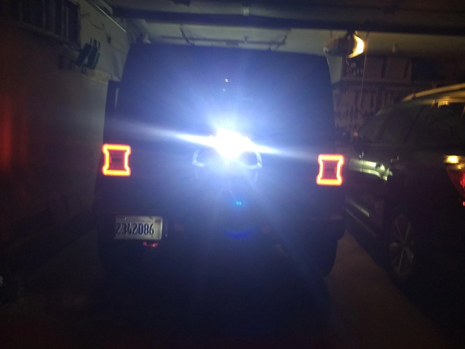

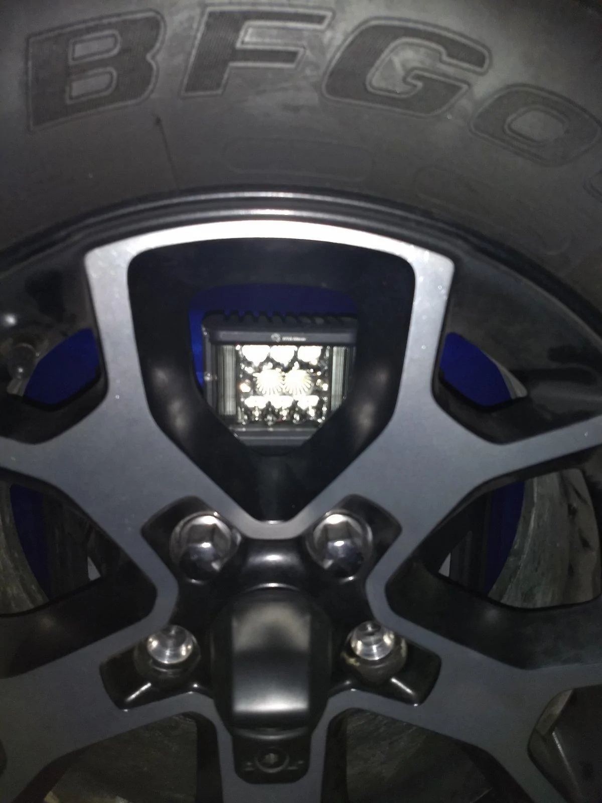

I saw someone considering installing a light in the spare tire. I found a light on Amazon and it has both red and white lights. So I wired the brake light to the red light and the standard light to a switch up front. I am really happy with the results. It is nice up and out of the way, well hidden and I do not have to worry about it getting torn up on the trail.

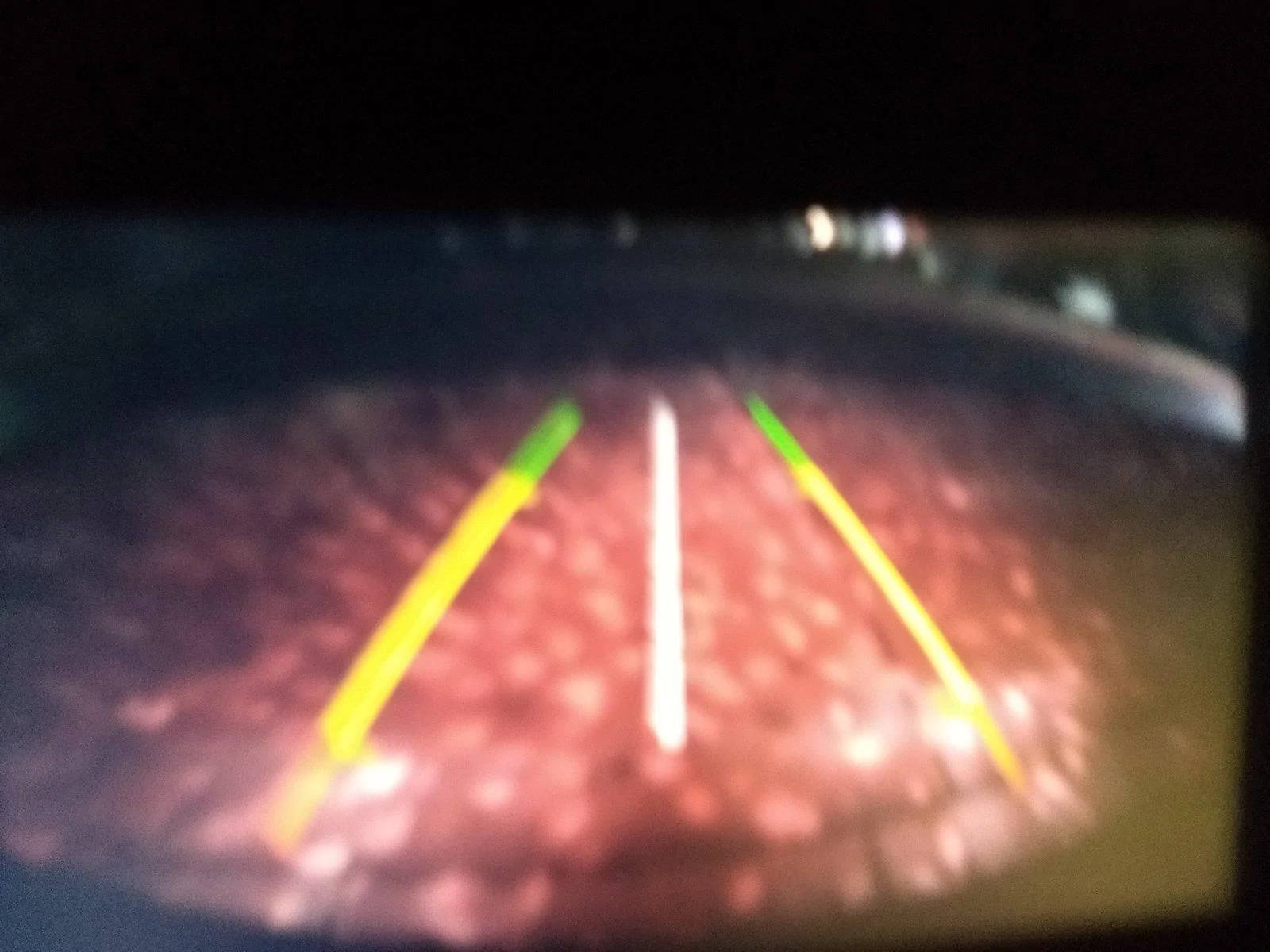

This picture is the standard lights when brakes are not on and the Jeep was in reverse.

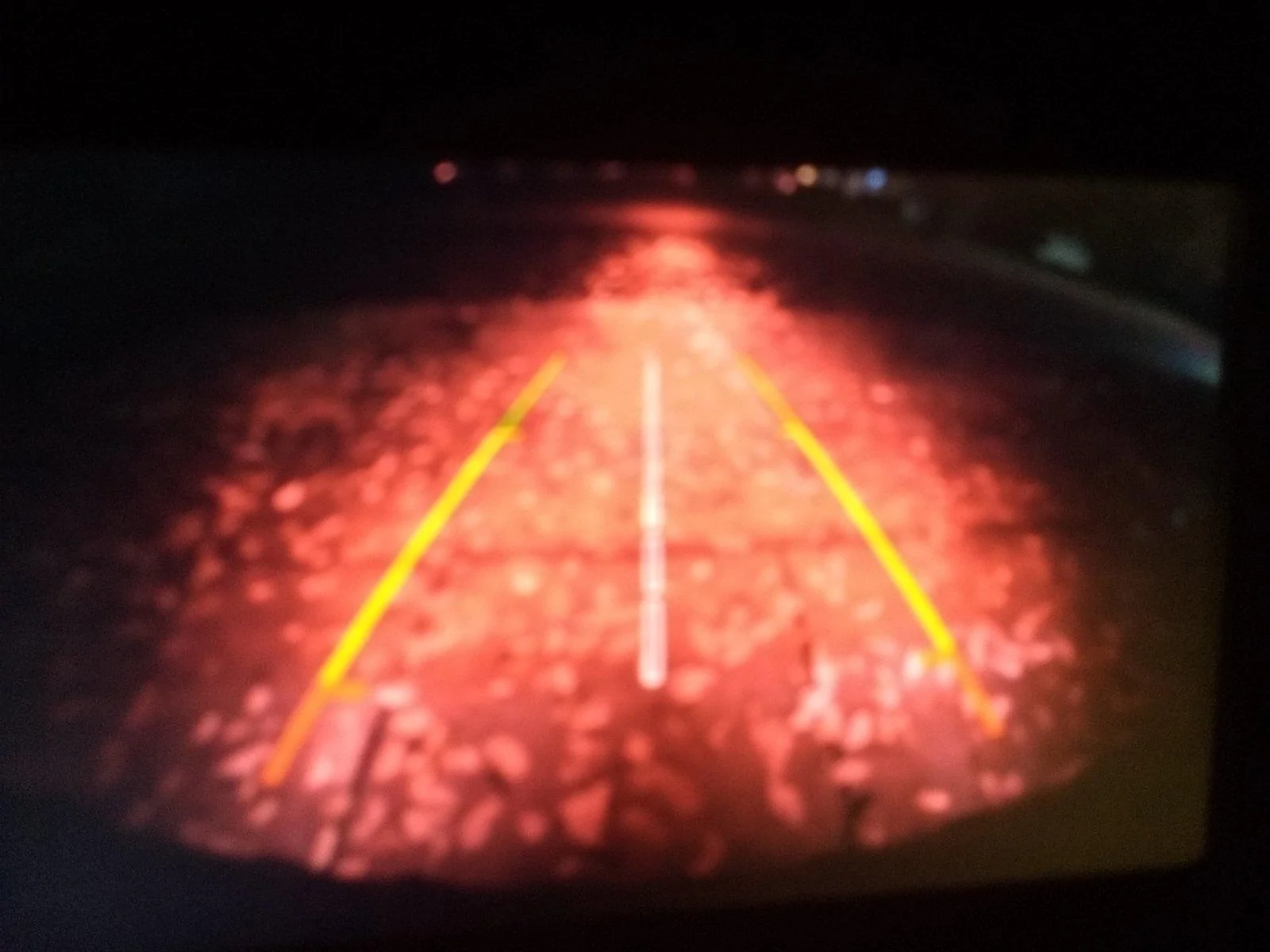

This one is when the brake pedal is depressed.

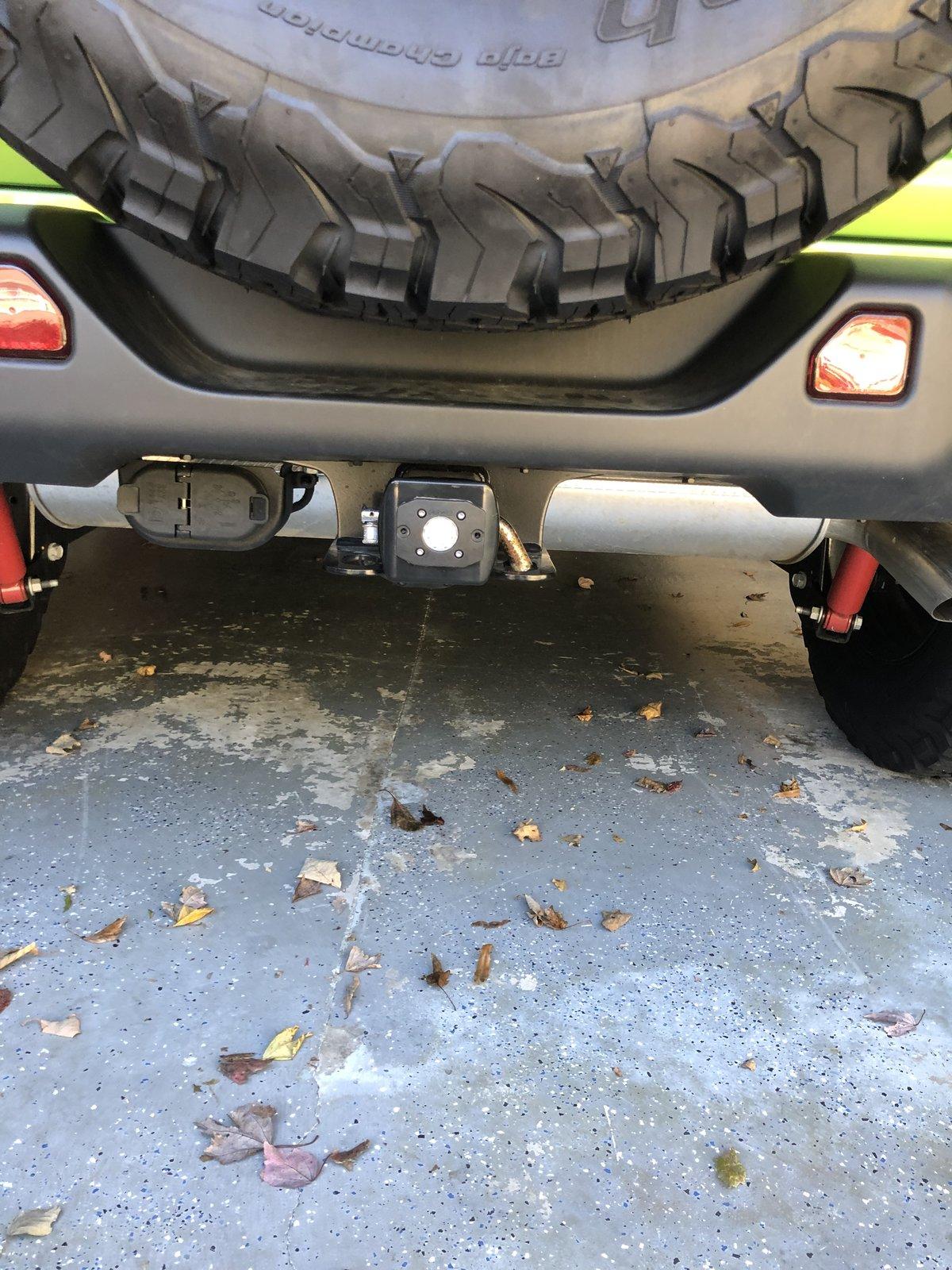

My take on the rigid ignite light. Only wanted it for backup so just grafted the flush mount into a receiver cover and tied the wires into the trailer light plug with a weatherpak connector. When it gets dark we’ll see how much difference it makes.
This is awesome, great work.
