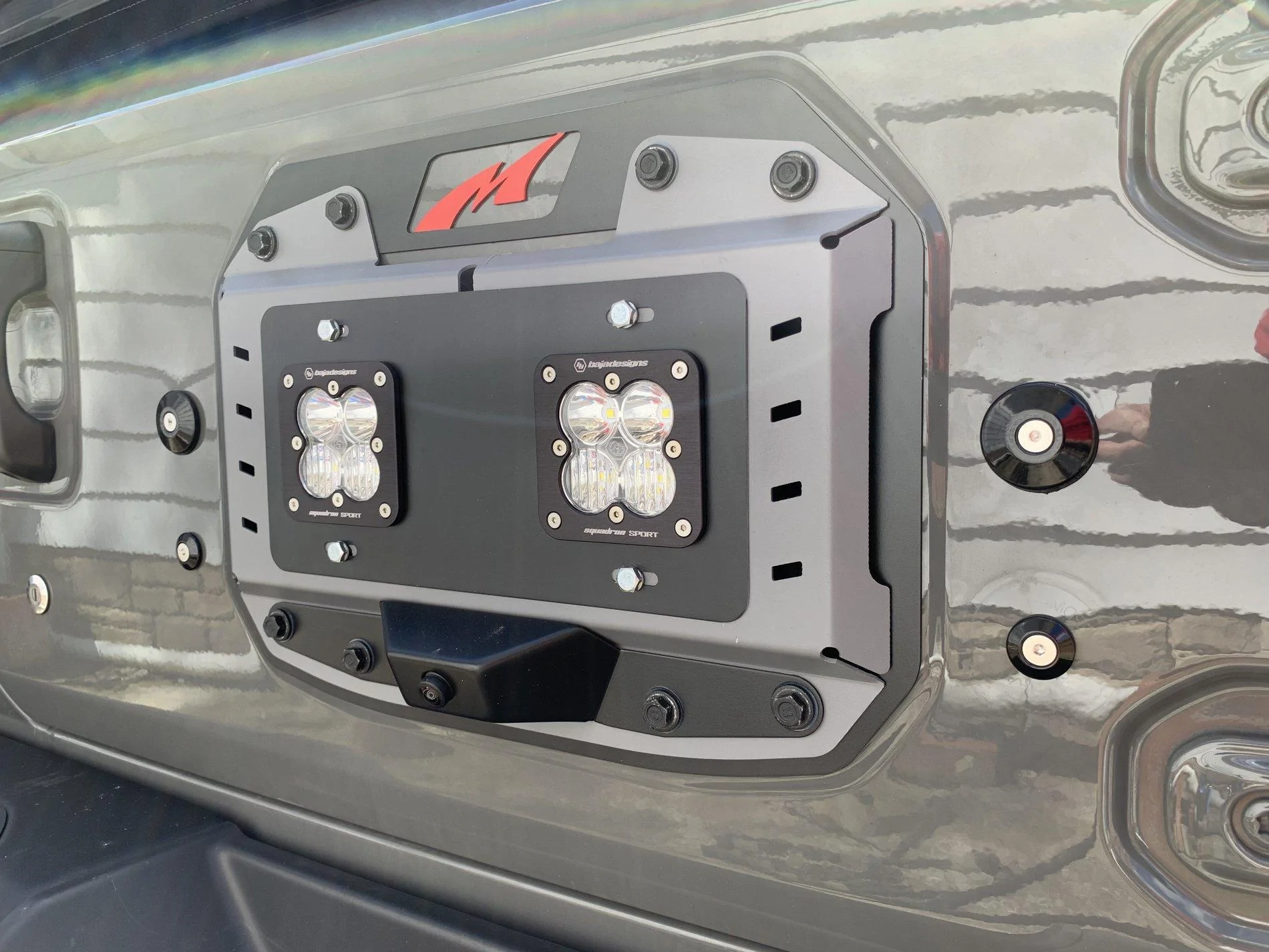

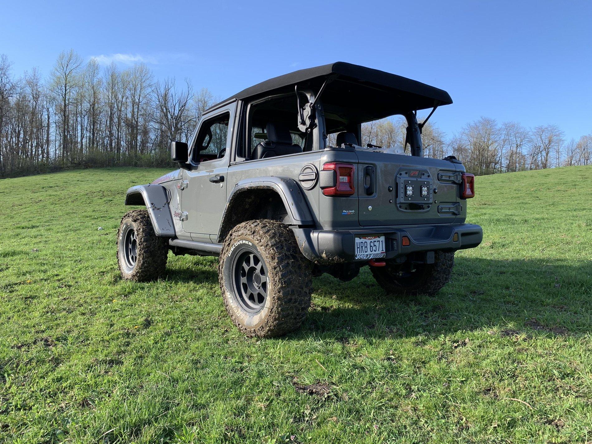

I ended mounting lights in my spare tire delete, it’s amazing haha.
How did you fit those lights behind that plate? Aren't they much deeper?
I love it, but then I'd have to put my spare in my only trunk space. Which may not be bad with a bikini and no carpets setup...
:movember:
Yes the lights are deeper than the allowed space. I cut the center out of the air outlet vents in the tailgate to allow room for the lights. I tucked the wiring inside the trim panels along the side and up to the aux wiring under the dash (aux4).

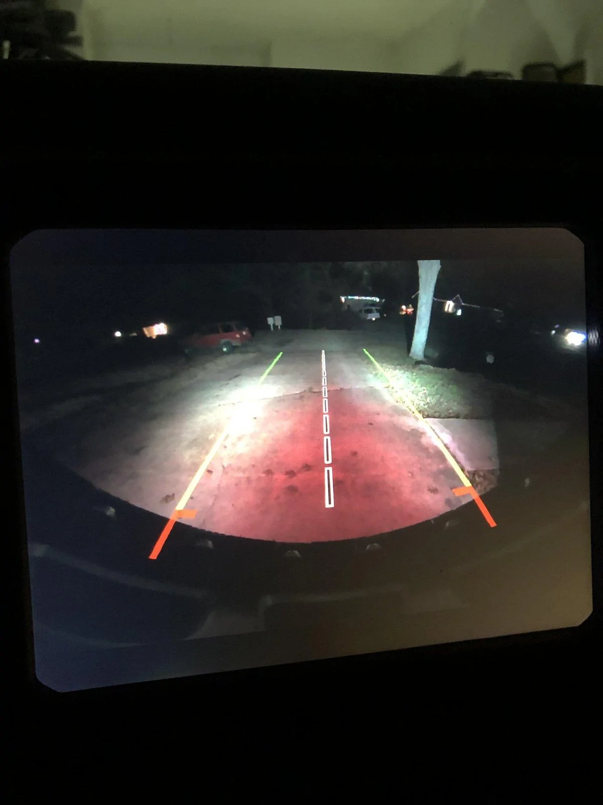

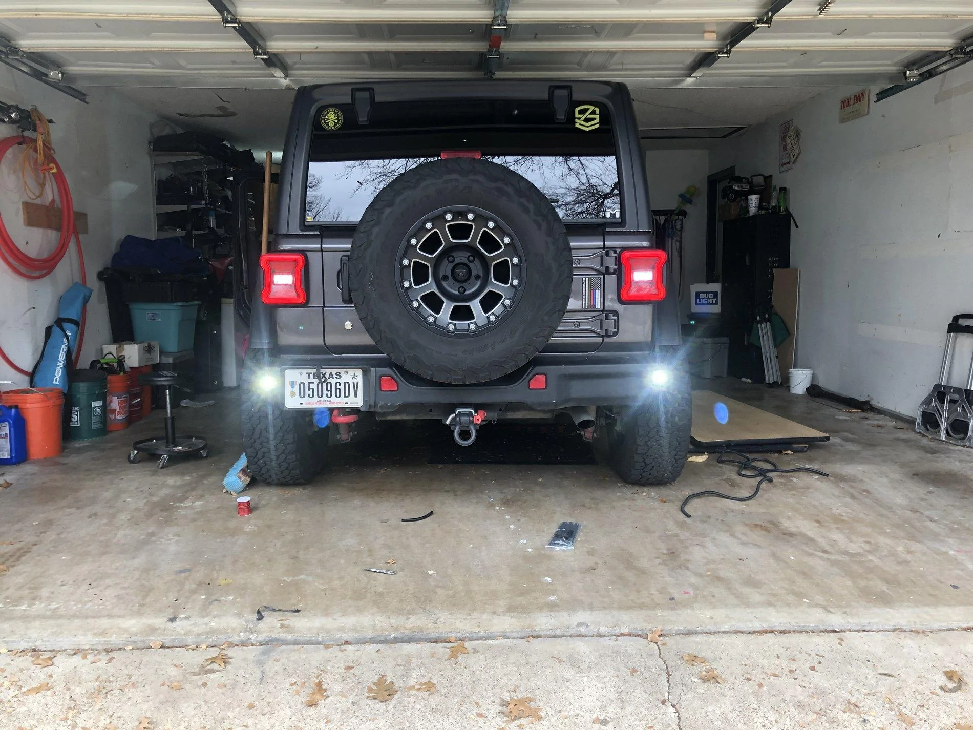

Here is what I did a week ago. Wired into the left tail light. The white wire with the brown stripe is the reverse light circuit. I like how the lights go right along the guidelines on the screen. I used the flush mount rigid LEDs that you guys were talking about putting in the reflectors.

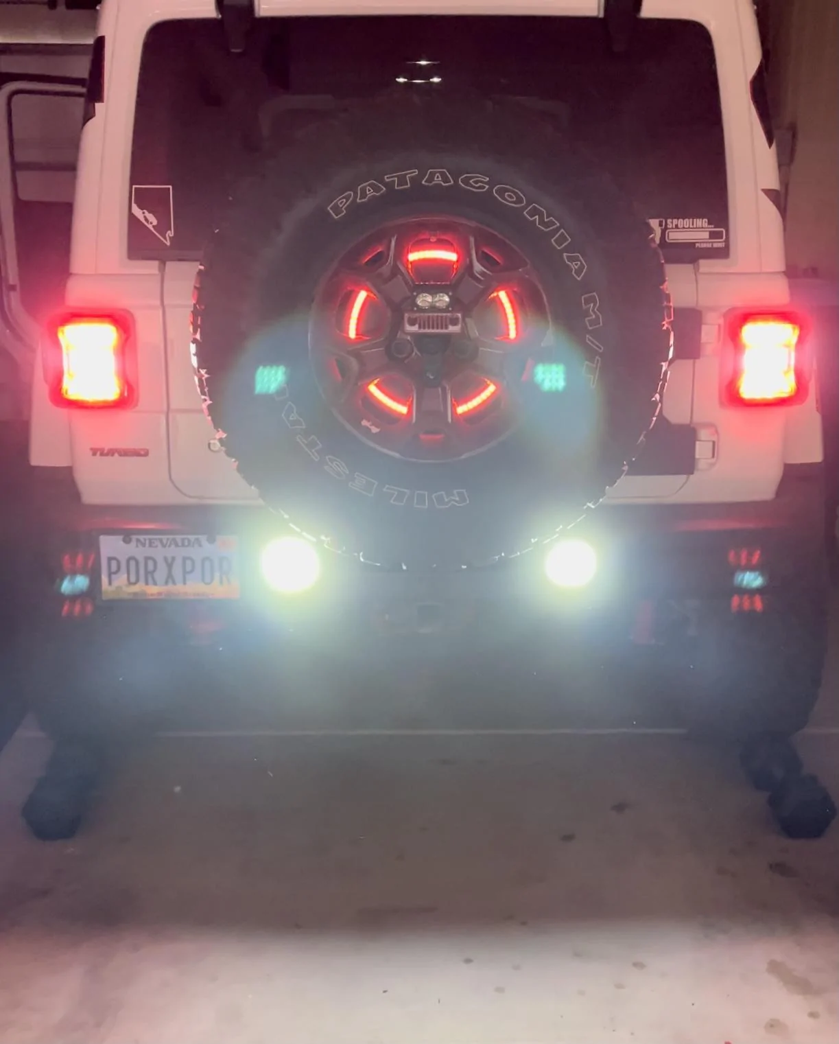

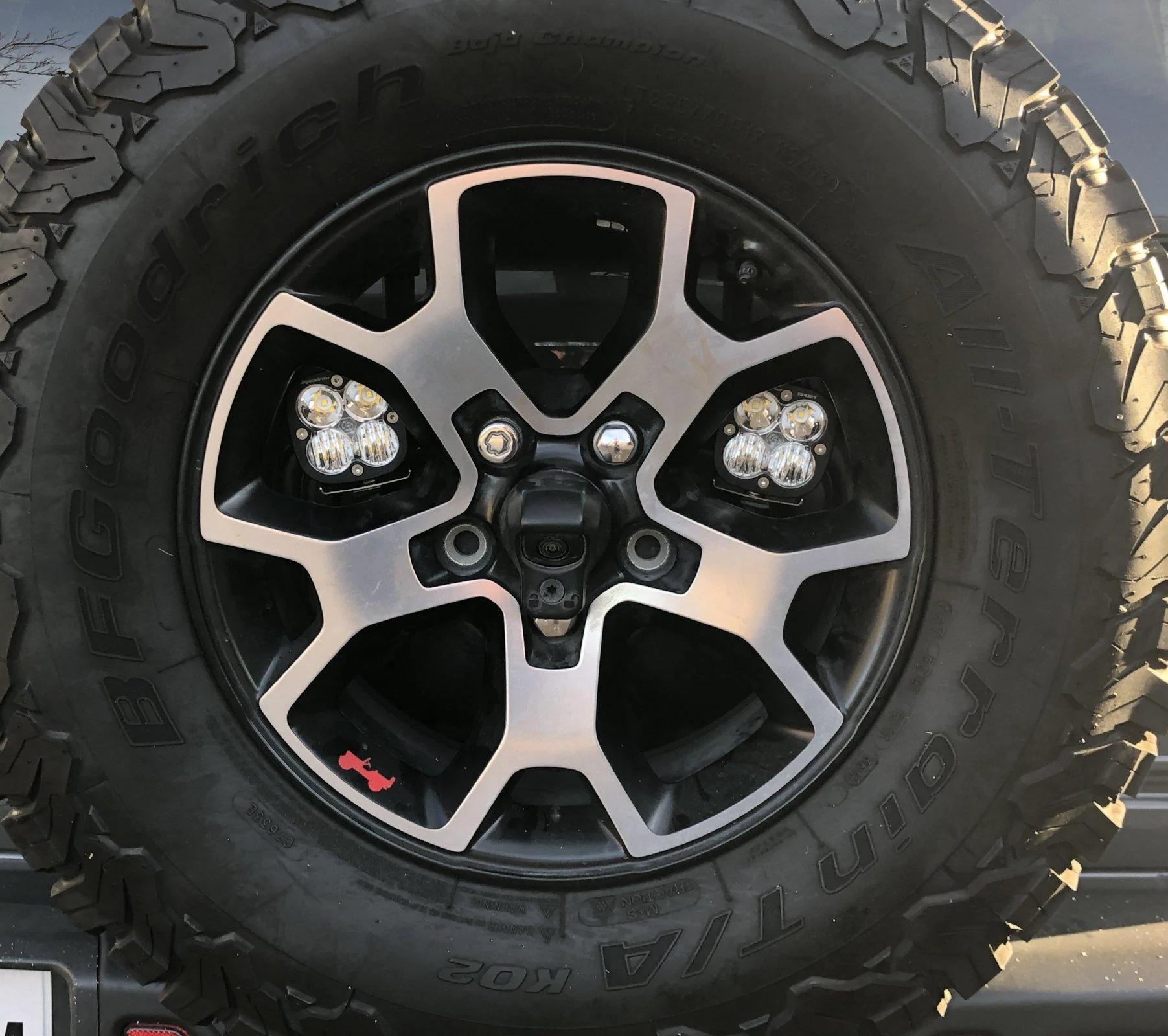

You can also install these bad boys in the spare ??
what i'm inclined to do, is stick a single laser spot right in the center, above the spare tire mount, with the light carefully aimed directly at the retinas of tailgating drivers. what i need, is the lidar that is used in adaptive cruise controls, so when you get in range, the closer you get, the brighter it gets. i want something that will zap you at high noon on a sunny day. i need a tailgater repellent.
my work car is a CTS-V, and that has a throttle pedal that renders tailgaters null and void. the jeep however, won't pull strongly to 185, and so i need a death star light....

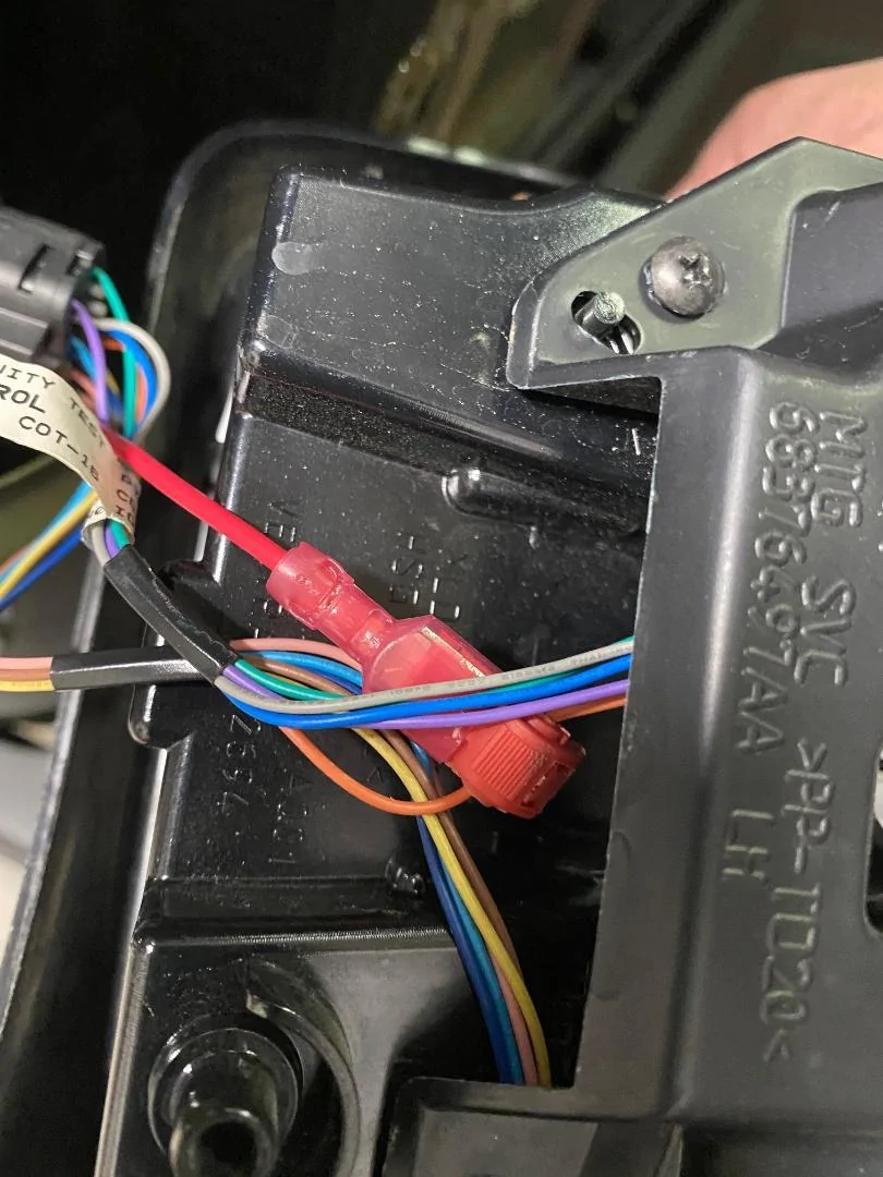

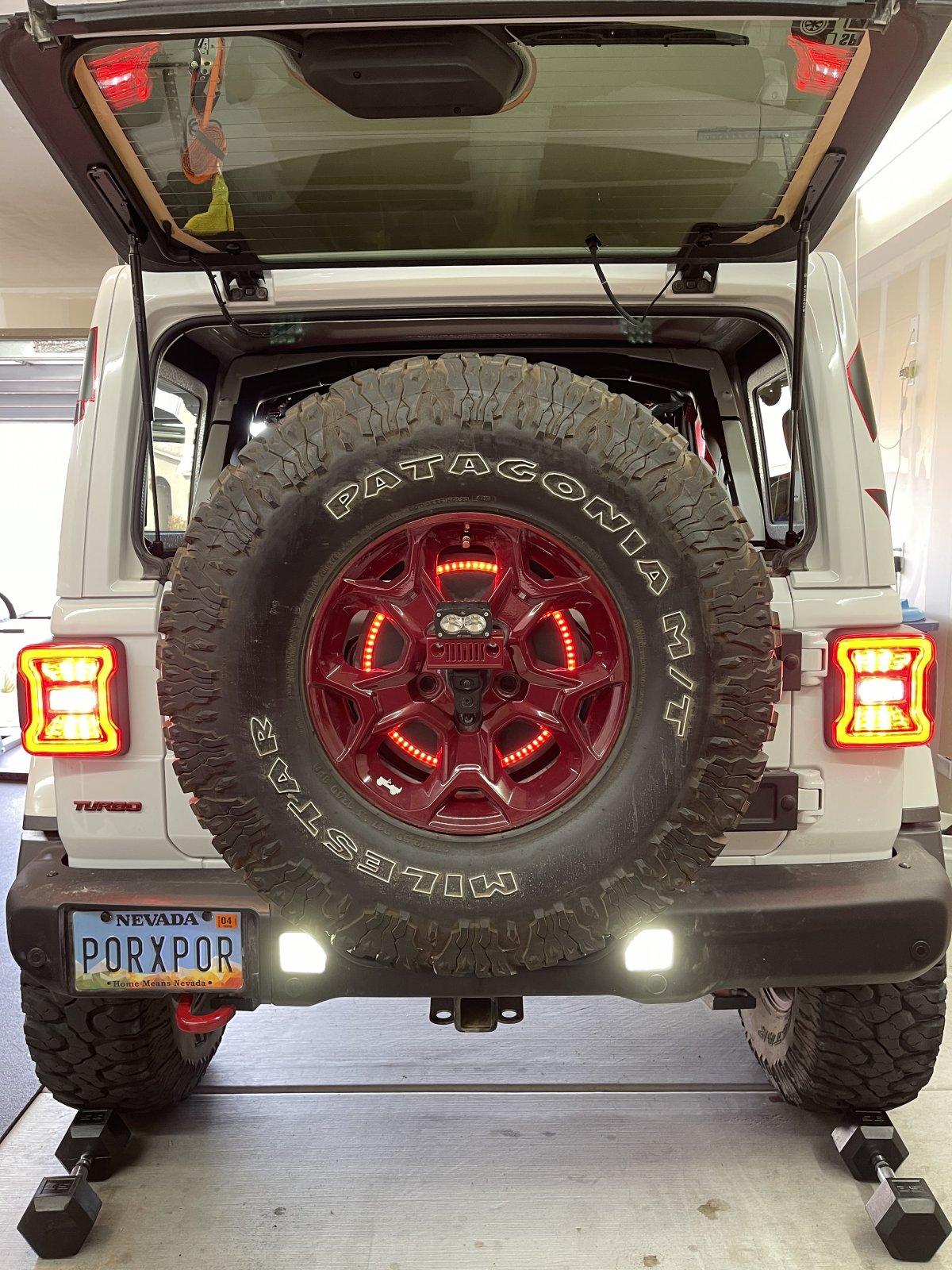

Bodam said: "How do you tie into the existing LED reverse lights? I can't find any wiring anywhere."
Bob, I tied into the driver side LED just above the clip with "t"-wire connectors. The Orange wire is the "hot" wire for the reverse light aspect of the LED.

The wiring in the left tail light. It’s been over a year since I did it. It’s either an orange wire with a white stripe or a white wire with an orange stripe. I tapped into that one and mine only come on with the reverse lights.
