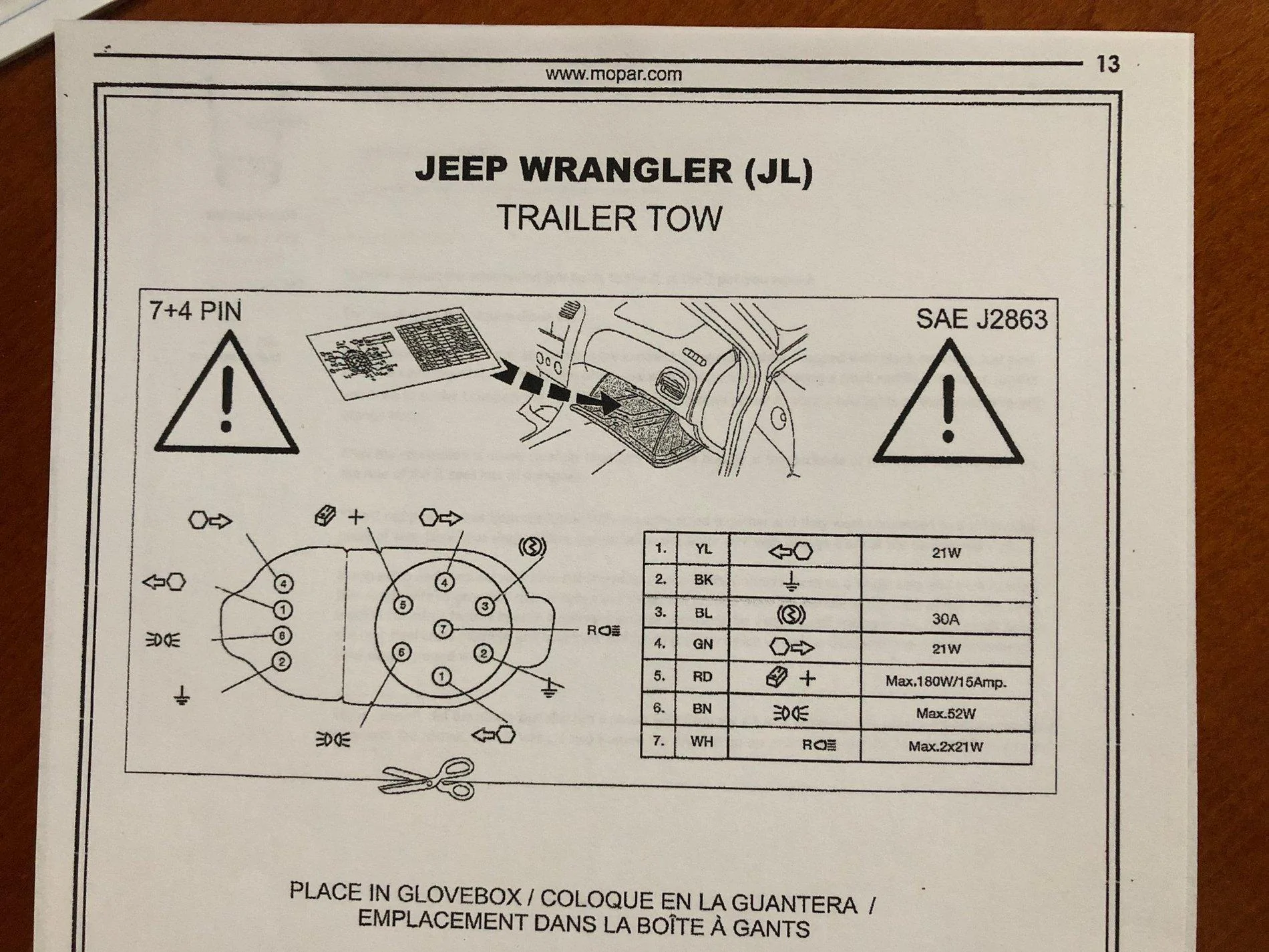

Anyone know how many amps the white/orange wire can take? My new rigid D series pods are 2.14 amps each and I got a pair, so I'm hoping to wire both rigids into the white/orange wire, then use (1) Roadmaster 792 Hy-Power Diode. But if that white/orange wire can't handle 4.28 amps, then I'm gonna use @Dan S's method with a relay coil. ( i found this diagram, but i don't know how to read it lol )

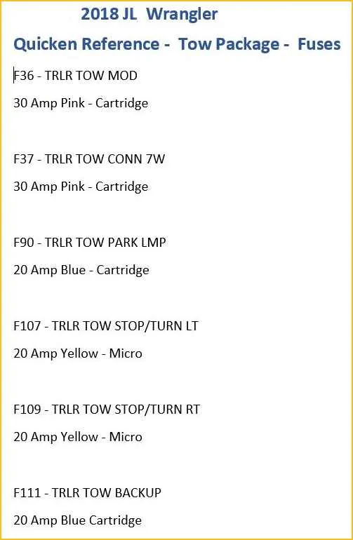

For those contemplating install of auxiliary b/u lights on your JL.
About installing auxiliary b/u lights on a JL. IF, if you have the tow package on your JL, do not be afraid, don't avoid, taping into the necessary single wire at the 6 pin connector at the rear of your JL.
*snip*
In closing if you have the tow package use the trigger wire there.. Easier, more prudent to do so.
If no tow package then tap into the tail lights if you must but do so cleanly lets say..
would you recommend adding a fuse to the line from the 6 pin ?

would you recommend adding a fuse to the line from the 7 pin ?
NO, no in line fuse, necessary in regard to the 7 pin.

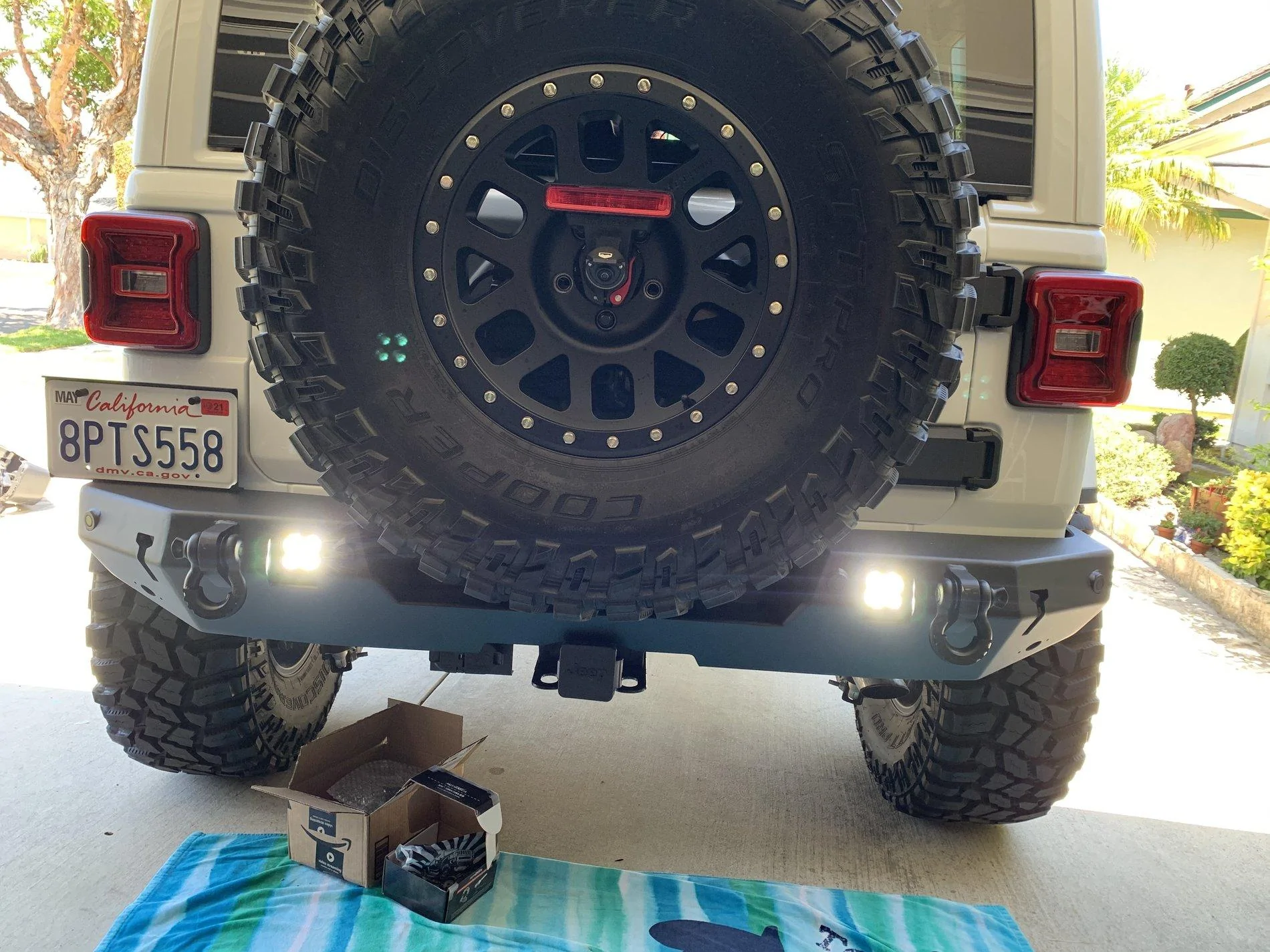

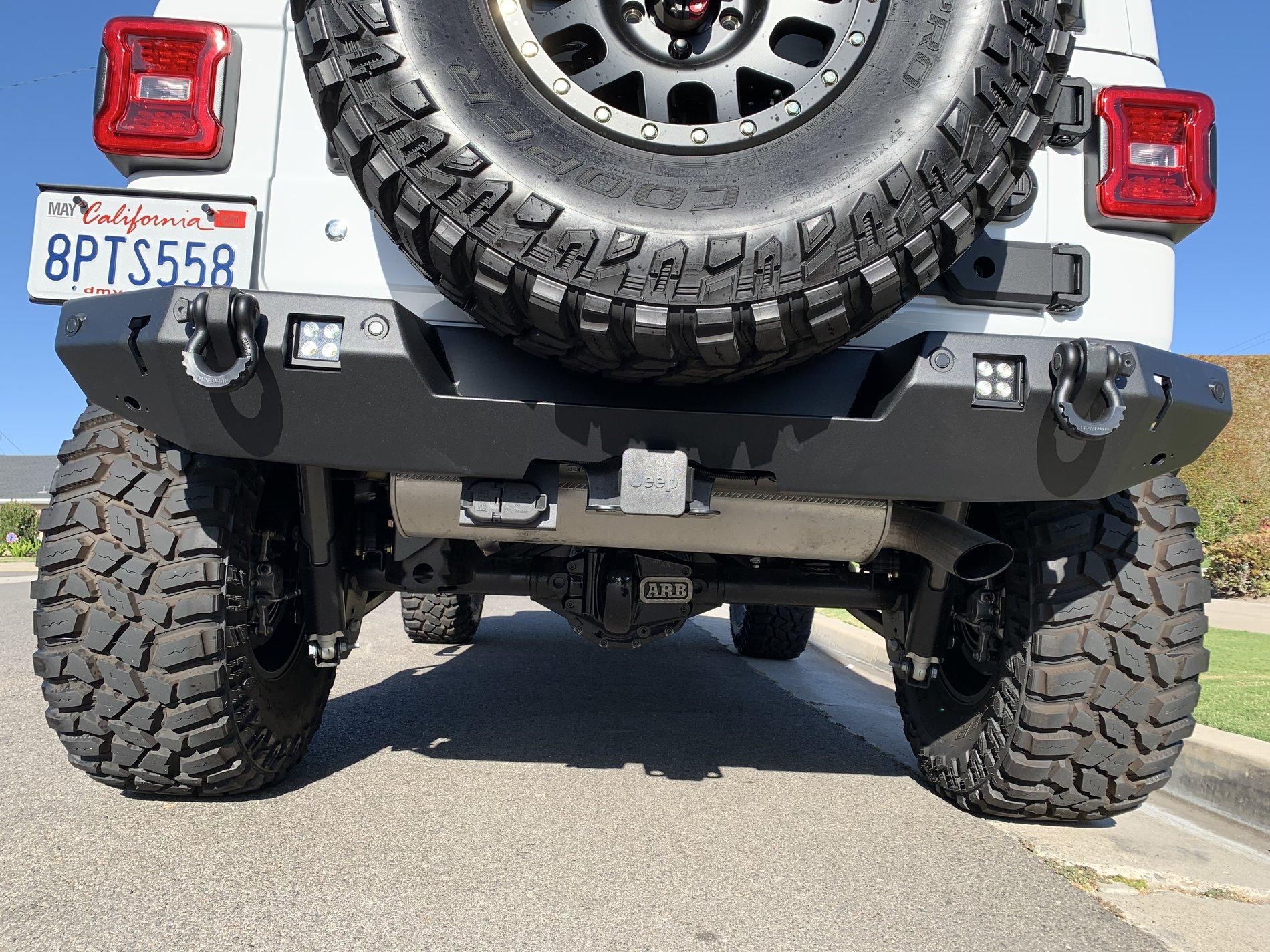

I just finished installing a new Westin WJ2 Rear Bumper with Westin HyperQ B-Force Flood Auxiliary Lights with the AUX wiring & 7-Way Trailer Harness method using 2 Roadmaster 690 Diodes. I also took my factory reverse sensors with wiring harness and installed those in the new bumper as well. I’m not an electrician so this was a new venture for me to try out.
Thanks to all who contributed to the 38 page thread on this topic. Some helpful feedback to future installers:
- Buy a 25’ Fish Tape to pull the wire through the frame from front to back ($12 on Amazon ). It took maybe 2 mins max to do this with minimal effort. Best money spent.
- I used Lockitt POSI-Taps to easily tap into the trailer hitch wiring for the reverse light feature. The diodes and taps can all be wired and stored in the passenger rear tail light section.
- Westin’s lights actual came with a decent wiring harness so I cut up and reused some of it for the shorter runs.
Here’s the finished product:

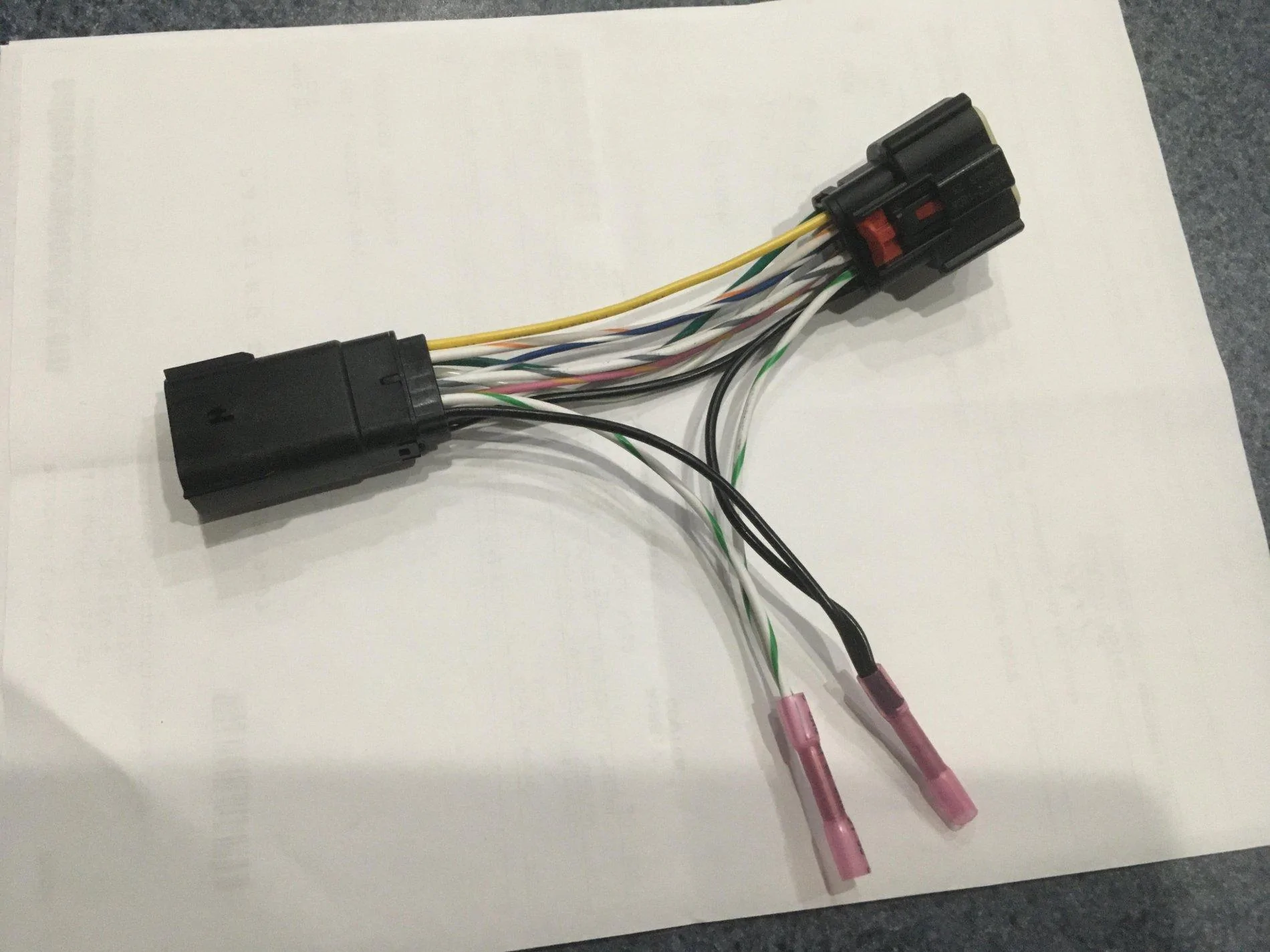

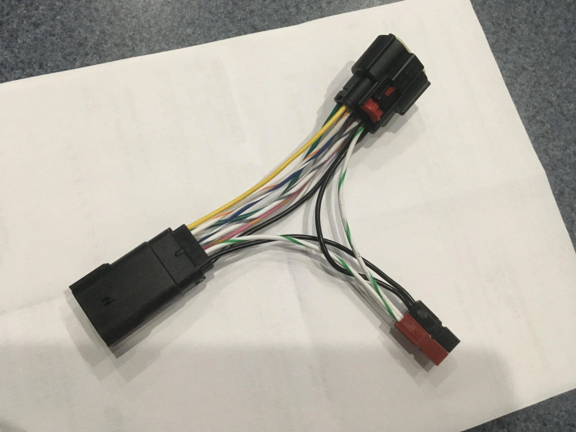

For a Back-up light project on a 2021 JL, I decided against T-tapping into existing wire. Instead, I made a pigtail jumper (extension) to go between the left rear taillight assembly and the Jeep wiring harness. This way, I can remove this, put the original connectors back together, and it's in factory fresh condition.
That connection uses 12-pin MX-150 Molex connector. I am connecting my new LED backup lights to this pigtail using Anderson Powerpole connectors, but it's just as easy to use traditional butt connectors. Both are shown here.
I would welcome your thoughts and comments.

When buying the supplies, I bought extra. And I’ve spent much money on crimping tools for open barrel Molex connectors and crimpers for Powerpole connectors. And I’ve ruined a few connectors learning how to crimp them.
So if I can save others the expense and headaches of trying to do it themselves, and instead provide these to them, I’ll do it.
Notice the striped wiring I’m using to match the factory wire colors.
Let me know if you want Right or Left side, and for the 5 pin and 6 pin (backup light and ground), let me know if you want me to leave them unstripped, or I can crimp either a butt connector or Powerpole Connector Like in the pic.
