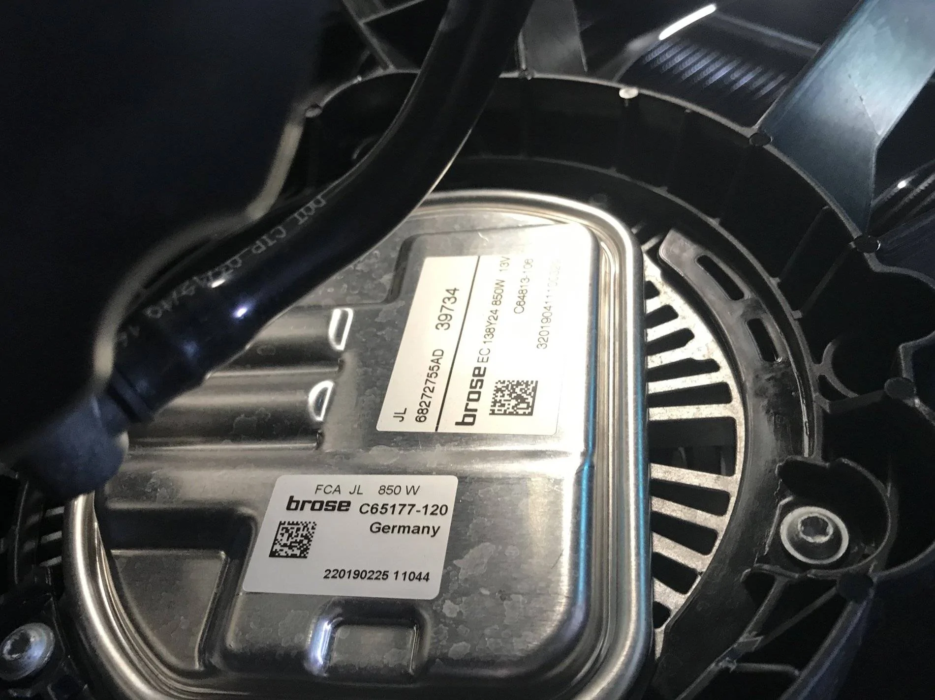

^^^ The above is one of the main reasons, that the Gladiators engine cooling system is superior to the JL’s. 850 watt cooling fan motor, plus a 240 amp alternator to help power it.

If your temps creep up at low speeds, a more powerful fan will help. I’ve never had an issue with the 2.0t cooling there, even wheeling in 120° AZ heat with the AC cranked. A larger fan will do absolutely nothing at speed, which is the only place our cooling system has seemed deficient in 60k miles. Only 2 things really help cooling at speed in my experience, larger/ more efficient radiators like the cold case, and more air through the radiator which a fan won’t do at freeway speed. I think this is where the gladiators wider/more open grill would be a benefit.
From what I've read, the 2.0 already comes with the 850W fan.

It’s already been posted that the 2.0 has the same 850w fan as the gladiator.
220 is not a problem; the problem is it’s not capable of holding 220 under heavy load, especially at high altitude.
Naturally aspirated engines lose power at altitude, so a corresponding loss of cooling capacity is OK. The turbos do NOT lose power, but the radiator loses capacity. That’s the issue.

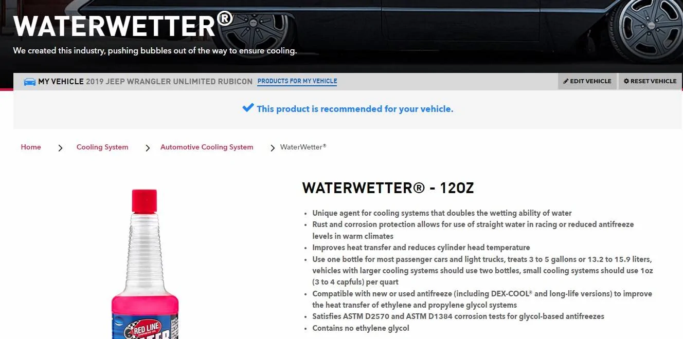

Not sure if this has been suggested, I've used Redline Water Wetter for years and it works well to lower operating temperatures. Had over heating issues with an off road vehicle, added water wetter and it was enough of a difference to solve the over heating 100%.

I too am curious out Redline Water Wetter. I could fine nothing online about specific compatibility with Mopar OAT specification MS.90032 coolant but did select my exact vehicle from Redline's vehicle selector and it says it is compatible. Most everyone who uses this product say it works.
Jeep Wrangler JL Anyone done cooling system upgrades? (2.0 specific) Redline Water Wetter

Redline's water wetter and Purple Ice by Royal Purple are both worth considering.

The 2.0s already use the more powerful cooling fan shared with the gladiator. See the part here
https://www.amazon.com/Red-Line-80204-Water-Wetter/dp/B000CPI5ZK
I prefer double wetter snake oil (DWSN) , which cools 60 degrees, twice the RWW. And DWSN has double the placebo effect (DPE), improves traction and articulation.
