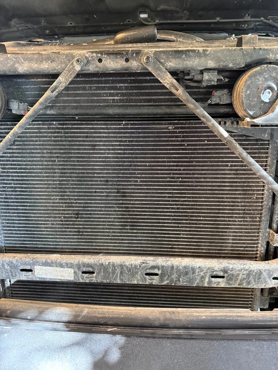

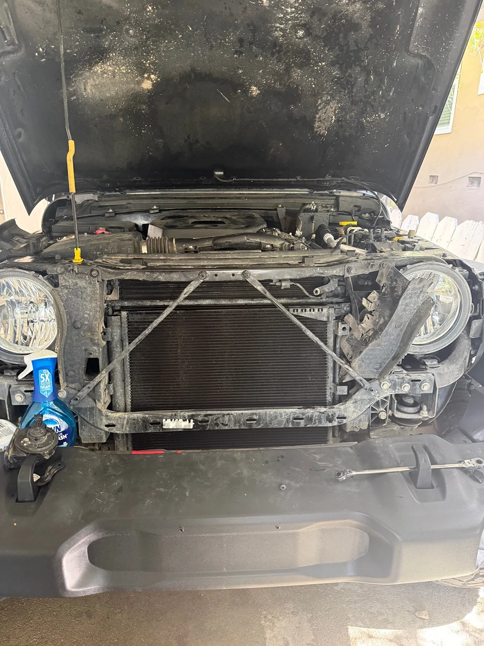

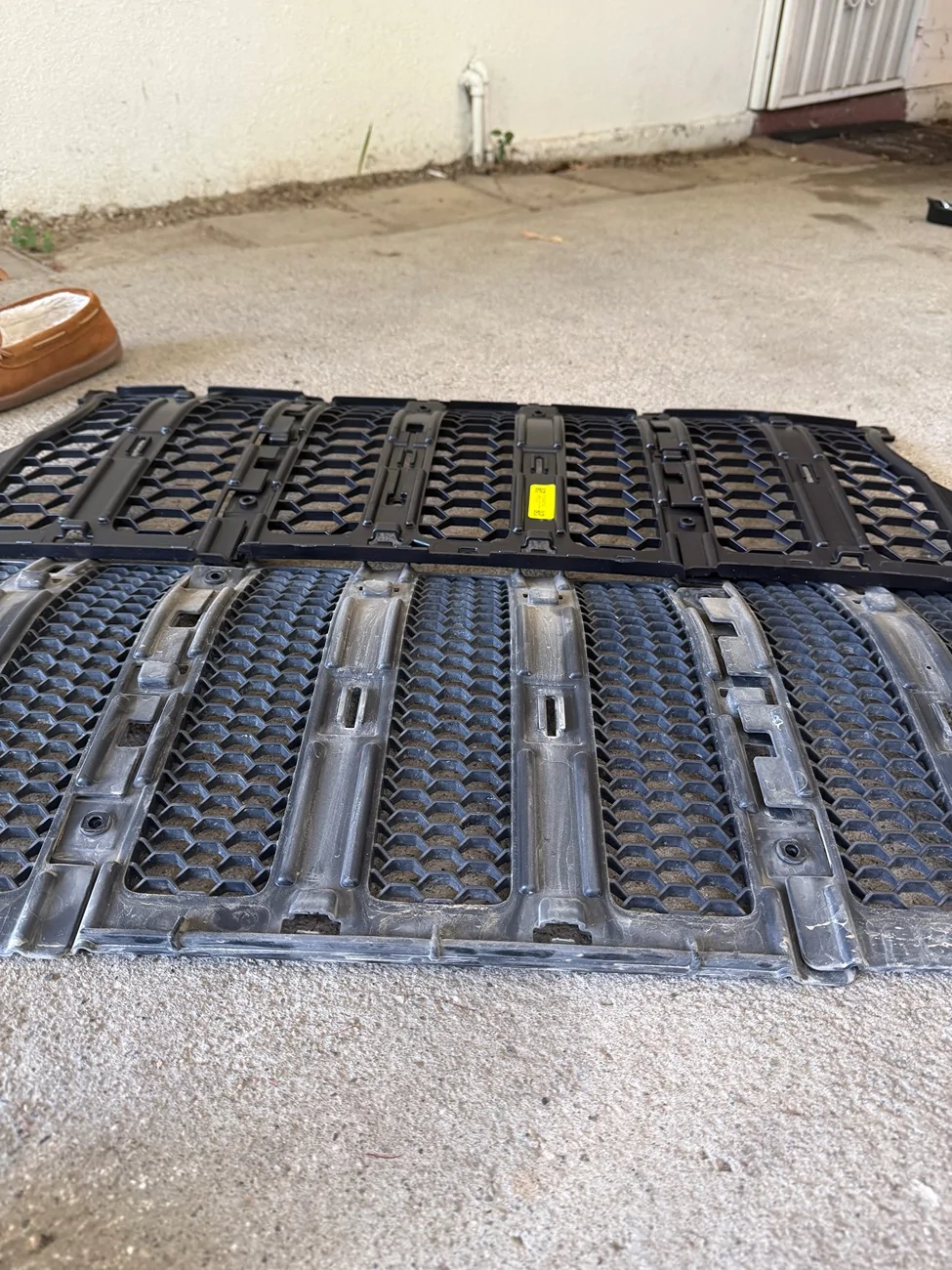

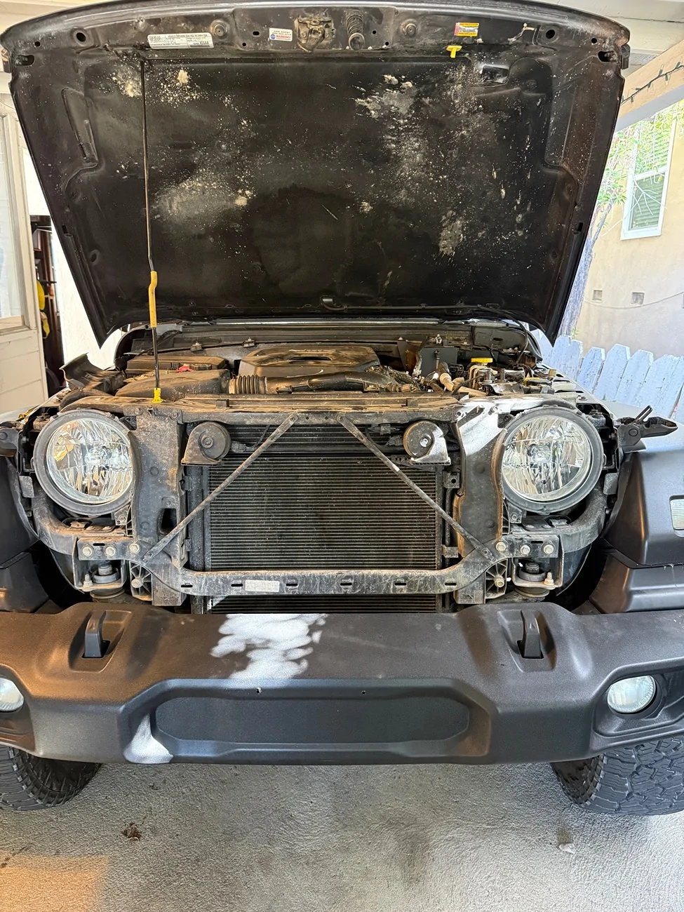

I appreciate the suggestion to clean the radiators. Man were they filthy and packed full of bugs and rocks.

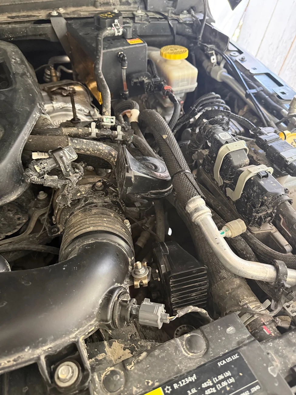

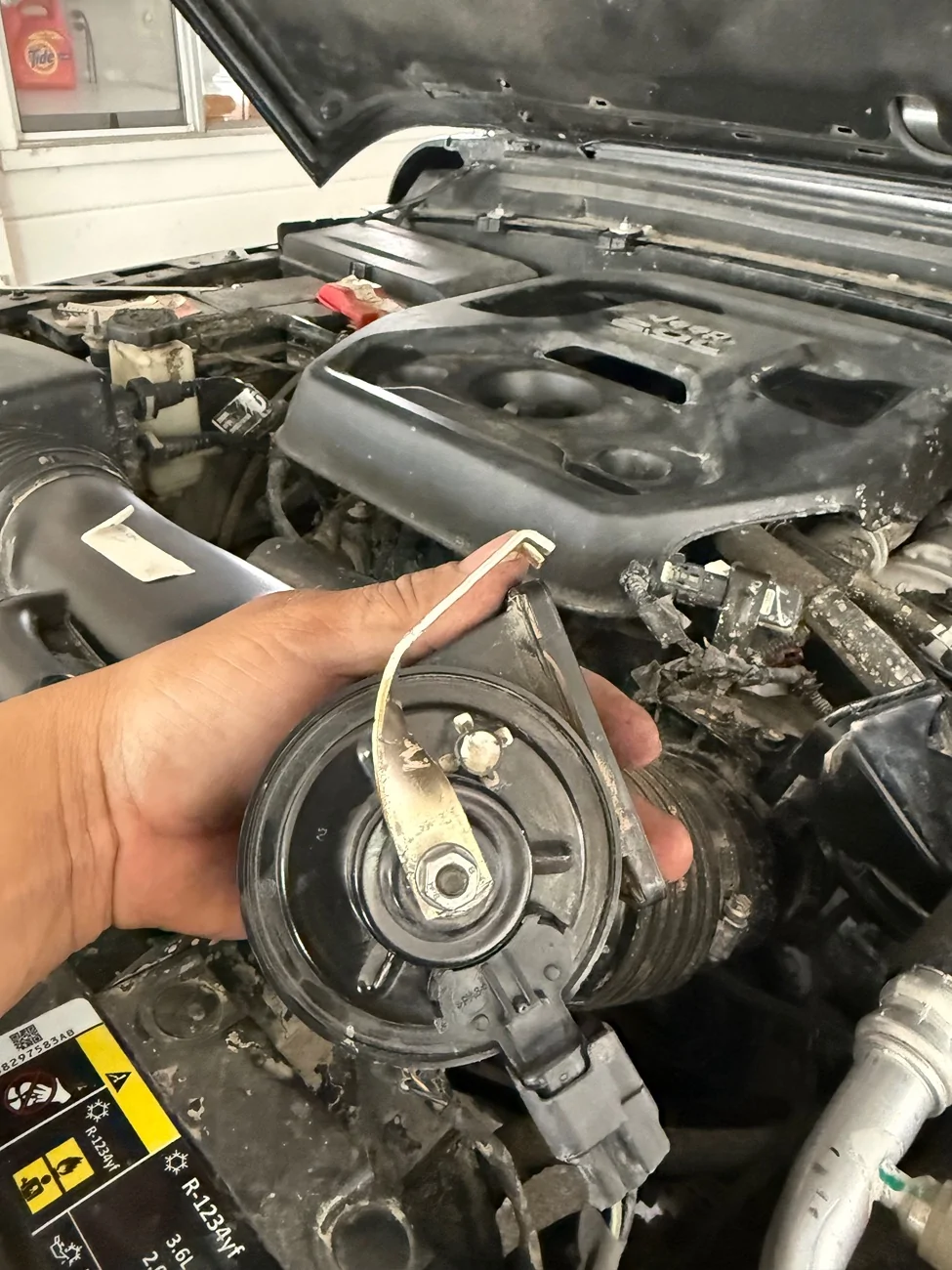

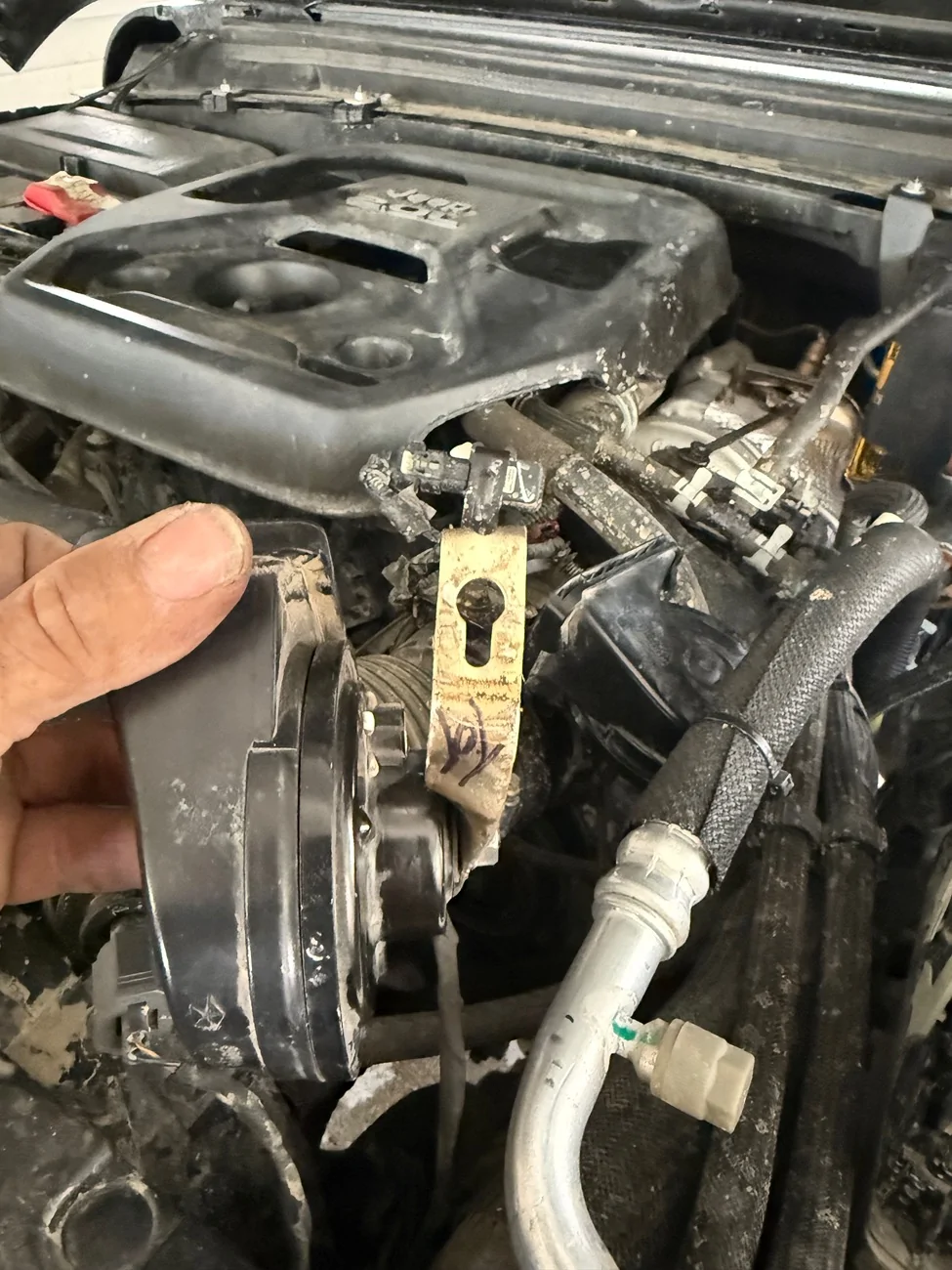

I also went a bit ham and moved the horns out of the way. Who knows how much it mattered, but it was under hour of work and pretty simple.
Jeep Wrangler JL Best option for enhancing 2.0 cooling? IMG_4592
Just requires some fancy foot work getting the bolts out for the passenger side mounting bracket. I decided it wasn’t worth the effort on the drivers side and just unbolted the horn.
I then split the harness to the air temp sensor and the horns to give me some slack so I could find a spot to mount the horns.
Jeep Wrangler JL Best option for enhancing 2.0 cooling? IMG_4600
I I was able to reuse one bracket and it bolted right up to the air intake.
The other one I made out of a curtain rod hanger I had laying around.
Jeep Wrangler JL Best option for enhancing 2.0 cooling? IMG_4597
Jeep Wrangler JL Best option for enhancing 2.0 cooling? IMG_4598
The horns are super light so I’m not terribly concerned about them messing with anything and the routing honestly feels factory with how the wiring just worked out.

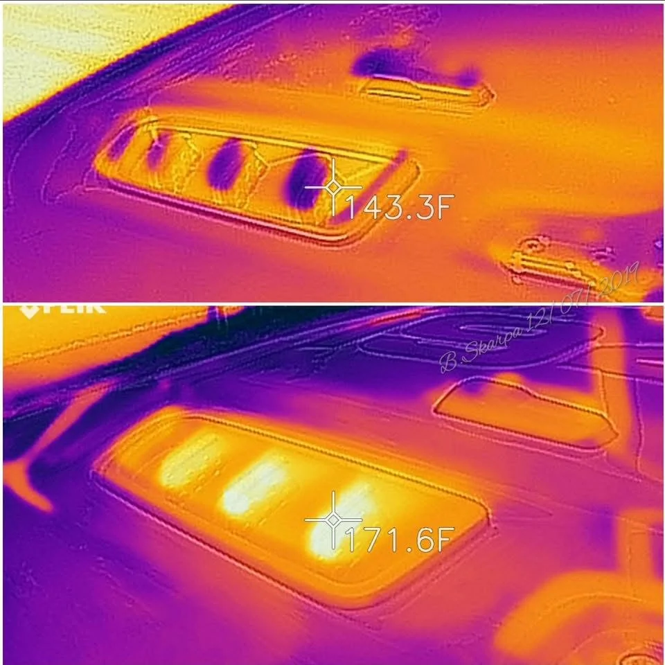

My 2026 is arriving soon, it has the new steel hood. I plan on making the hood scoop functional.
if you have a rubicon with the older hood I know it can be done for that as well. Drilling holes into the plastic plate that is there.
That will cool the engine bay a great deal since the hot air will rise right out of the vents
Yup. Stole this pic from a guy on FB. Two jeeps. Both 2.0s after the same drive. Definitely lets a good bit of heat out. Opening mine up has helped quite a bit
