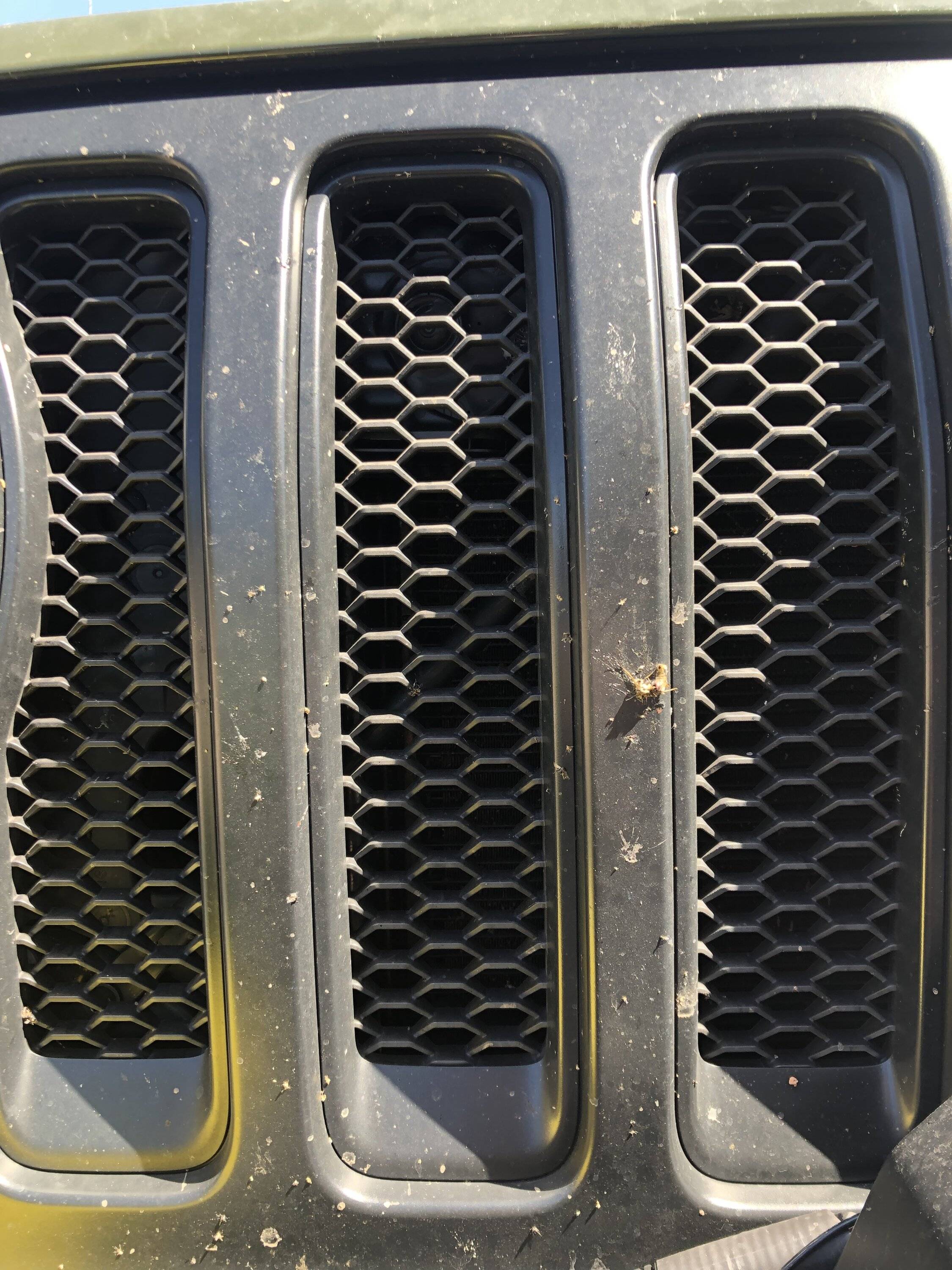

Just got back from Lake Tahoe and was watching the temps the hole time
On my trip up no issues jeep topped out about 220 coolant and 201 trans
Put driving around Tahoe I was seeing 231 before the fan would kick in and cool down
So wile up there I removed the grille insert and saw it would run at lower temps
Never once after removing the inserts did it get up to 231 and turn on the fan . Got close on some up hills put then cooled down a much faster
So I ordered the Gladiator / wrangler jl upgrade inserts from BAM Wholesale Parts $54 shipped

Its not a fix all for the fan coming on at such a high temps put it helps
I also moved the horns from in front of the trans cooler to behind the bumper
I am also looking at putting the Mishimoto 10 in. fan and Universal PWM fan controller in front of the radiator
The controller will allow for a ramped up fan speed
Has any one installed a fan in front and did it work out

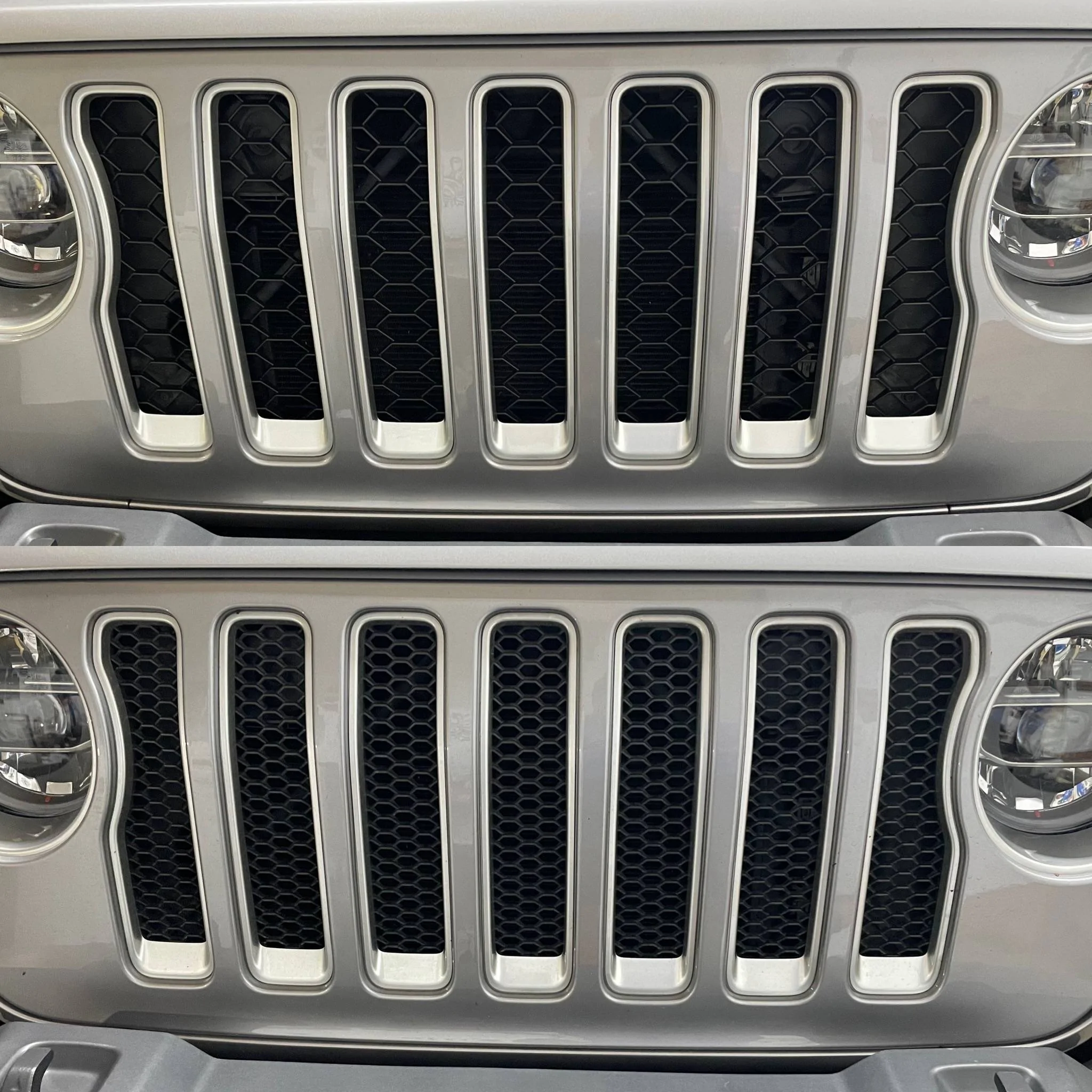

I know it has probably been shown before, but figured I would post it anyway. Before and After of installing the 3 grill insert Parts that @Willys41 listed.
The old style (‘20 JLU Sahara) didn’t seem that restrictive until you see the JT newer style.
