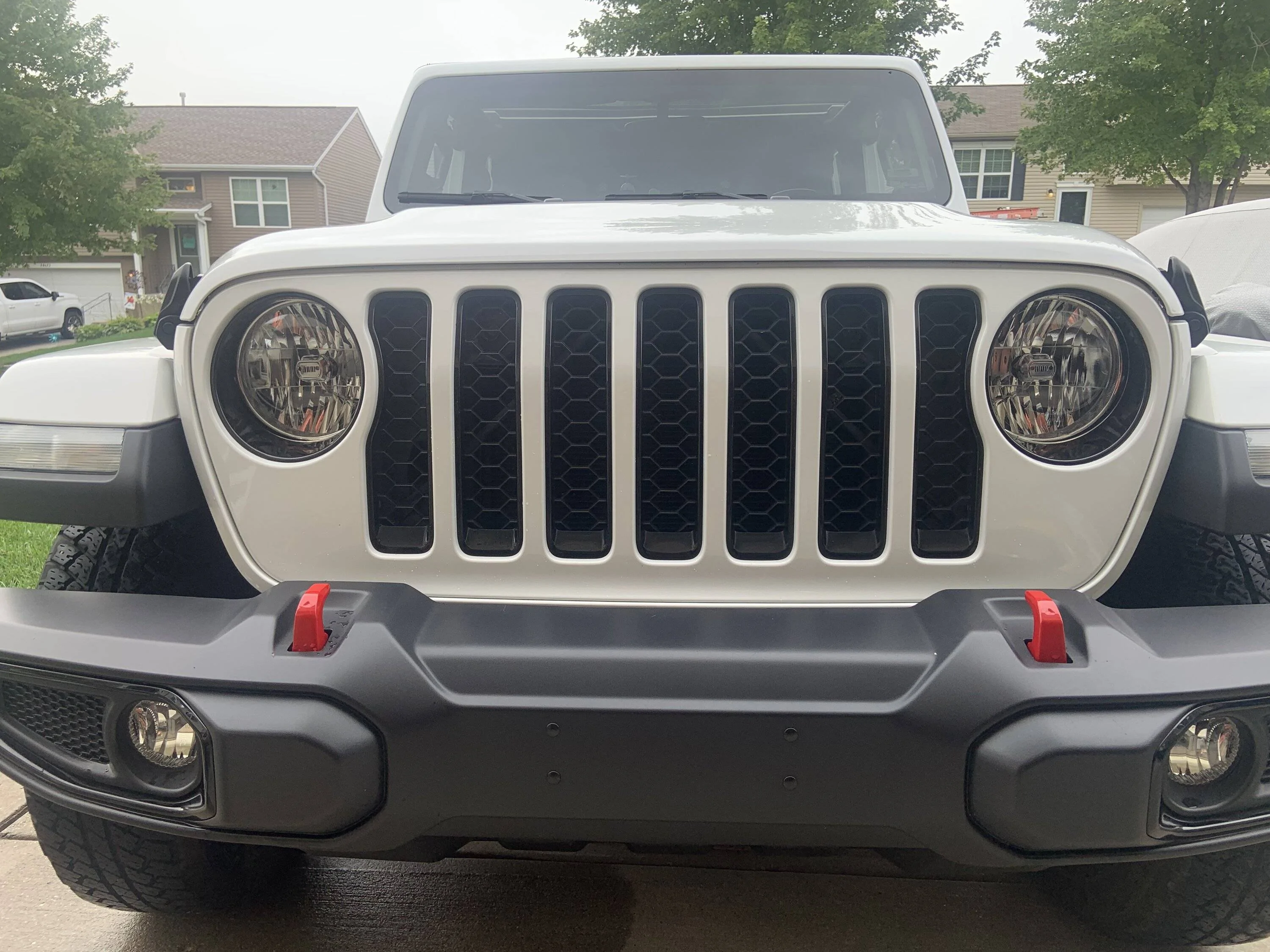

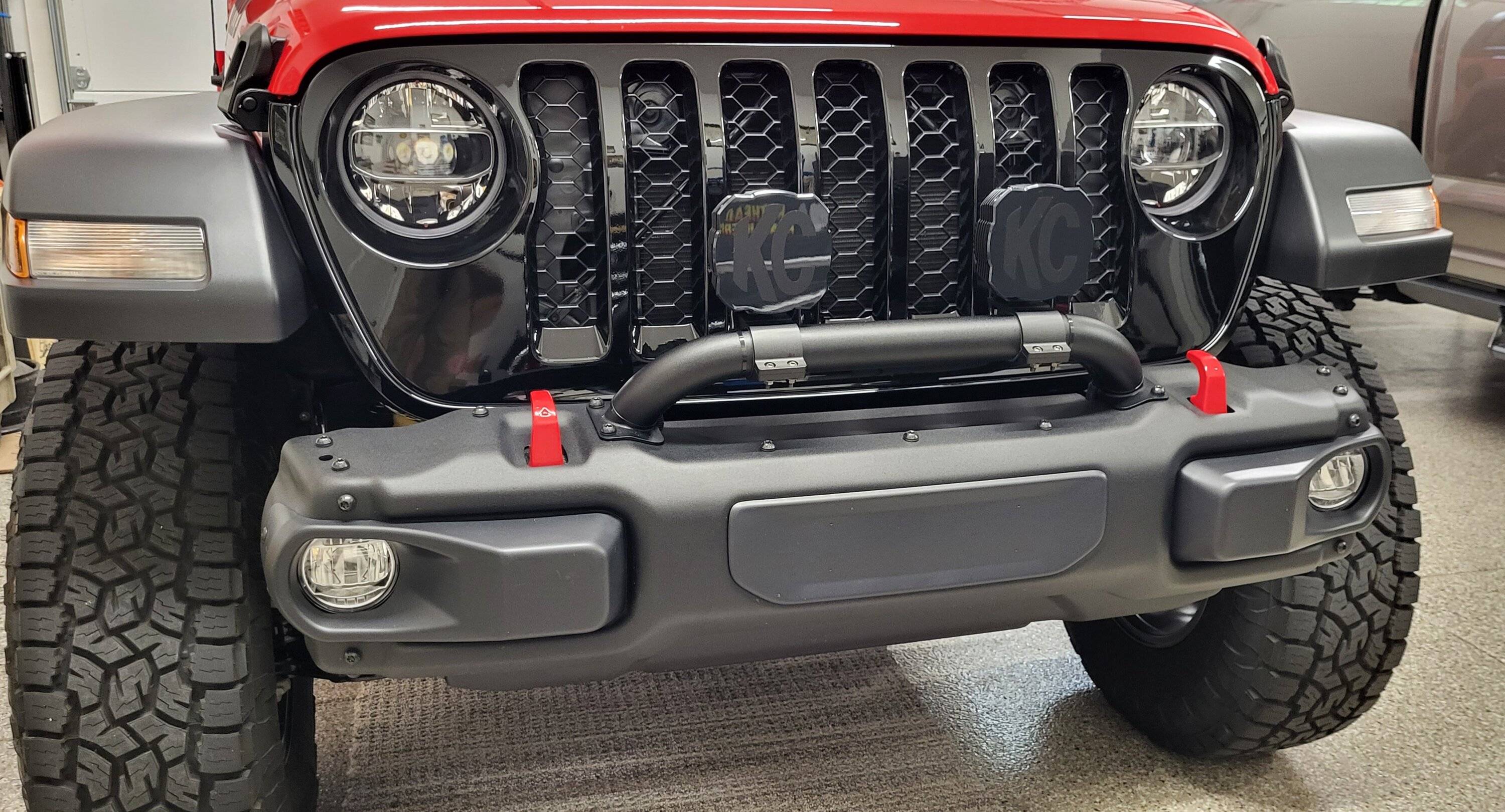

Sep 15, 2022
40
Omaha
2021 Wrangler Altitude
I added those to an 21 Altitude i did it because it looked better than the stock smaller opening insert those almost looked closed off. Also added the Gladiator metal skid plate it looked like the OEM plastic one was gonna drag on the ground with the lowering springs installed

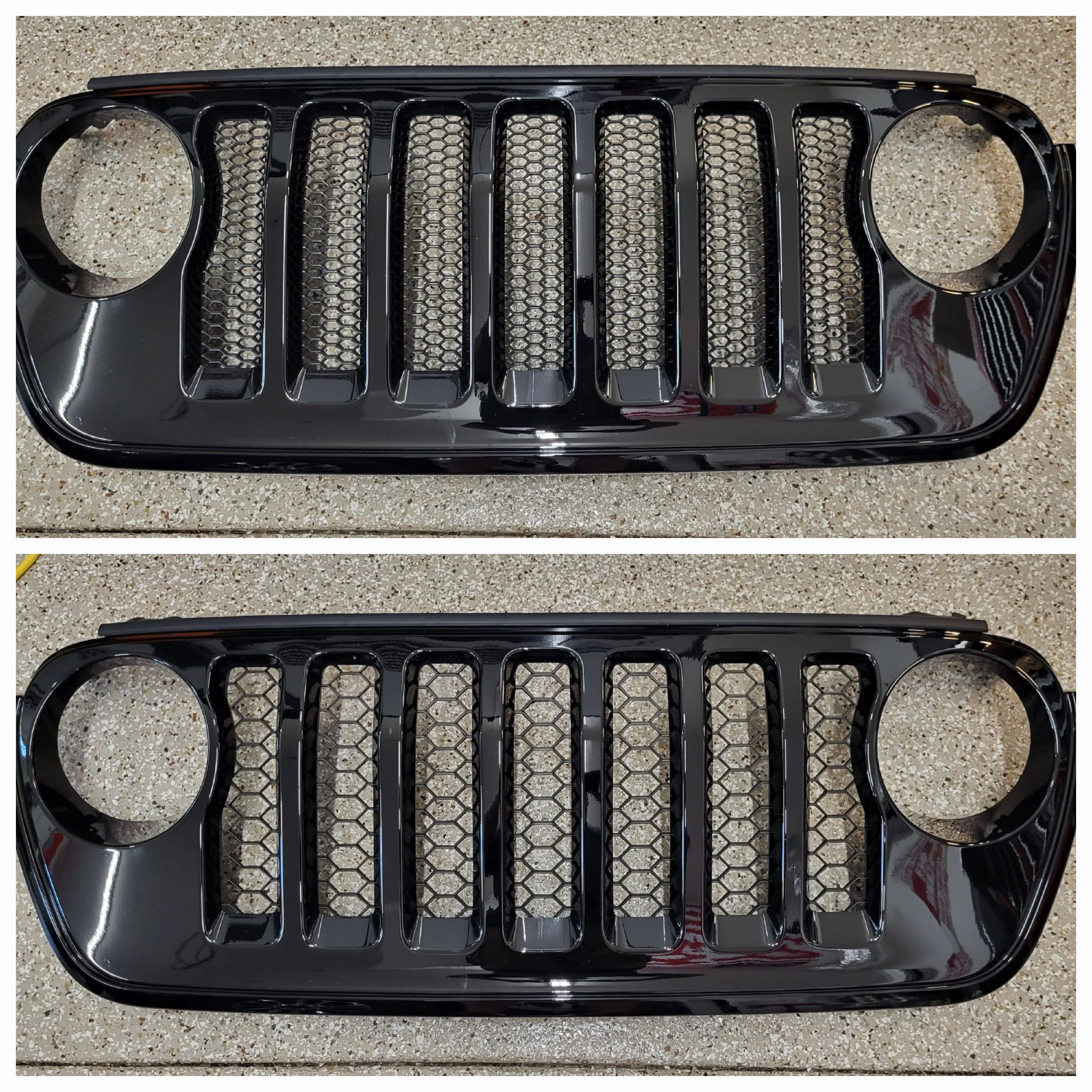

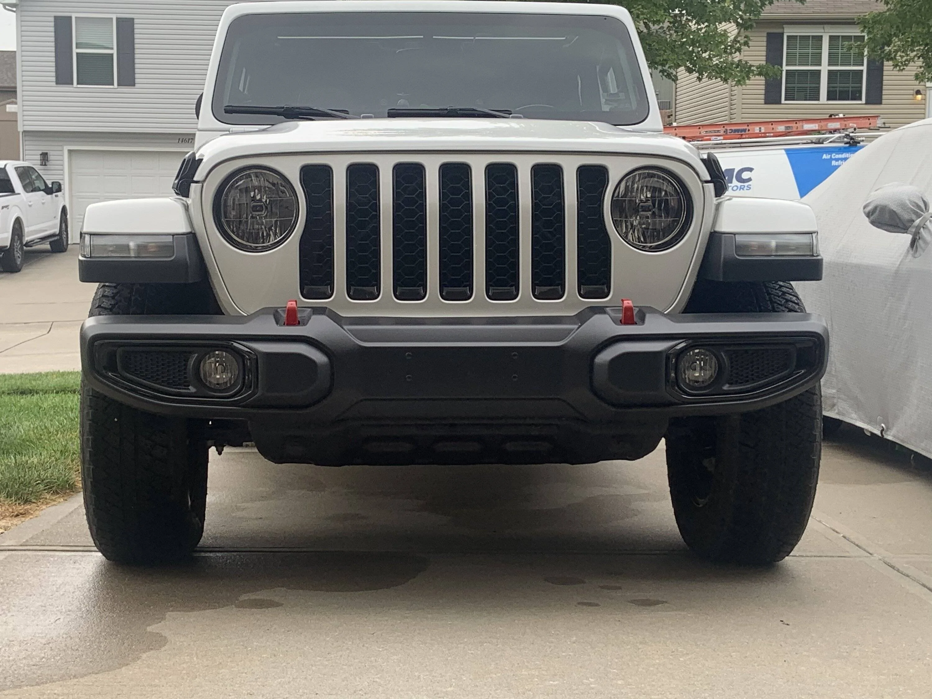

This kit worked well on my Willys grille (essentially a black Sport grille).
Took maybe 30 minutes. Super easy!!
