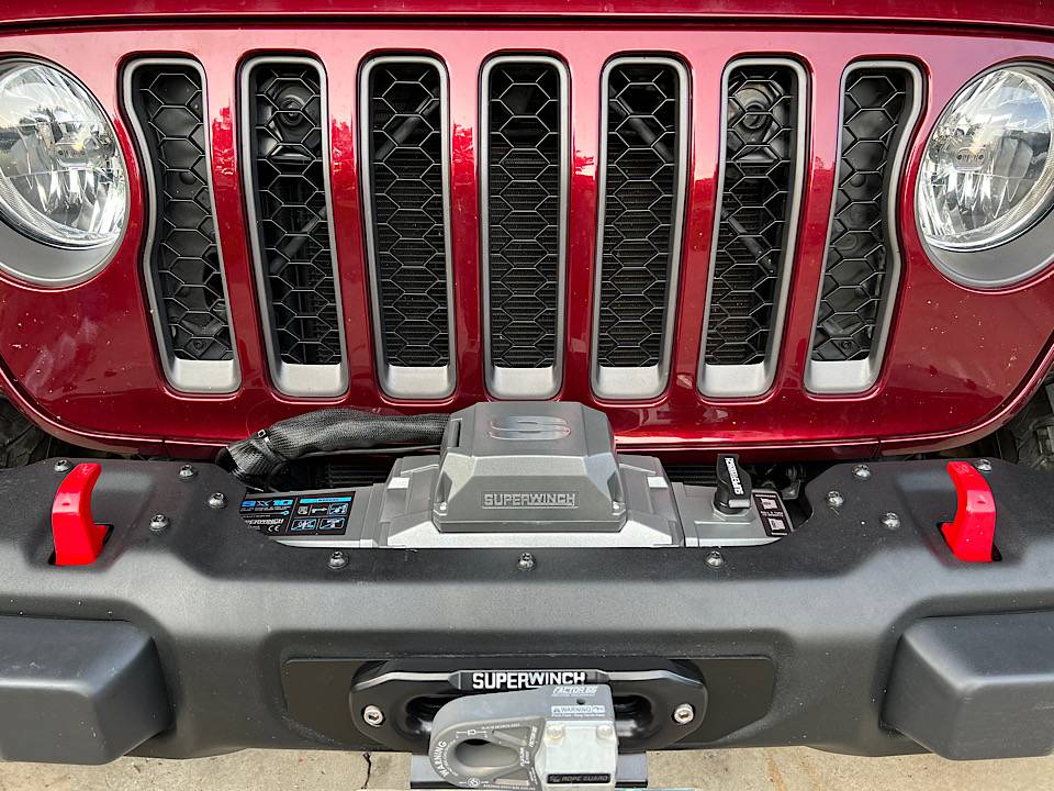

How do u guys know what the fan speed is? All I know is the cooling system definitely is wimpy and I'm in upstate NY! My 2 week old 23 JLR boiled over at my last stop running a few errands around town (The bar gauge on the dash never changed from normal.) but the pressure cap was barely snug. Tightened it and no more boil overs but I've been watching the digital display in the off road app and that changes! Easy on the throttle stop and go driving and it runs 225, not good unless ur pulling a load maybe. On the highway it stays under 205 even accelerating up hill. And that was before I put on my bumper and winch. Not enough air flow so I'm looking for a higher CFM fan too.

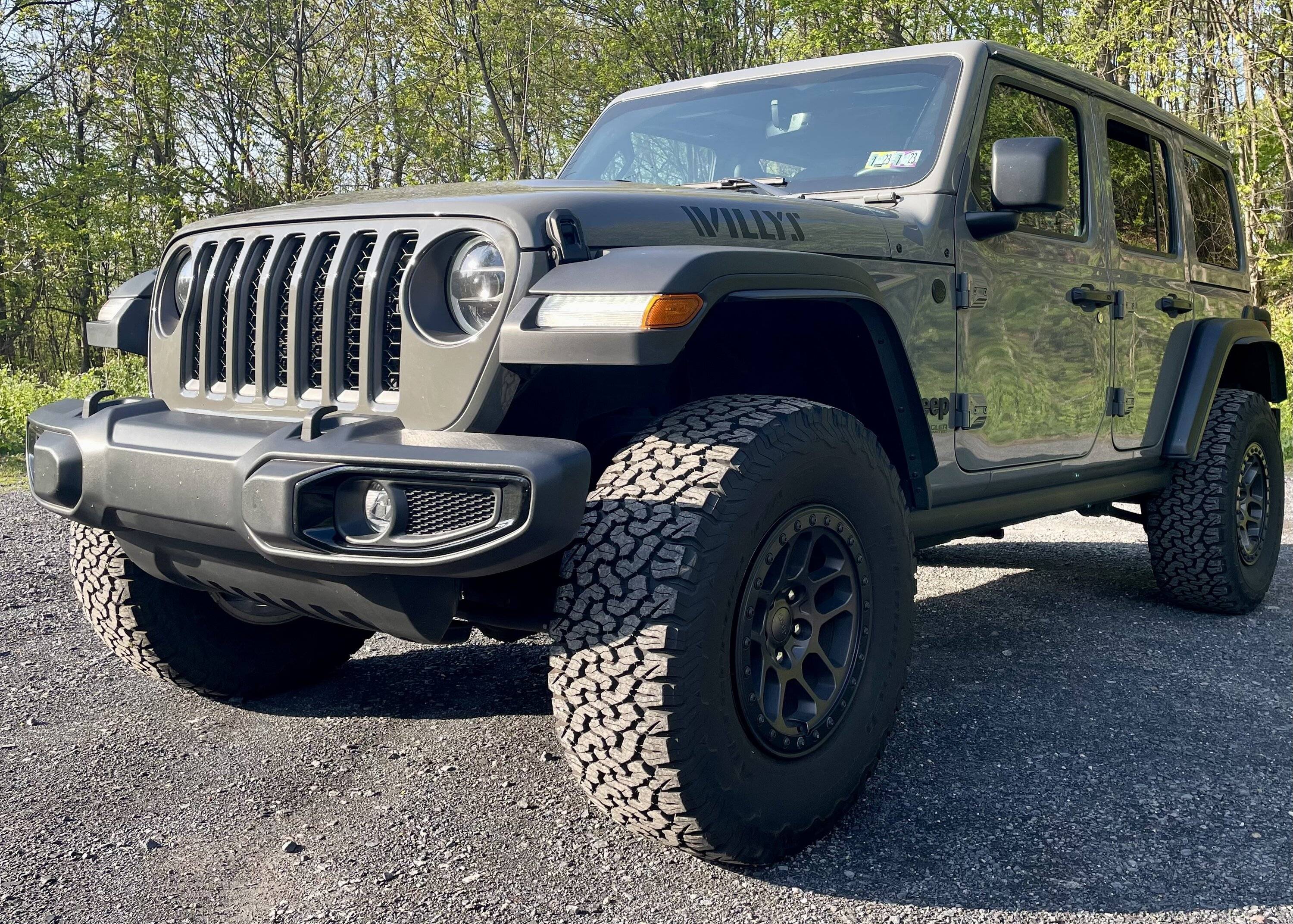

I read an article about how the engineers at FCA were able to get the 7k tow capability in the Gladiator. They had to open the grill grates by making the slots slightly wider and the grate "screen" with larger openings. The basic grill panel is the same, but the slot inserts don't intrude as much into the slot. So all that is needed to go to the Gladiator grill setup, is the slot inserts and the grating/screen. They also increased the fan cfm capability. IIRC, the radiator stayed the same as the Wrangler. So, just the grill mod and replacing the fan with a Gladiator fan should get you a good improvement in cooling.
These mods should also help avoid some overheating issues reported about the power steering.
I haven't read anything about what the 392 grill, radiator or fan configuration differences are. But a 392 radiator is a different part number than my 3.6L and it's about $20 less than the Poison Spider louvers, when purchased from an online Mopar retailer.

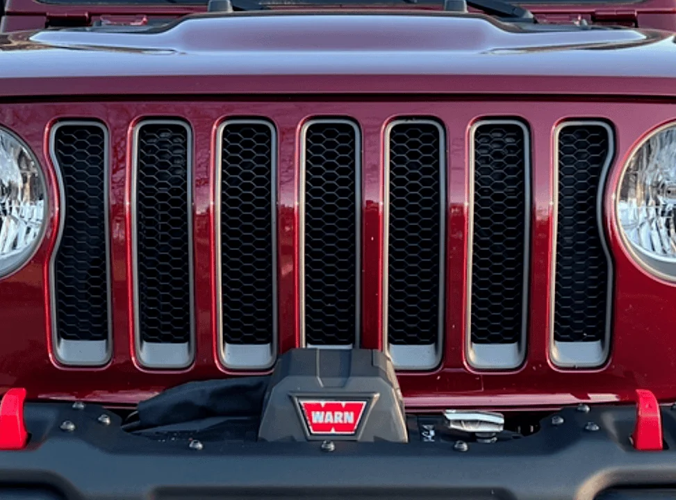

I have a Gladiator grill on my Jeep, but it was more for looks. I usually run at 195 temp but haven't done any rock climbing.

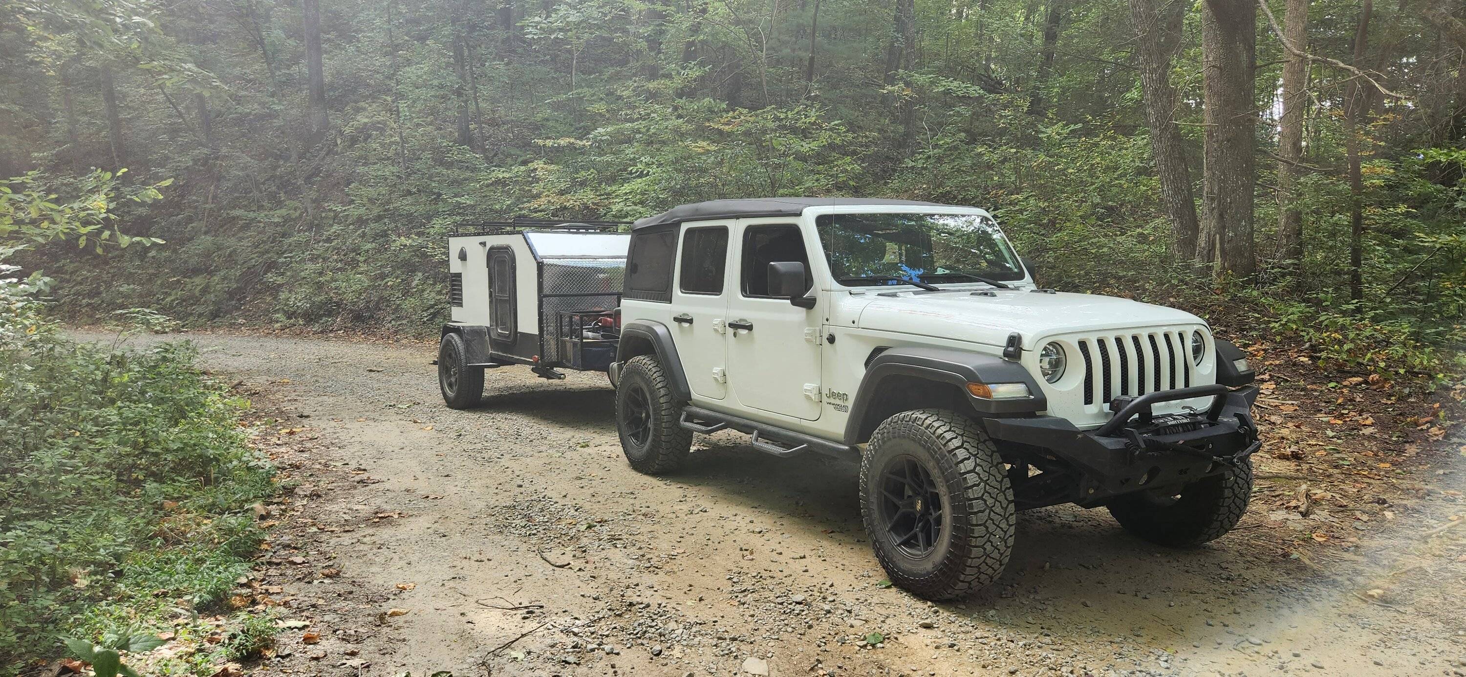

I tow a small camper (1360lbs)behind my Jeep, and it doesn’t like it too much. I have figured out as well as many, FCA needs to install a larger radiator and improve airflow.
I removed the honeycomb from my grill and that helped out a lot at interstate speeds. I may be installing the bigger radiator , and trans cooler.

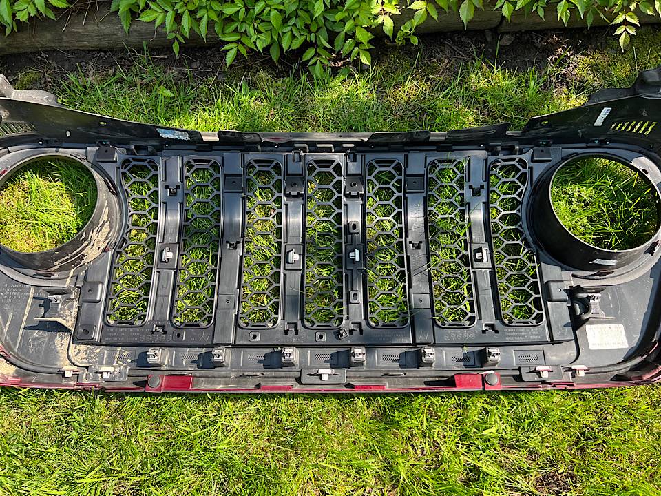

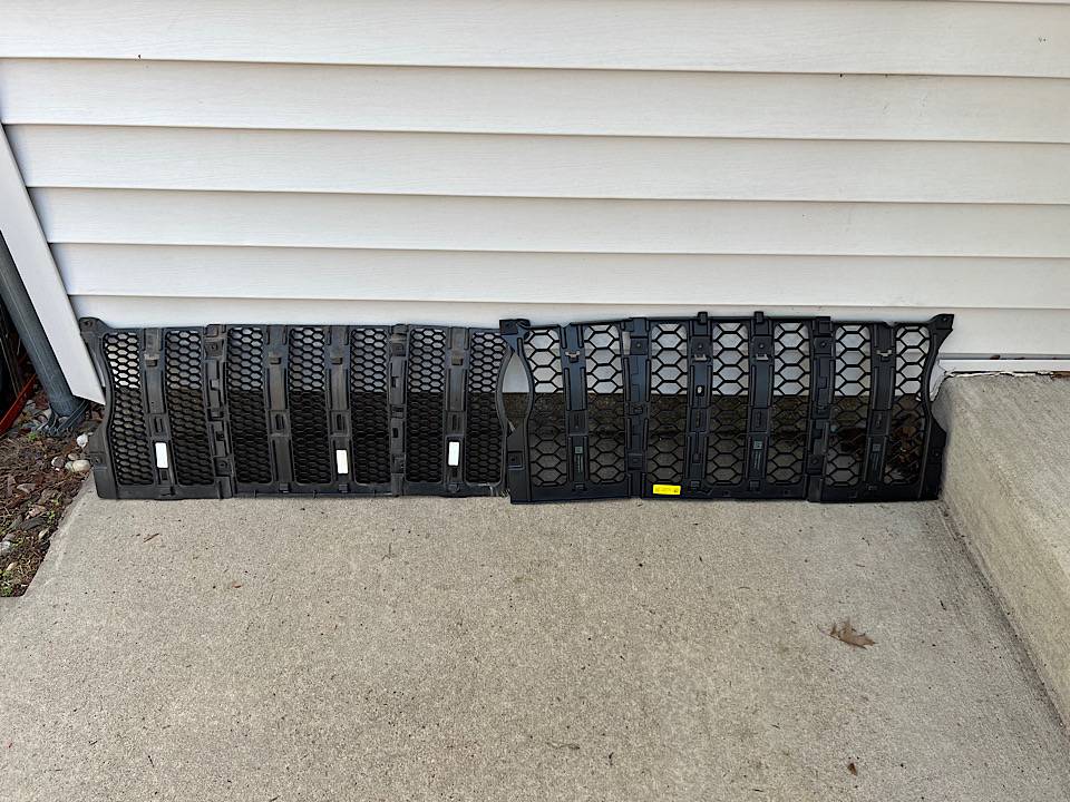

Swapped to the Gladiator inserts. The jet engine fan comes on a lot when wheeling. My hope is that this helps. The underhood heat is insane too with these 2.0s. I may consider modding the hood vents to be functional.
Two of the clips where different and unusable on the JT grille but there seems to be enough others and especially with the screws that it should be fine.

Stock small honeycomb grille:
